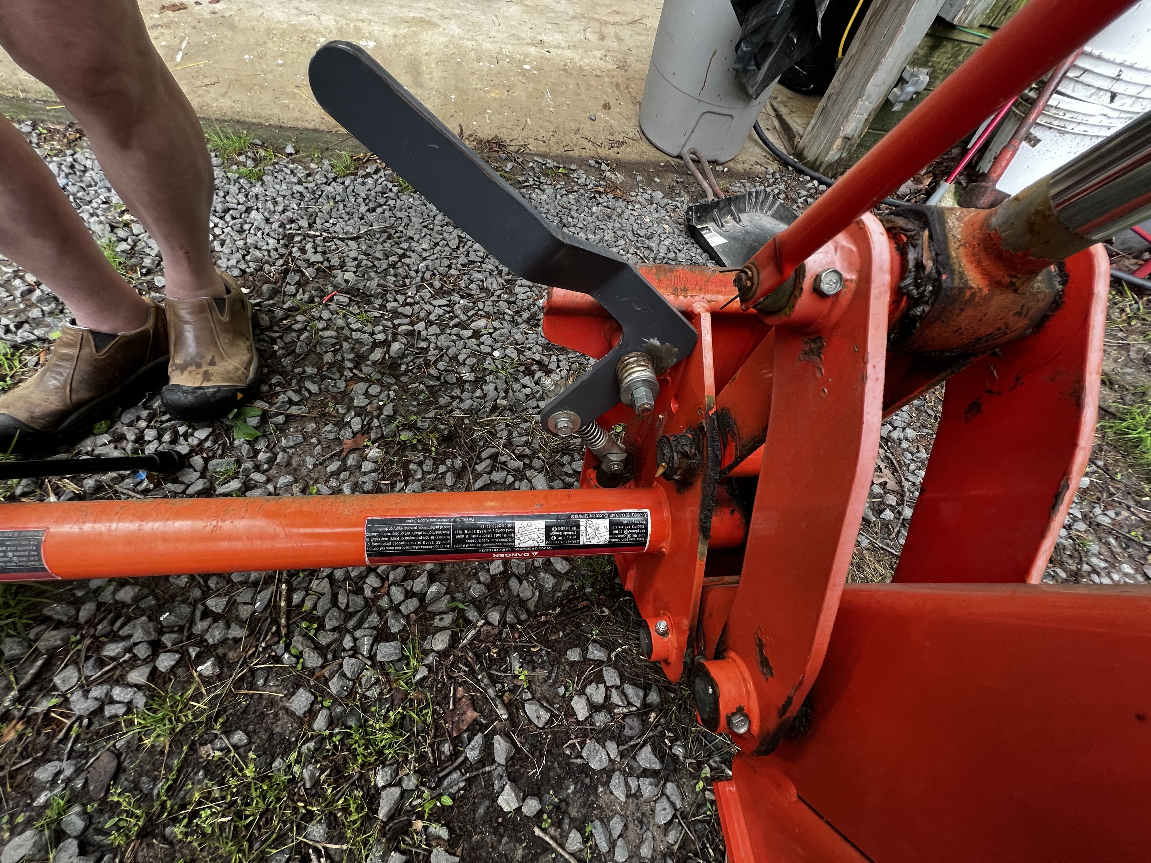

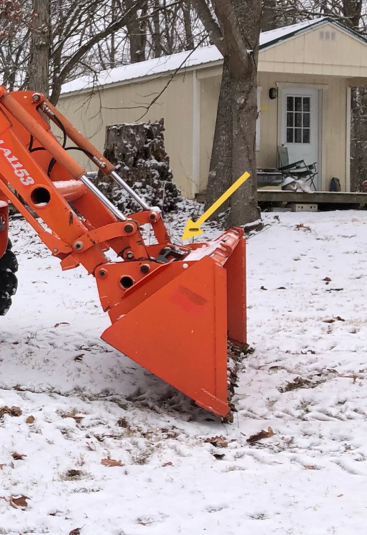

Hey guys / gals, don’t do what I did yesterday. While taking the bucket off my front loader, I did a stupid thing and the bucket fell from about 18” onto and pinned both feet.
There are two lock-down levers on my Kubota FEL. I had released one but the second one was stuck at about 90 percent released. So I got the hammer to give it a tap from underneath.
I was unable to swing the hammer from underside, so I raised the bucket off the ground about 18".
Still could not hit it correctly, so I curled the bucket forward (as in the pic) MISTAKE # 1.
Then I stood in front of the bucket so I could hit the lock-down dog. MISTAKE # 2.
Then using the hammer and reaching over and behind the bucket, I gently tapped the dog to free it - MISTAKE # 3.
That bucket fell so quickly! Right off the FEL hook up pads and onto my feet. Don’t do this!
I was working alone and the bucket was too heavy for this old man to lift to free my feet, so all I could do was pull my feet out one by one. Painful but I had no other recourse. It could have been much worse but luckily my feet are still intact. Sore as heck, and swollen, but no broken bones.
Hopefully, this cautionary tale of my stupidity will spare someone else.

Those handles can get stiff. I have a 12" pipe for when one is tight. Then I look at why it is sticking. Sometimes there is q nick, or it needs adjustment.
It's easy to slip up. Just don't let it happen again!!
Your warning may make someone else think twice. Thanks

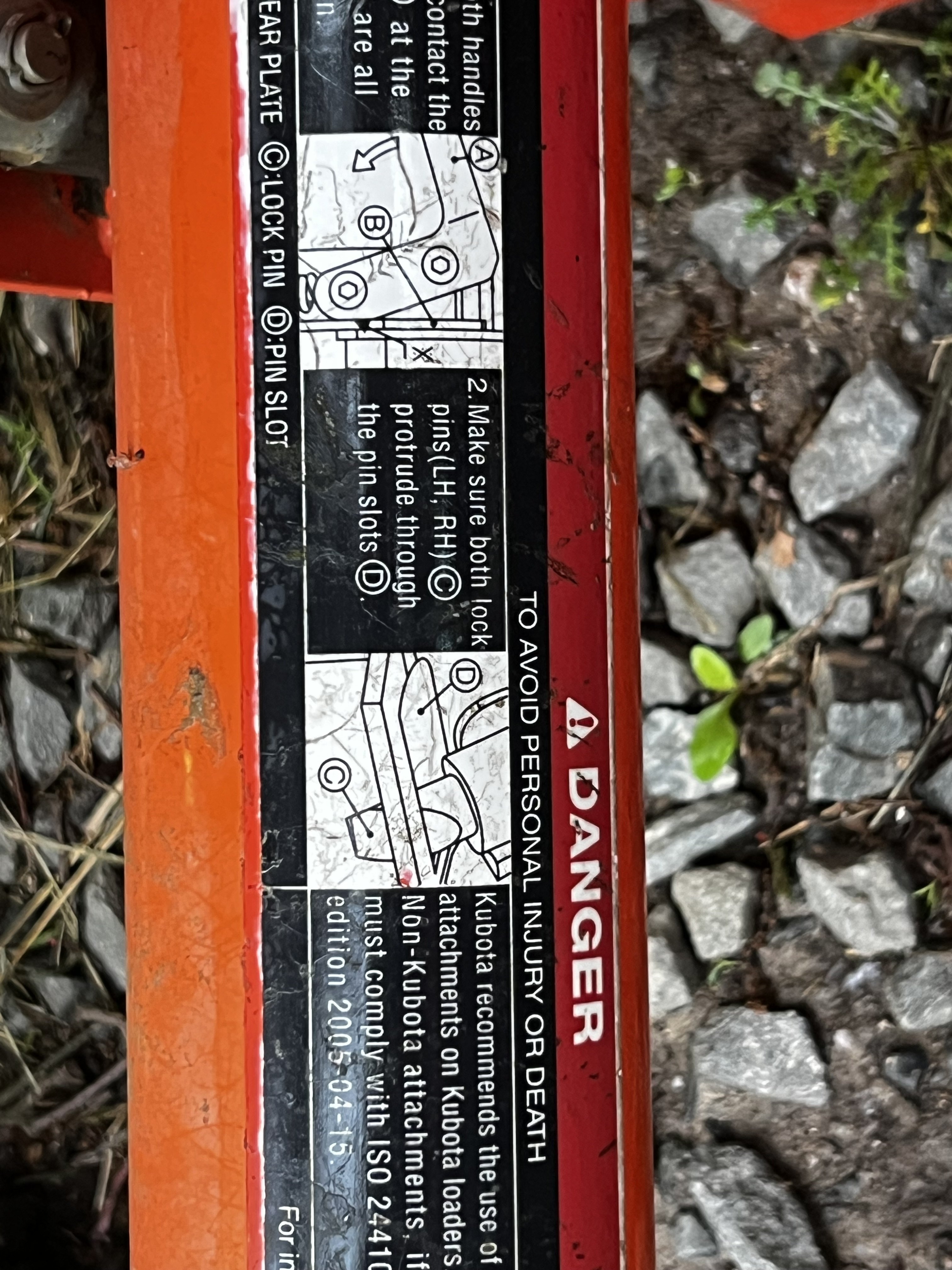

I hobbled out this morning to take a few photos and “lo and behold” found a Danger label regard how to correctly release the implement.
I reached right across this label without looking at it. :p
Familiarity breeds complacency and complacency with farm machinery can get you hurt!

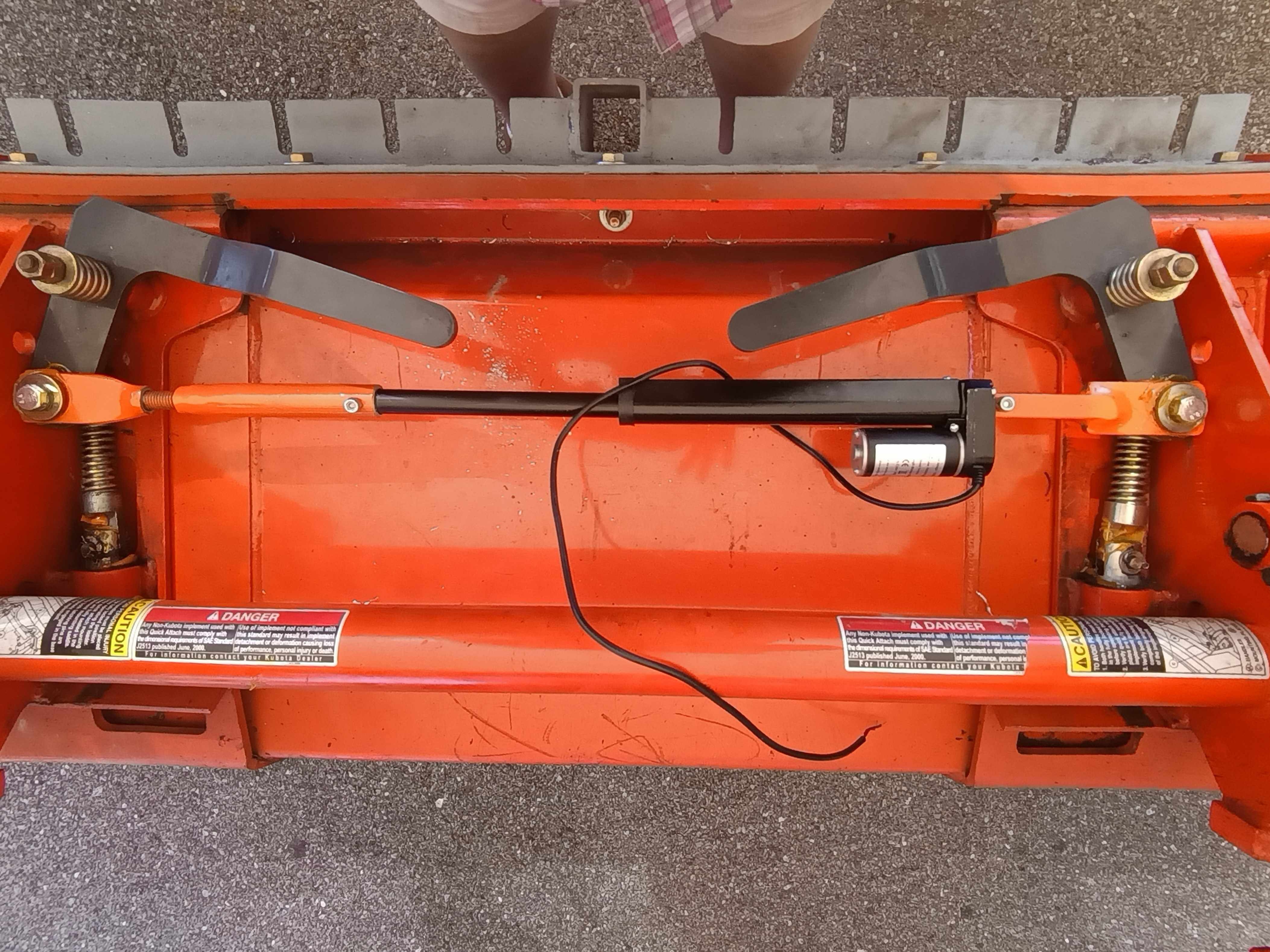

Currently, feet are in the cab when installing or removing QA stuff. Picture was taken after final fitup and trial run (and before wiring had been completed).
Before that, I'd keep the bucket (or forks, or whatever) slightly curled just off the ground. Then I'd stand in the bucket while operating the latches. Until the bucket is dumped past the point that gravity "removes" it, she'll hang on the pads just fine.
That's a pretty clever design, what parts did you need and about how much were they?
/ Universal Quick Attach Bucket Dropped on Both Feet #17
The 12V linear actuator with 8" stroke is from Amazon. I think full stroke takes 20 seconds. I'll check for more information on it. They're available in different strengths and it does take some oomph at parts of the stroke. The picture shows the original actuator. The original seemed marginal, so I replaced it before it had a chance to fail. The rest was fabricobbled from scrap stuff I have except for a couple nuts and bushings.
Edit: Checked the actuator today. Of course the tag was on the back side so I had to pull it off to see it. It's a 6000N like this:
Actuator
It took some measuring and figuring where to locate the ends of the actuator to match the 8" travel of stroke and its built-in limit switches. After agonizing and measuring a lot on where the holes should be drilled, I discovered the distance between the existing bolts worked fine. No need to drill the QA handle after all. Here's the original writeup:
