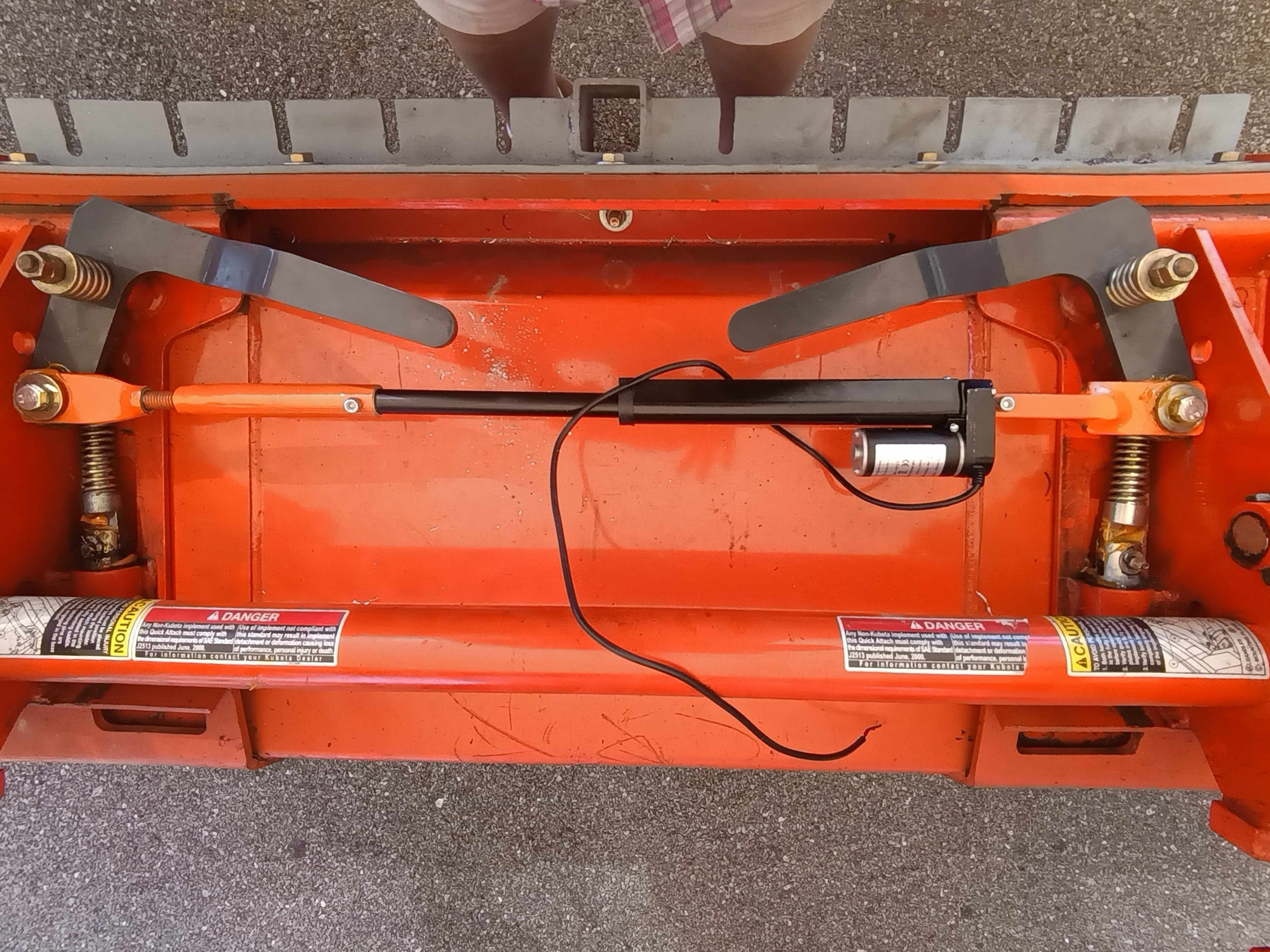

Nothing against the european design but this SSQA is not a problematic design! It is on millions of pieces of equipment and problems are very rare. If kept greased and operated with common sense (use a piece of pipe as a longer handle) problems are almost non existent.
"Problems are very rare" Far from it actually.
Being part of various forums and groups, it's almost a daily occurrence that someone posts about their twisted quick attach on their tractor because one side popped out. And this is doesn't even consider all the other people that don't post about it nor all the other equipment that uses the same system.
If it wasn't a problematic design, there wouldn't be all of those issues, or even the need to carry a pipe or hammer for when the thing just decides to not work.

The JDQA gets lots of hate, why I do not know. You just lift out two clips while standing behind and to the side of the bucket, put the bucket down and back out. Attaching the bucket is just the reverse. No need for cheater pipes or hammers, a five year old could do it.
   / Universal Quick Attach Bucket Dropped on Both Feet #24
The reason for malfunction is a nick or bent bucket.
The bucket gets a dent and that keeps the shoe from lying flat up against the bucket. That makes the pin tight.
Usually, you can hammer or grind the dent flat, and it will work fine again. When you hammer on the beveled end of the pin that also creates a sticking point.
The main issue I see is dented bucket keeping the shoe from laying perfectly flat against the back of the bucket It's easy to overlook.
I thought about welding a plate to the inside of the bucket that opposes where the shoe lays flat so it doesn't dent there. It wouldn't have to be very big.
Any designe that gets abuse will eventually have problems.
Take a good look at why its sticking before or after needing to use a hammer!
Sometimes its mud and rocks jammed in there.

The QR on my NH bucket became very stiff to operate over time. Upon closer examination I found grease fittings to lubricate the pins. That and a little spray lube, what a difference! I did have my pallet forks come close to falling off once so I can understand the danger!

On the JDQA the lower part of the base just has two 1 inch holes, the upper part casting where the bucket cylinders attach is a rounded bar. The bucket has curved hooks facing back those bars fit into, the lower part of the bucket has two pins sticking straight back. You pull up to the bucket with the cylinders extended and the bars fit snugly in the hooks, lift and curl the bucket back and the pins slide into the holes and then all you do is put the lynch pins into the small holes in the bucket pins.
   / Universal Quick Attach Bucket Dropped on Both Feet #32
The JD design is far superior to the skidsteer quick attach for low lift capacity loaders. It keeps the bucket in close to the lift pins, saving the limited lift capacity. However it has some design limitations as well. When back dragging the weight is on two small pins that have holes drilled in them. The limited capacity and low traction force of the tractor generally prevent damage, however a stronger tractor could cause the mounting pin to break. Also wear in the mounting pin can degrade its strength and can break if enough use is put on it. Replacement is cutting and welding a new one on.
The skidsteer quick attach is a much more durable bucket attachment system. However it sacrifices some lift capacity due to the minimum depth of the latches. On a small sub compact this reduction can be noticeable. The locking pins can break but it is easily replaced with basic hand tools.
Both have their place. But on mid sized compacts and larger I prefer the skidsteer quick attach.
