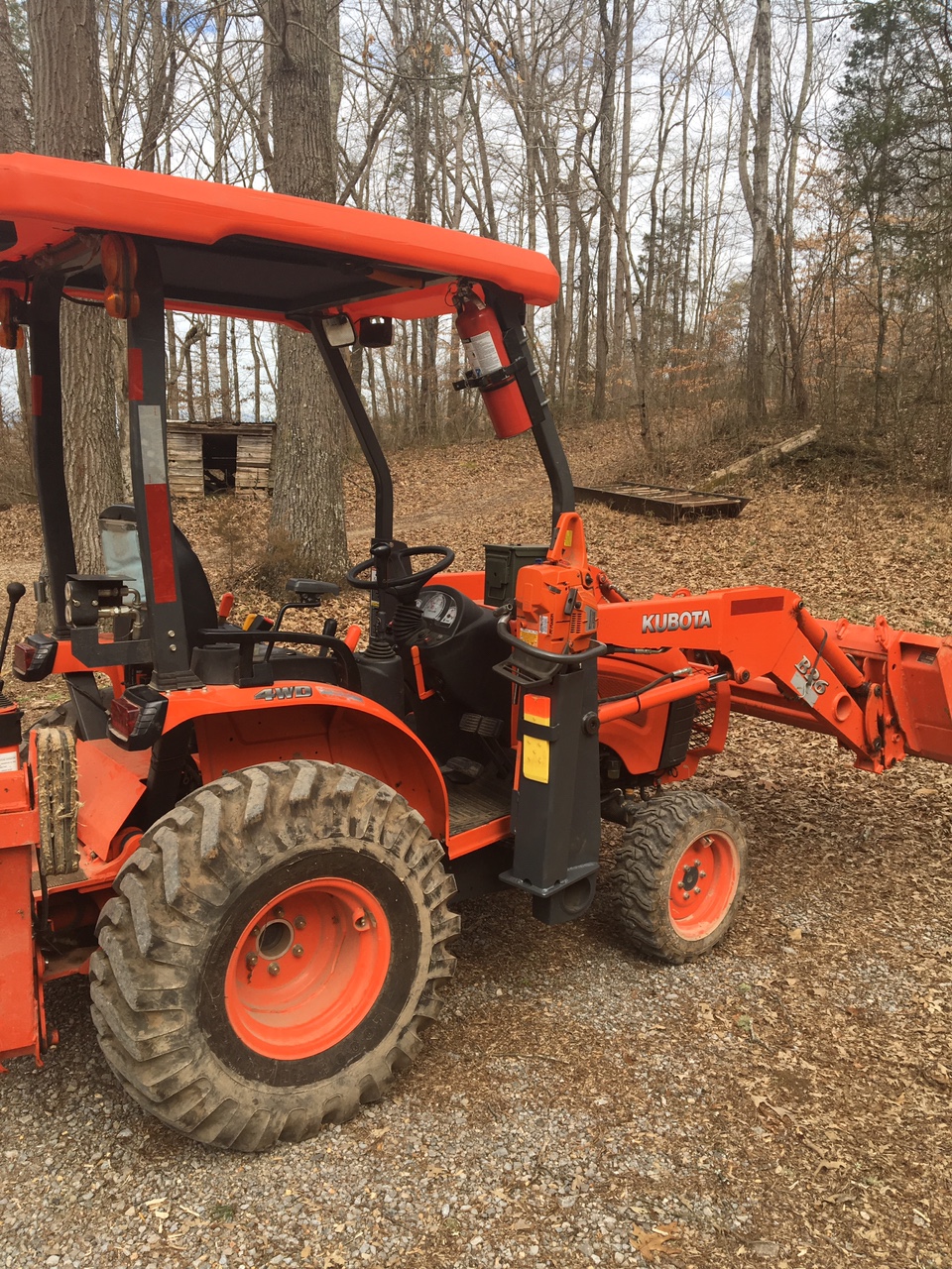

Here is mine. Mounted on the ROPS with my own bracket. I still maintained the ease of pulling the fire extinguisher fast. It just slides on a little hook on the top, while the bottom just have a strap that allow for the fire extinguisher to slide in.

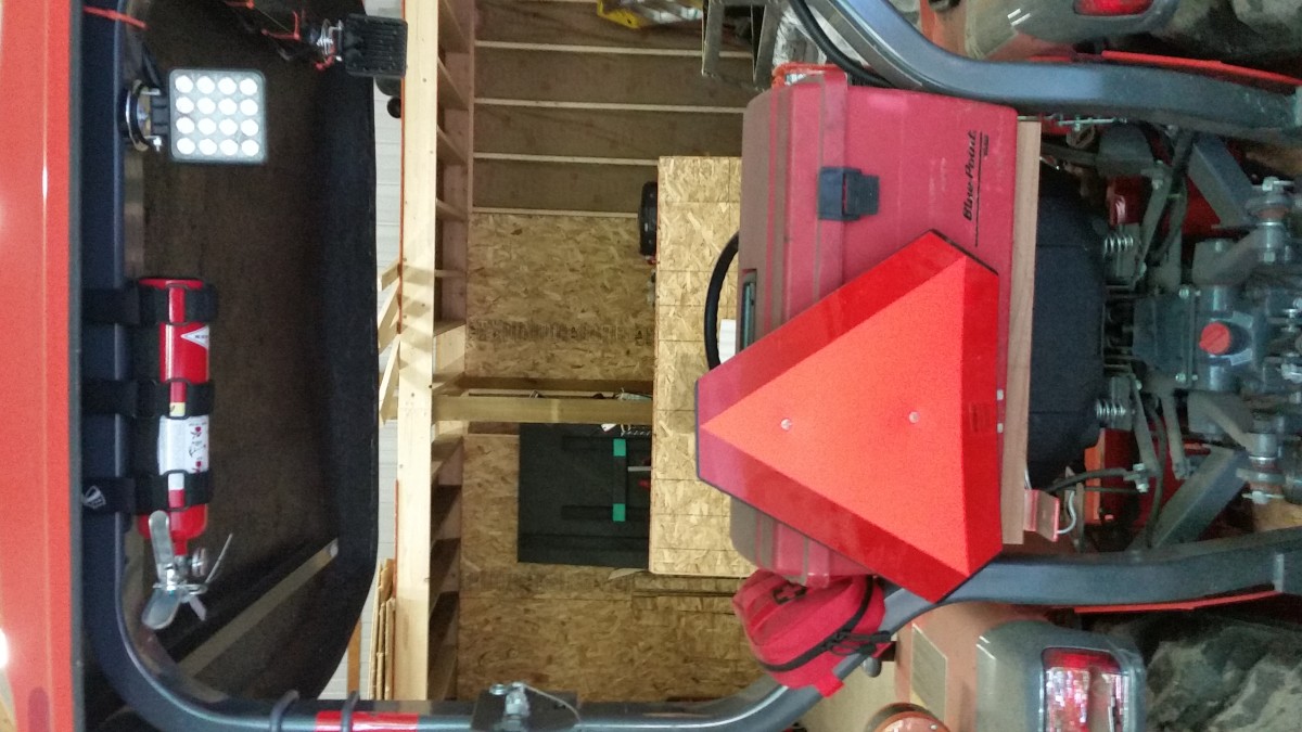

I too had difficulty finding the best mount and ended up going with a nylon version that straps on. Has worked extremely well for me and was easy to remove from my old tractor to my new.
I would recommended that you wrap some Scotch tape or a bread tie through your safety pin so it doesn't get snagged by brush, or fall out due to vibration.

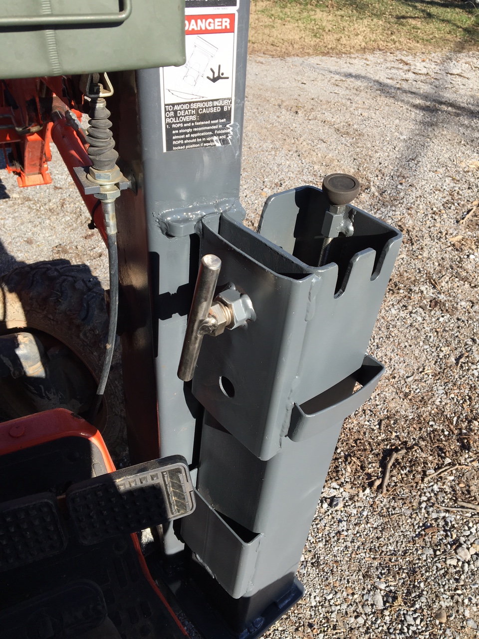

Scrap pile chainsaw, chain and tool holder. 5” square tube and 2x5” rectangle tube split. Bolt with spring for clamp. Doesn’t really need a clamp. Uses factory plastic blade guard which helps moving saw from shop, truck or worksite. Note adjustable rubber foot to add support for the saw. 1/2 plate on bottom. Welded to loader upright. Can safely carry chain, saw or tools on tractor.
/ Fire extinguisher #27
That looks good! Thx for sharing.
