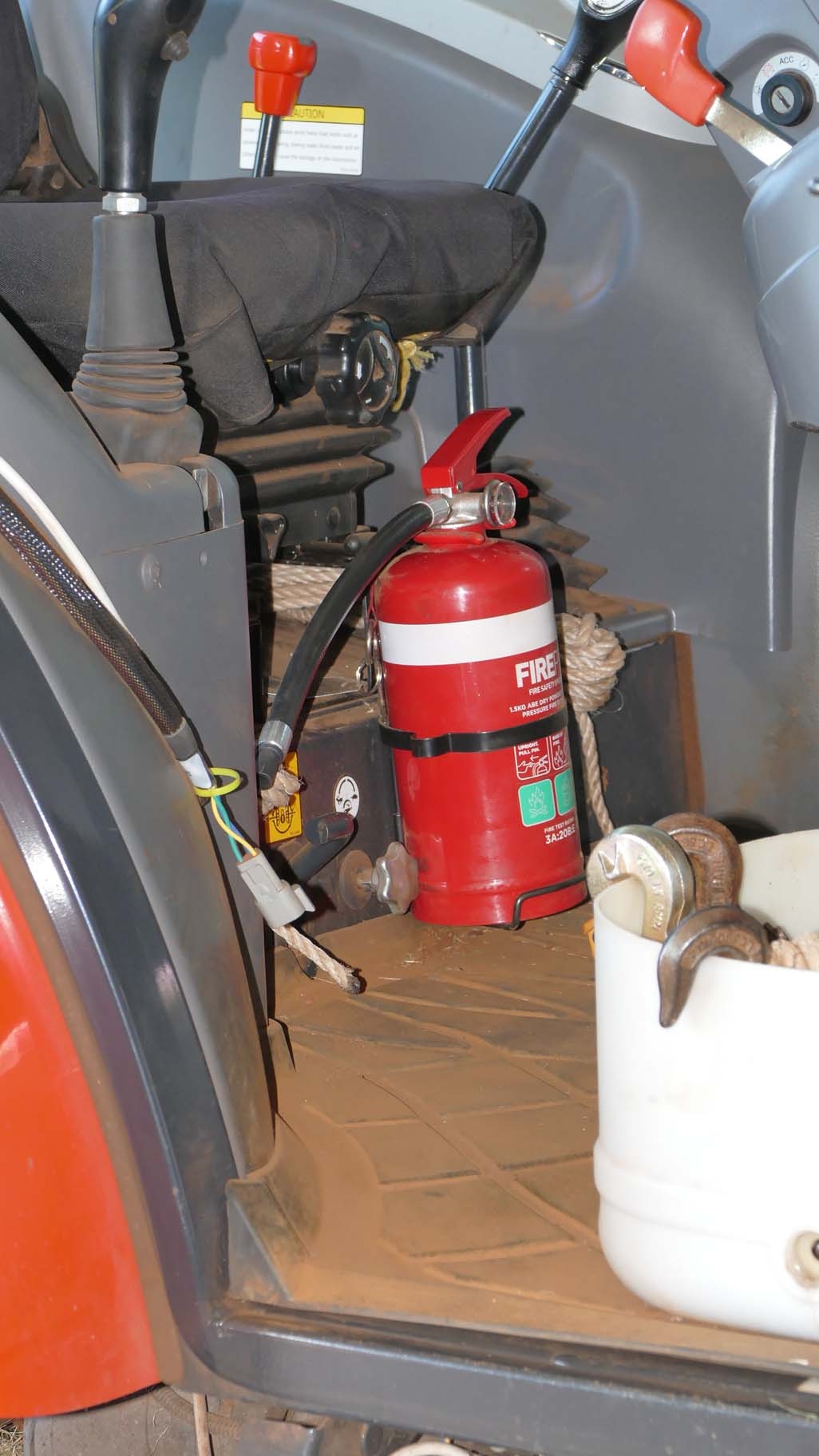

A 1.5kg (3.3 lbs) in about the easiest to reach/least inconvenient place I could think of. Accessible from either side door too. If the chain bucket weren't there, that would have been OK, but I didn't want to drill mounting holes in the cabin frame either. (And getting into and out of the cabin is a PITA from the right hand side. Too many things to stick into you. :oops:)
It's been an ornament so far - hope it stays that way!
