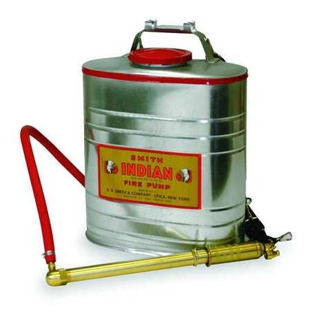

I had an Indian Pump mounted on one of my tractors long ago.
   / Show your fire extinguisher #24
I picking an Indian pump up a few years ago; sadly it needs all new seals.

When I was a teenager driving a grain harvester we carried 5 gallon water fire pumps. Brush fires were the biggest threat,

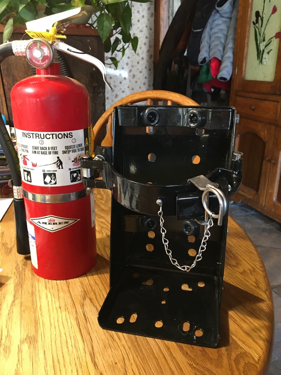

Having a good bracket to securely hold your fire extinguisher important. Open station tractors are particularly vulnerable to damage. These are easy to attach by U-bolts to the ROPS. A little rubber plug on the pull pins makes them rattle free.
Smokeydog, I sure like the bracket you show - where can I find one like that? I've only seen the flimsy ones that usually come with the extinguisher, and are next to impossible to mount to the tractor. I'd get a couple of those if I could find them! Thanks, Greg
   / Show your fire extinguisher #40
Amazon or eBay. Amazon prices can change quite a bit over time.
Been a rugged, rattle free way to carry fire extinguishers on the tractors.
Used three square U-bolts per mount and didn’t require any drilling.
