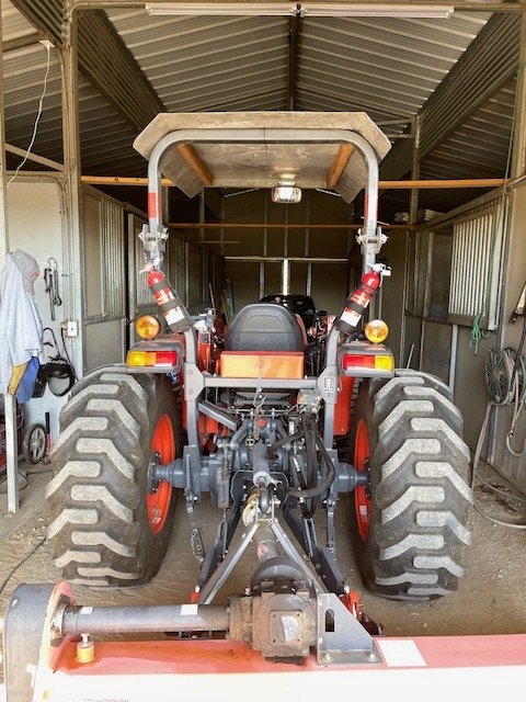

ABC extinguishers on my mowing rig - 2 because if you need 1 you might need 2 and what if 1 fails? View attachment 873214
I learned the hard way the small extinguishers don’t last long. 6-8 seconds? I now have more handy and a couple of larger ones.

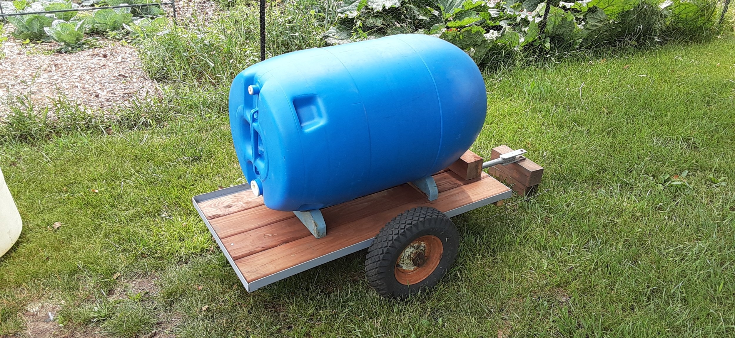

I would like to get a mount for one of my big water extinguishers for my Toolcat. I'm not sure where I could mount it though.
Tow it?
Real good example scootr! I tried to enlarge to see the mounts better but no luck. Can you explain what type of mount that is and where you got it please? I'd like to copy your idea cause it'll make me feel safer out in the field. It "looks" like a fitted holster style with "perhaps" Velcro straps? I'm probably way off base but that's a holder I'd like to find. Thanks, Greg

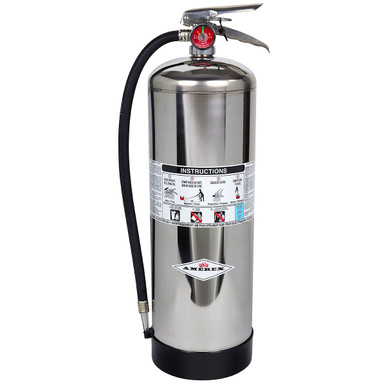

/ Fire Extinguisher for the Tractor #12
These are not good for oil fires, but they are my go-to extinguisher to use with burn piles. I have 4 of them, and always have at least 2 near a burn pile. I'll drag out all 4 if its a good size burn. I really like these.
You can recharge them yourself. After you use it, replenish the water, pressurize to 100psi using your air compressor. Ready to go!
They are really handy for putting the embers "dead out." Since you can recharge them easily, just blast away until they are exhausted.
Those are nice extinguishers. I keep one in my house, and in my previous life have knocked down several "room & contents" fires with a can.
