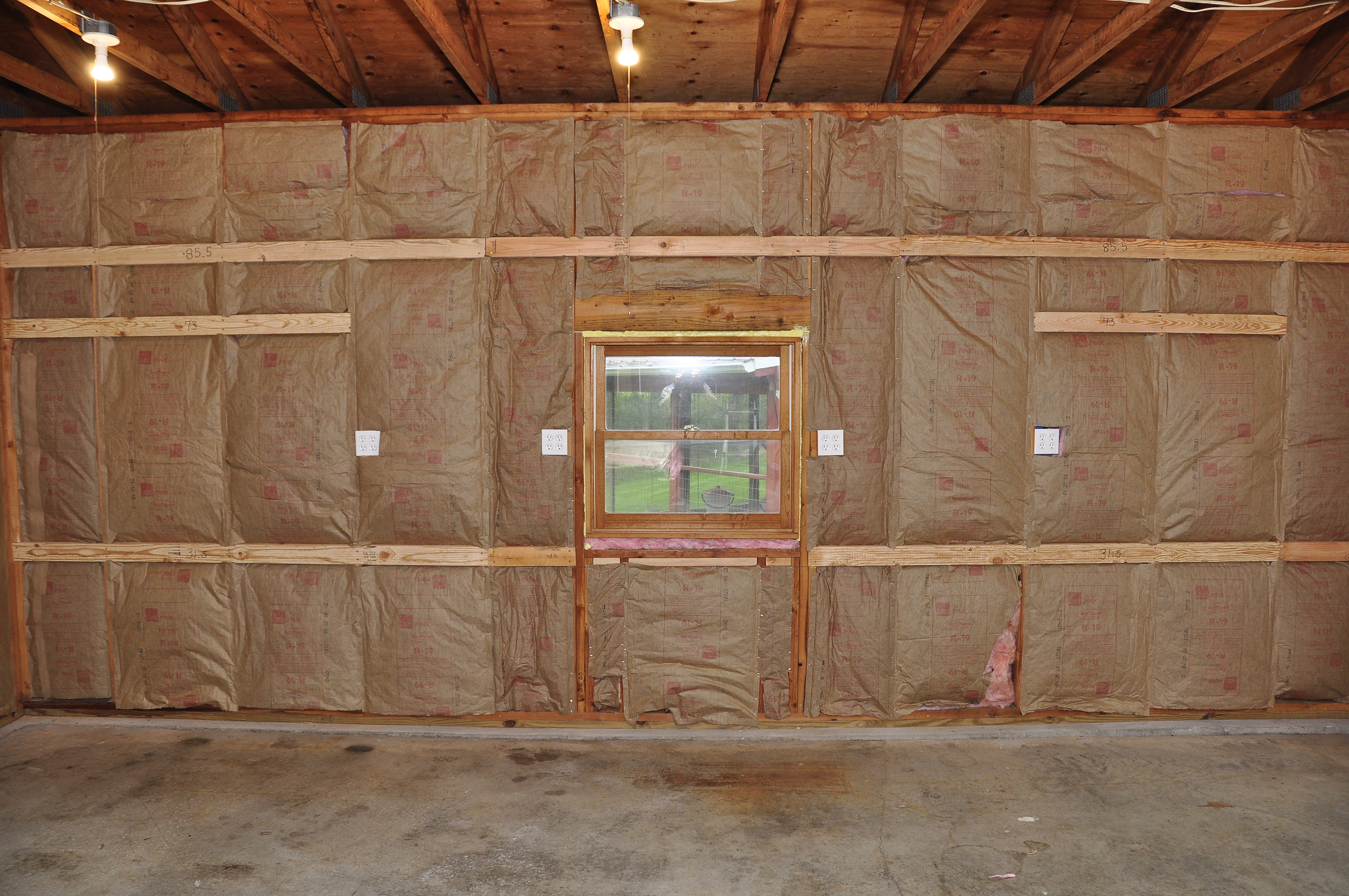

Eddie, I wired up the plugs because I wanted to test everything before the sheet rock goes up and hides everything. Face plates were added so I could make sure the plugs were centered before I tightened the outlets down. Obviously I will take the plates off before I add the sheet rock. But it gives me a sense of accomplishment when I can check electrical off my list! Plus I now have 16 plugs to use during construction!

Get those plates to protect the wires going thru the studs.
Thanks Murph. Just added the nail plates to my shopping list.

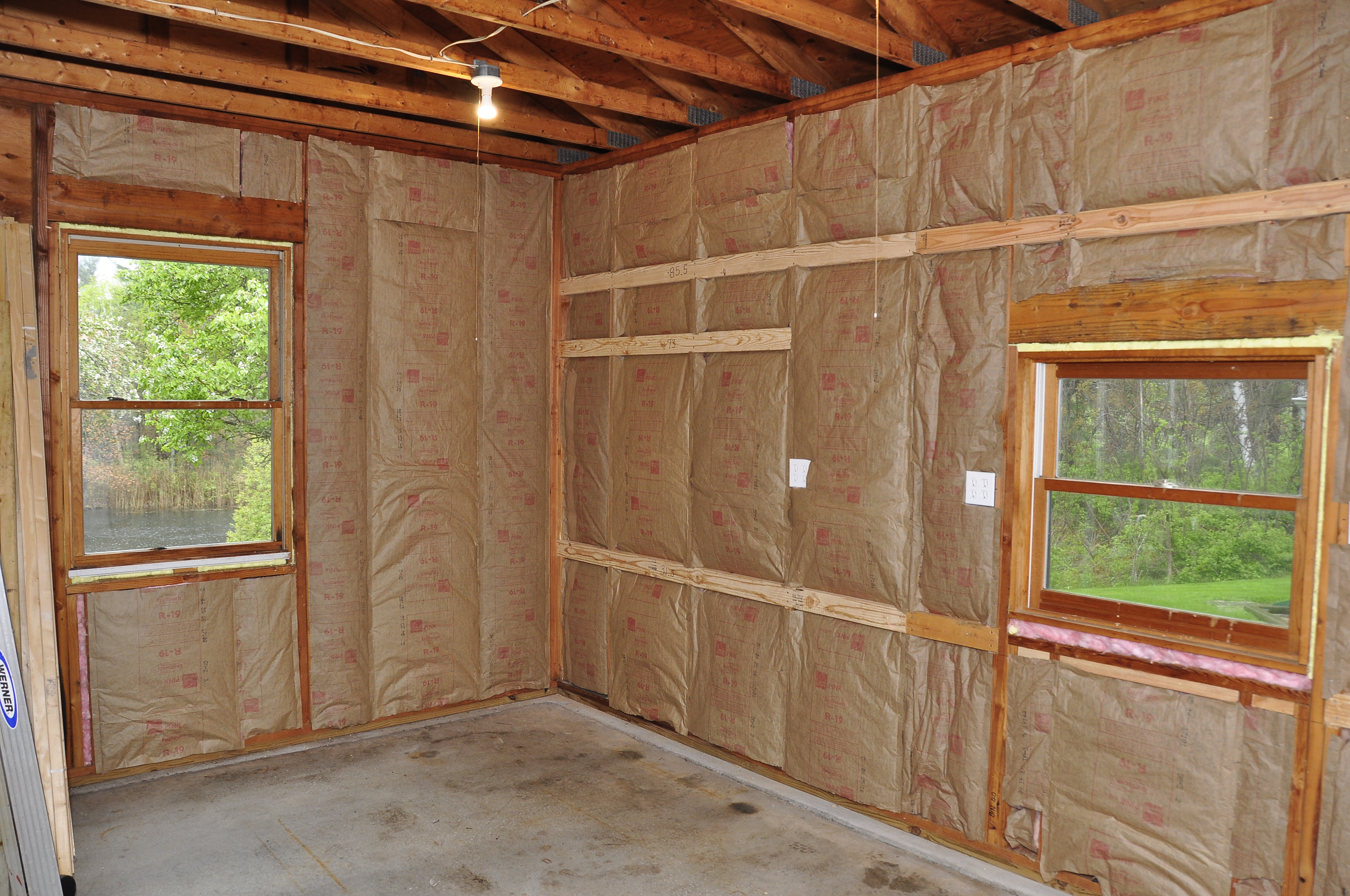

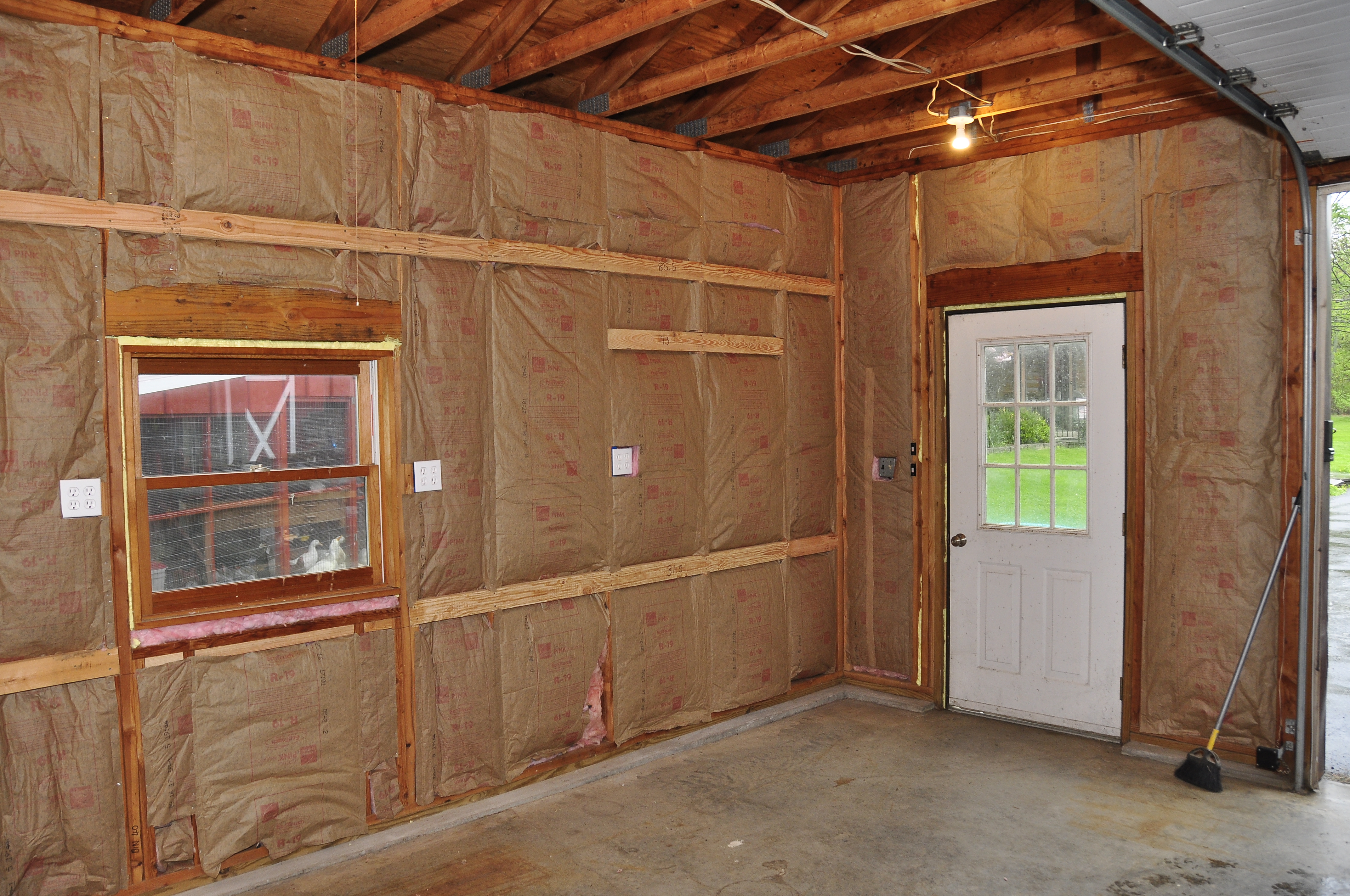

Finally had some time to spend on the shop. Added the nail plates over the wires and put in all the insulation. Ready to begin the sheet rock.

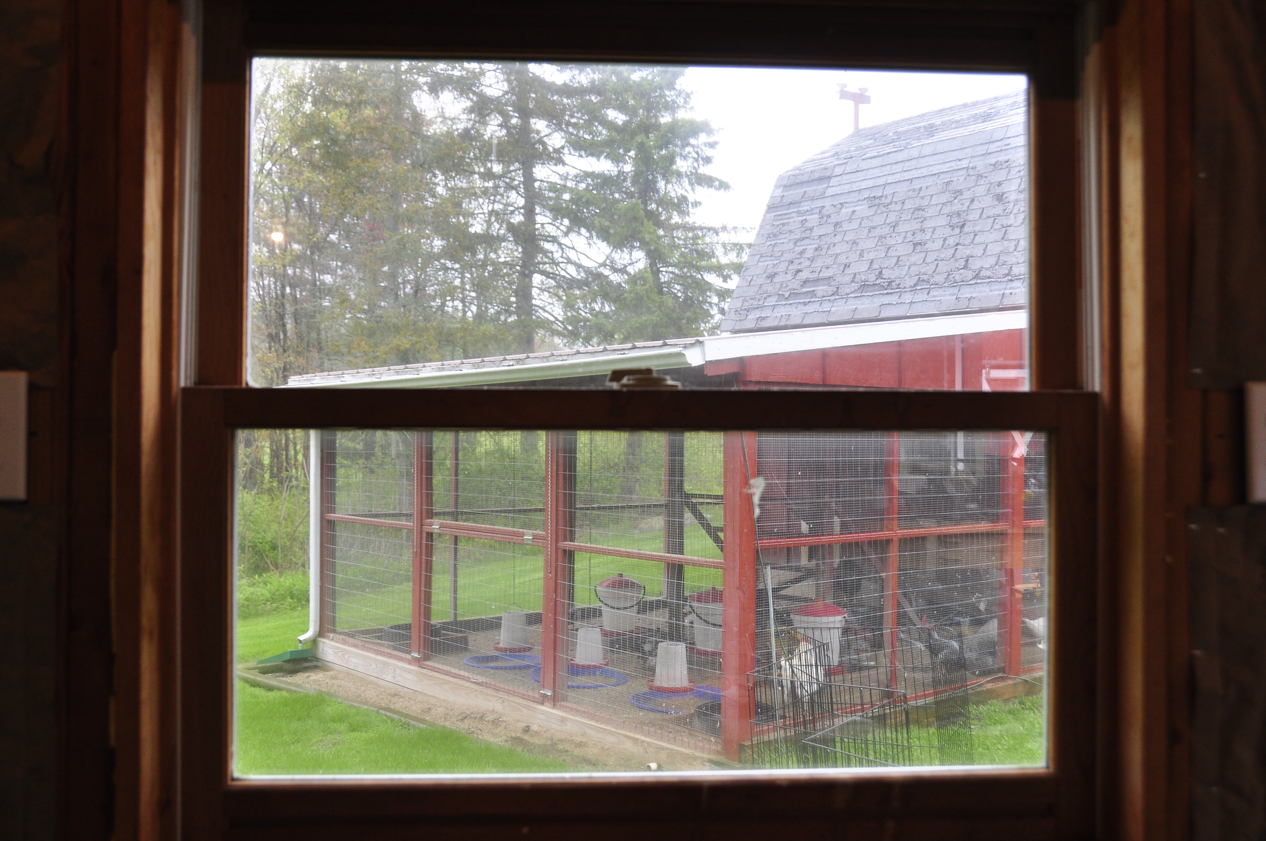

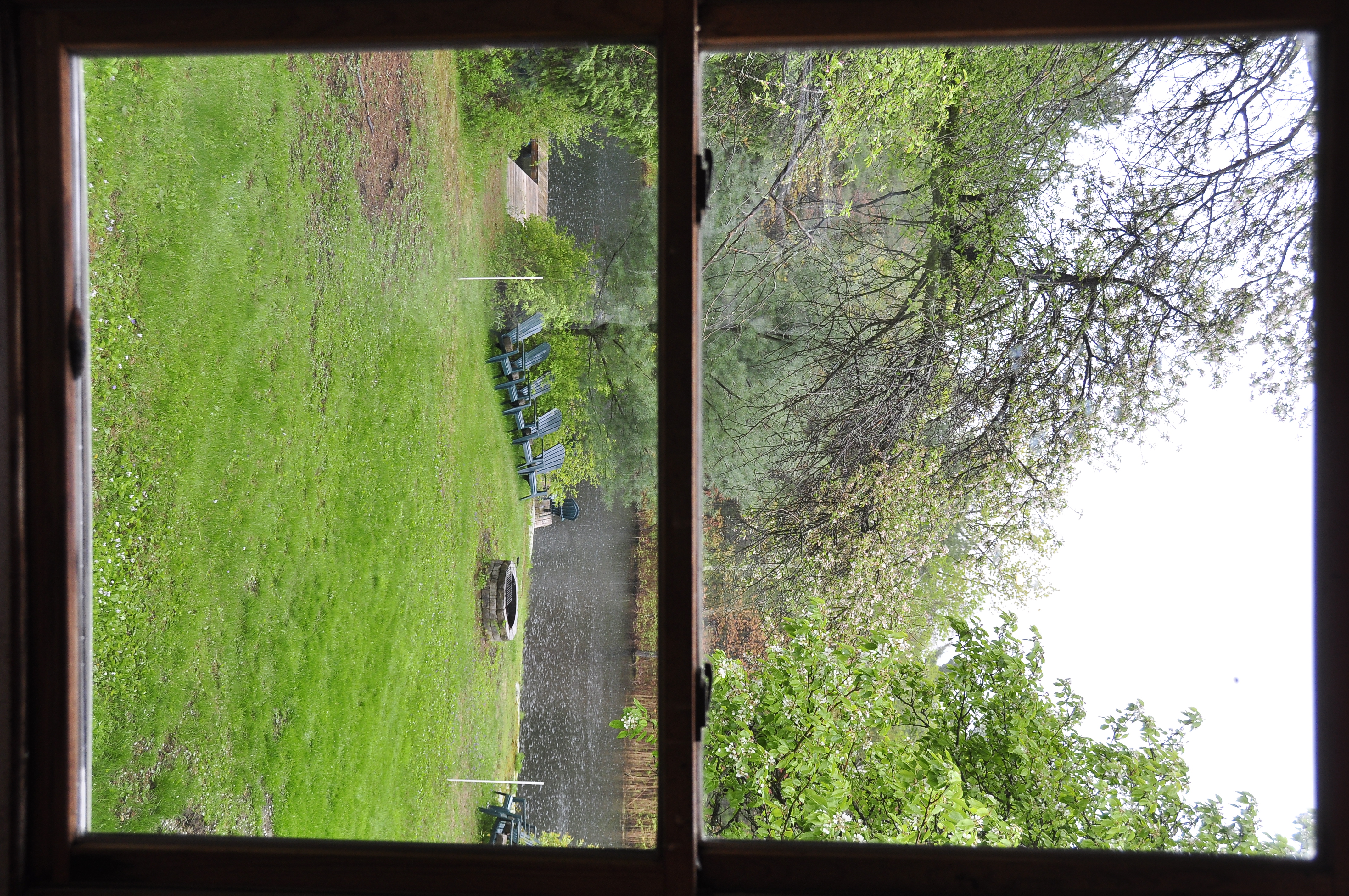

Here's the view from the 2 shop windows - some of the best views of any window on the property! The back window looks out over the firepit and pond, and the side window gives me a view of my chicken coop.

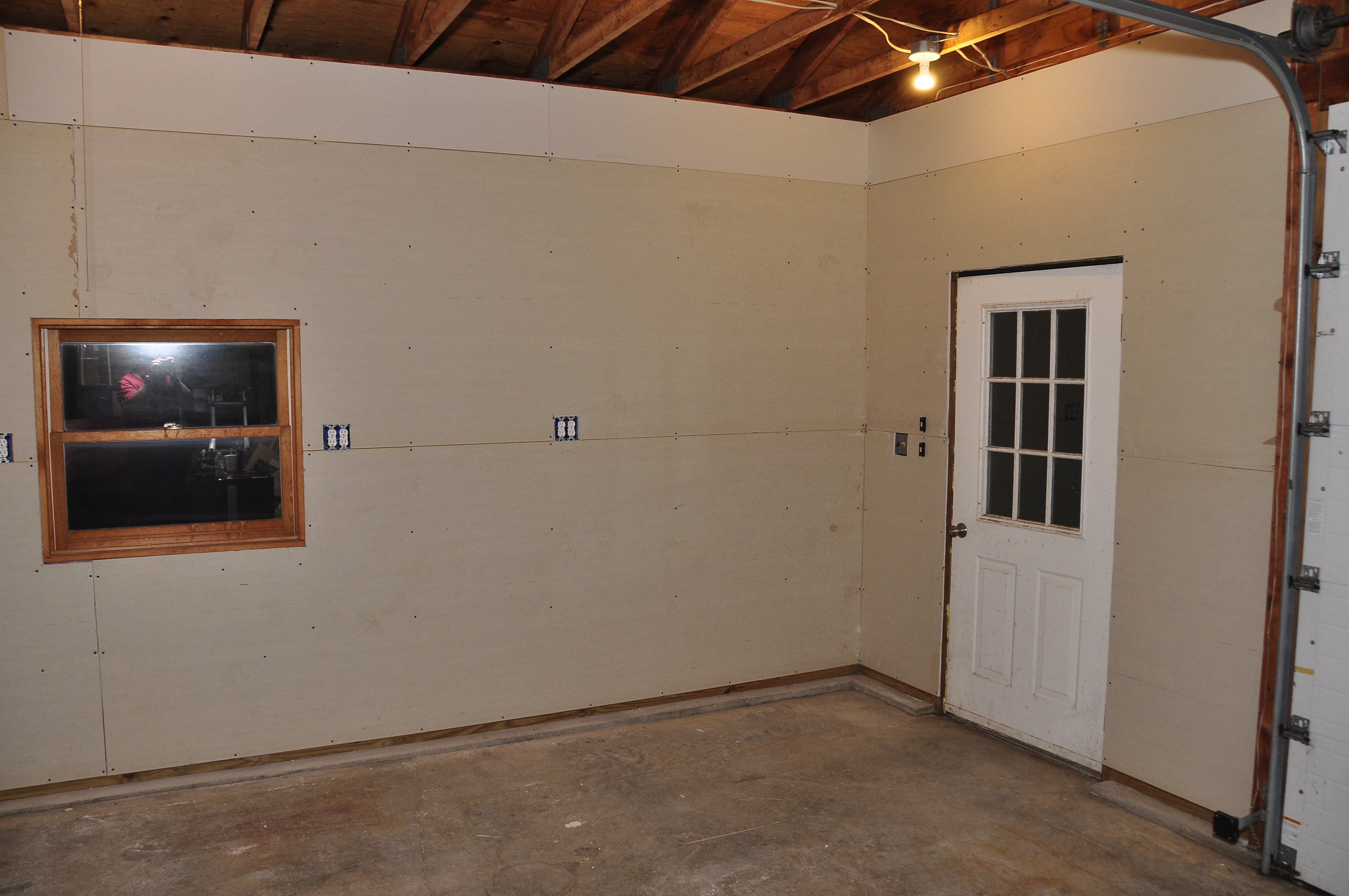

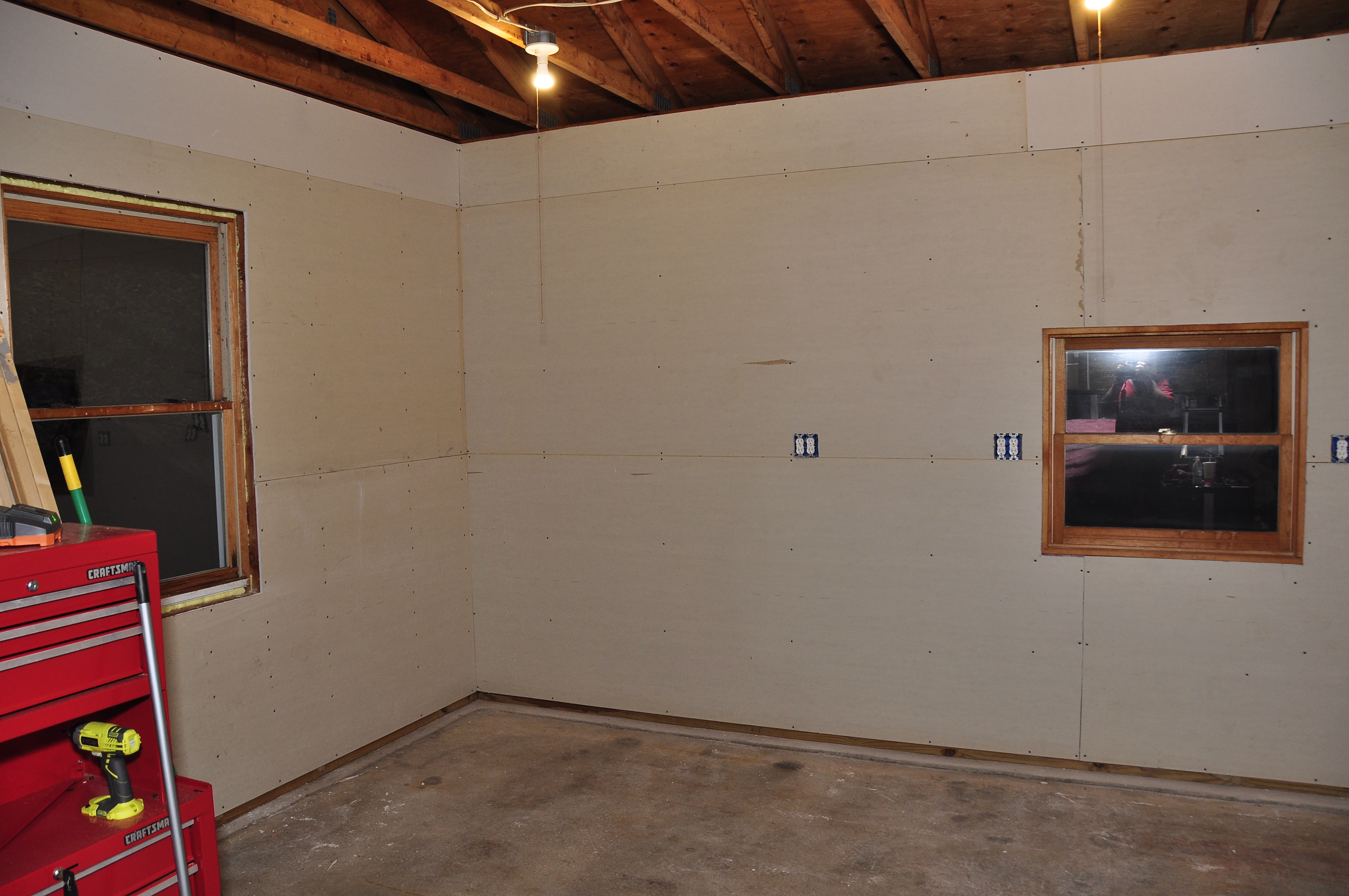

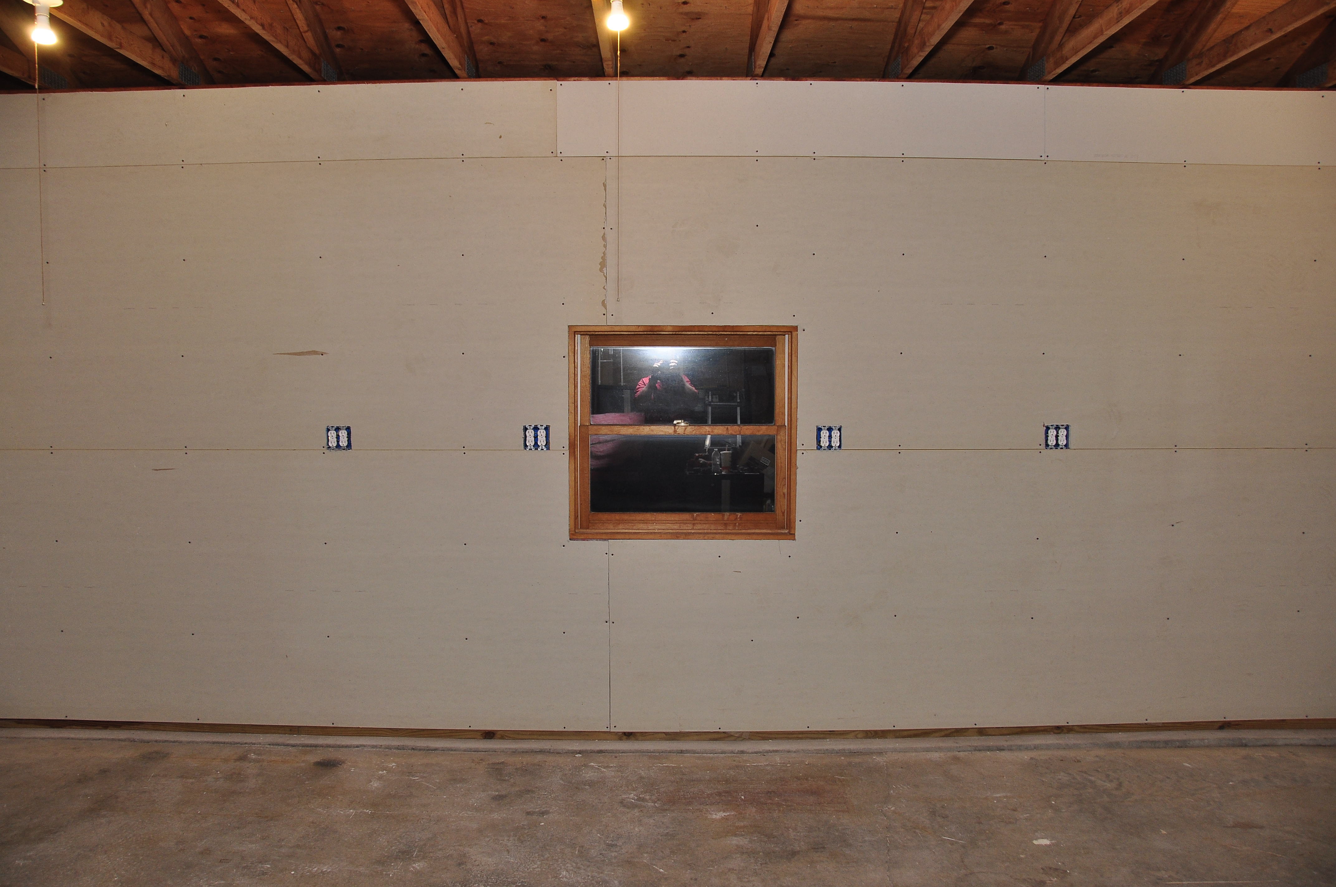

Sheetrock is up, and I am starting to mud the screws and seams. Also have to build sill extensions on the rear window and the door. Getting closer to having shop!
Eddie, in preparation for someday finishing the ceiling, I left a 5/8 inch gap at the very top of the walls so I can slip in the sheetrock so it is resting on the walls.
