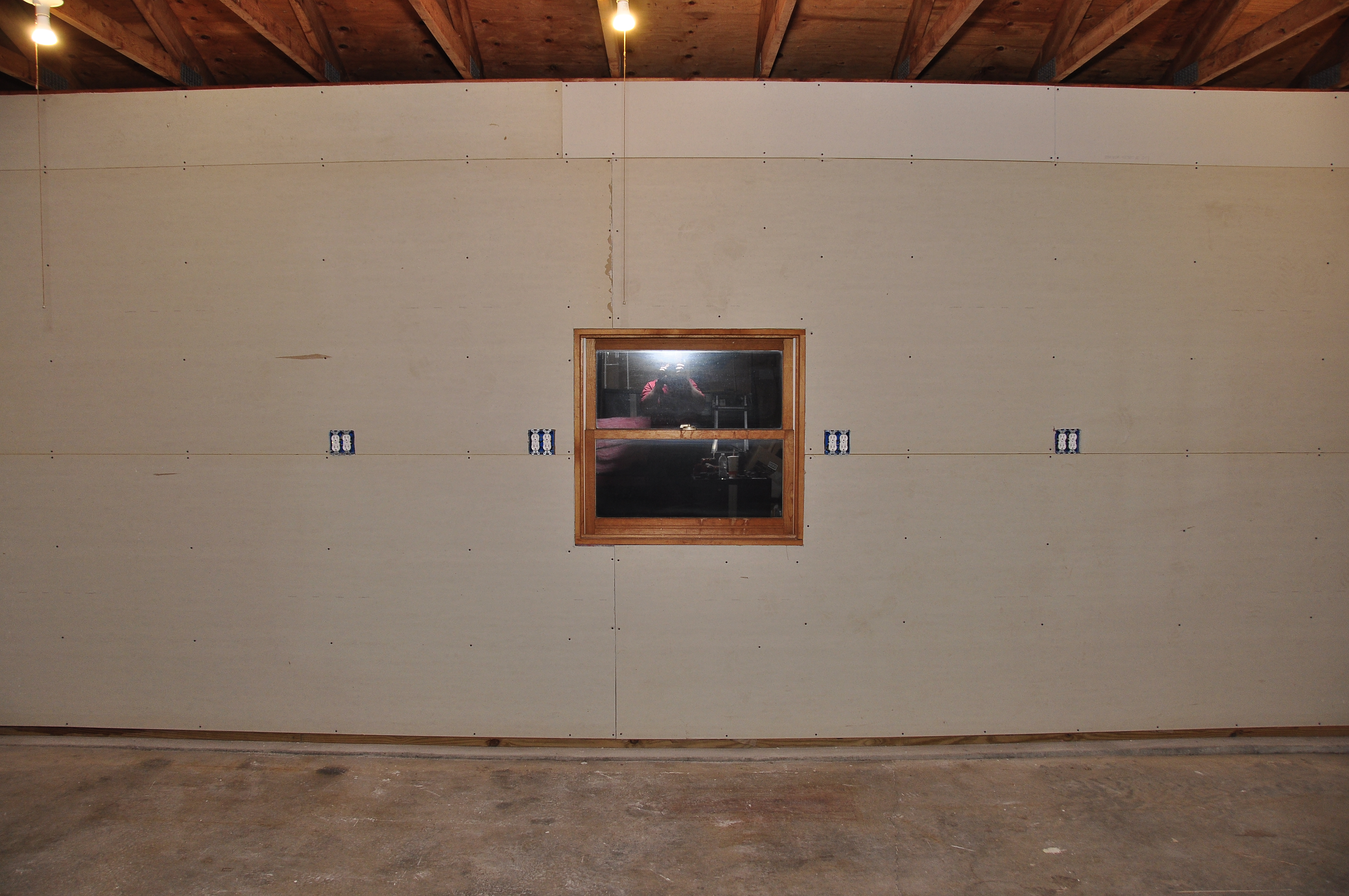

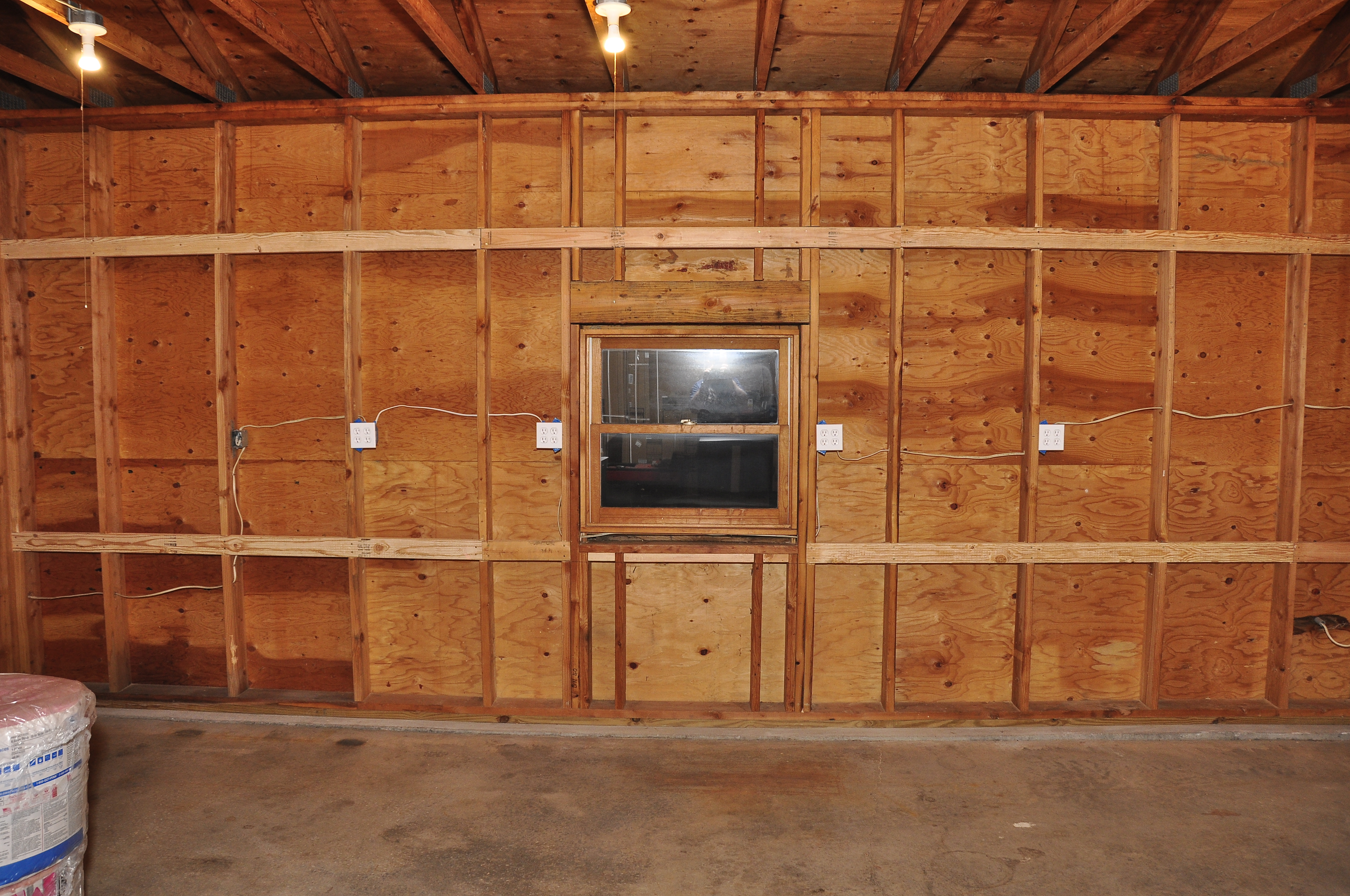

Eddie, I wired up the plugs because I wanted to test everything before the sheet rock goes up and hides everything. Face plates were added so I could make sure the plugs were centered before I tightened the outlets down. Obviously I will take the plates off before I add the sheet rock. But it gives me a sense of accomplishment when I can check electrical off my list! Plus I now have 16 plugs to use during construction!

Get those plates to protect the wires going thru the studs.
Thanks Murph. Just added the nail plates to my shopping list.

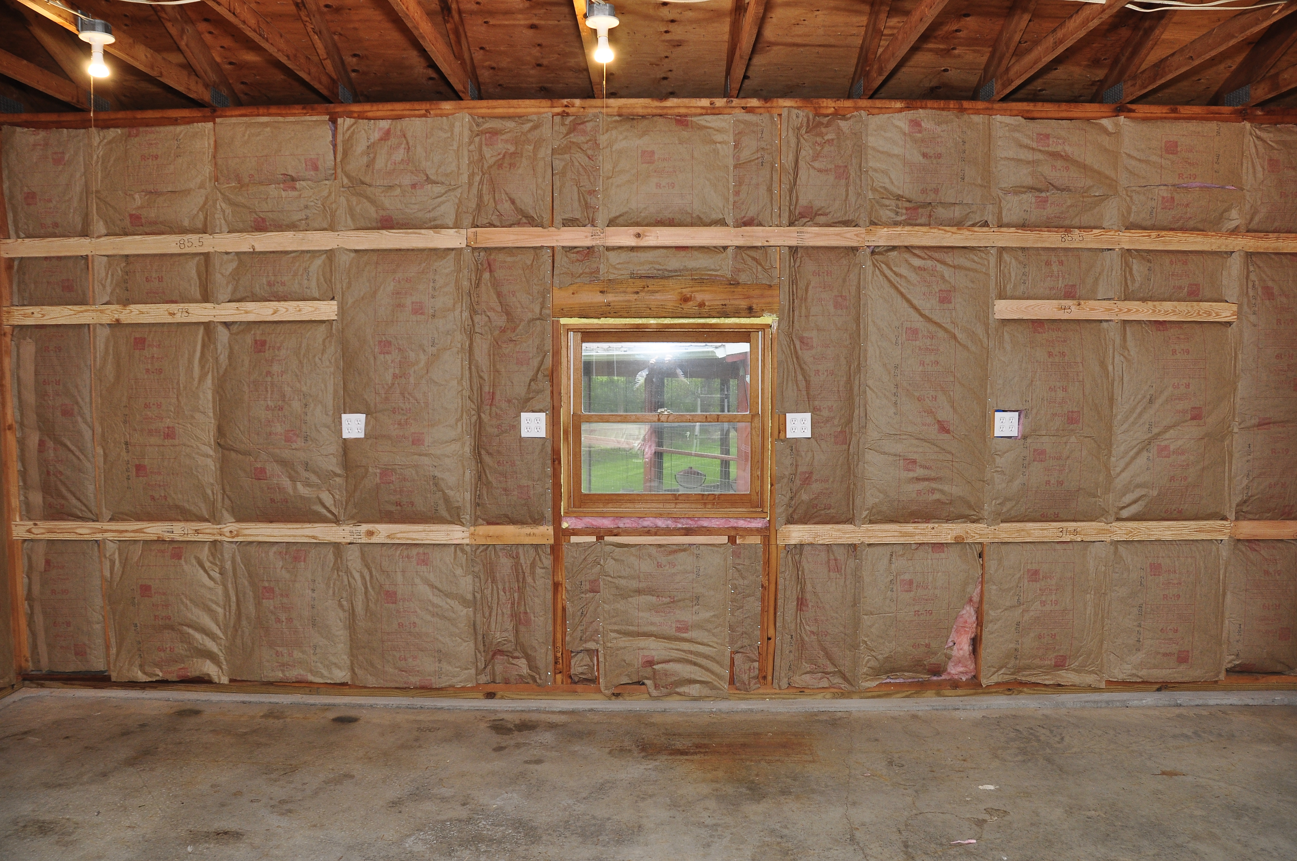

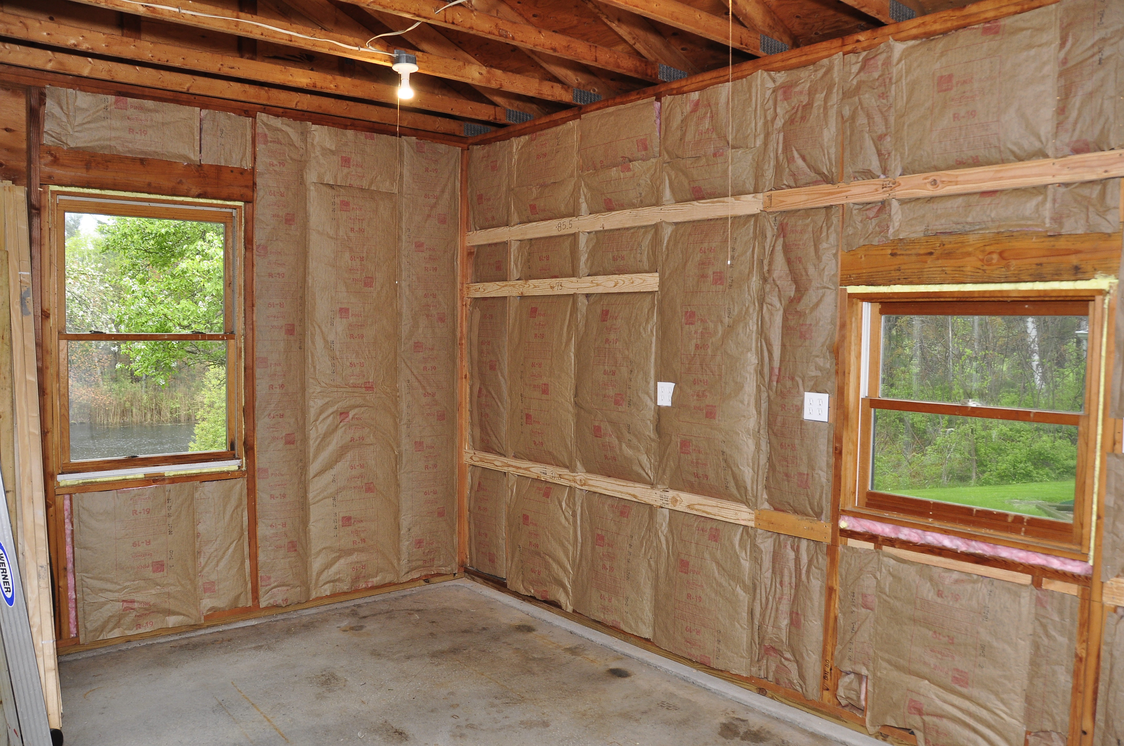

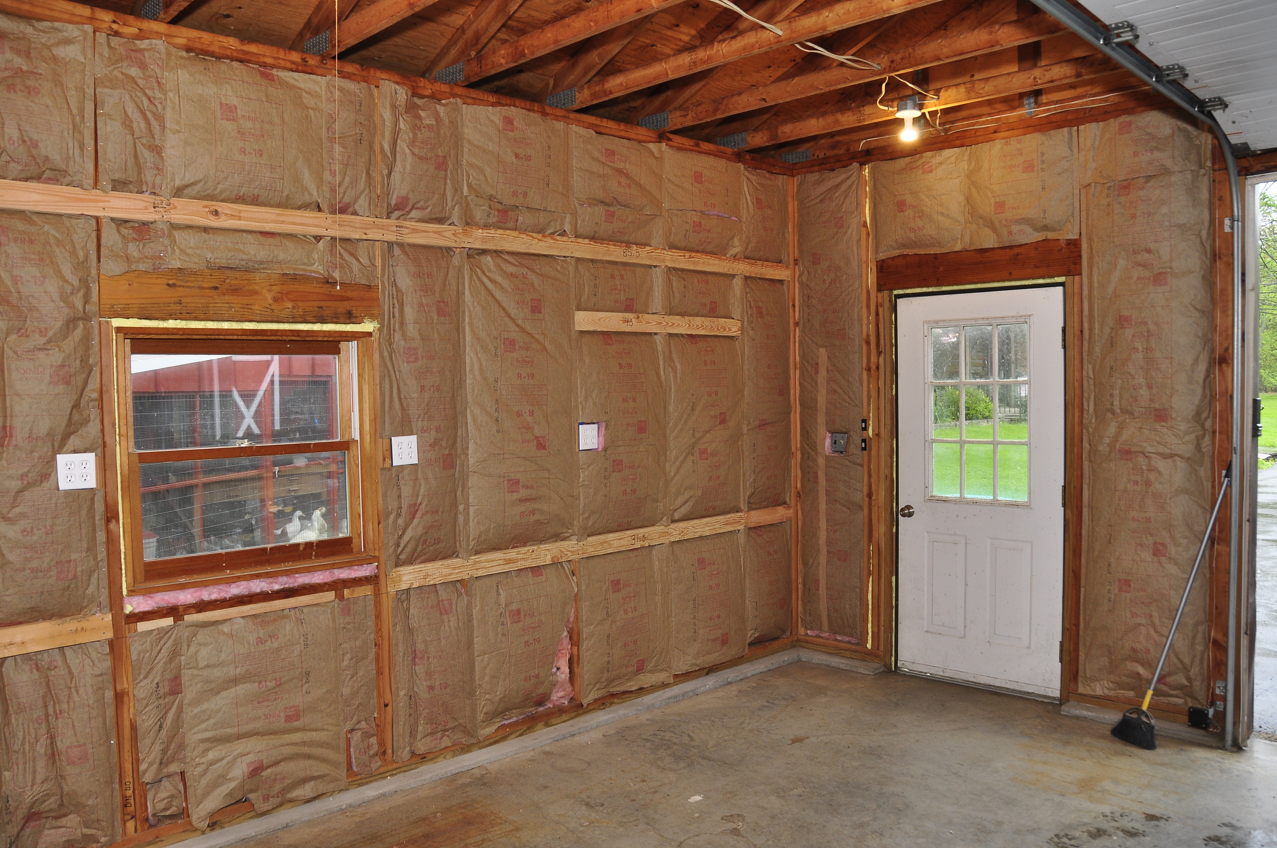

Finally had some time to spend on the shop. Added the nail plates over the wires and put in all the insulation. Ready to begin the sheet rock.

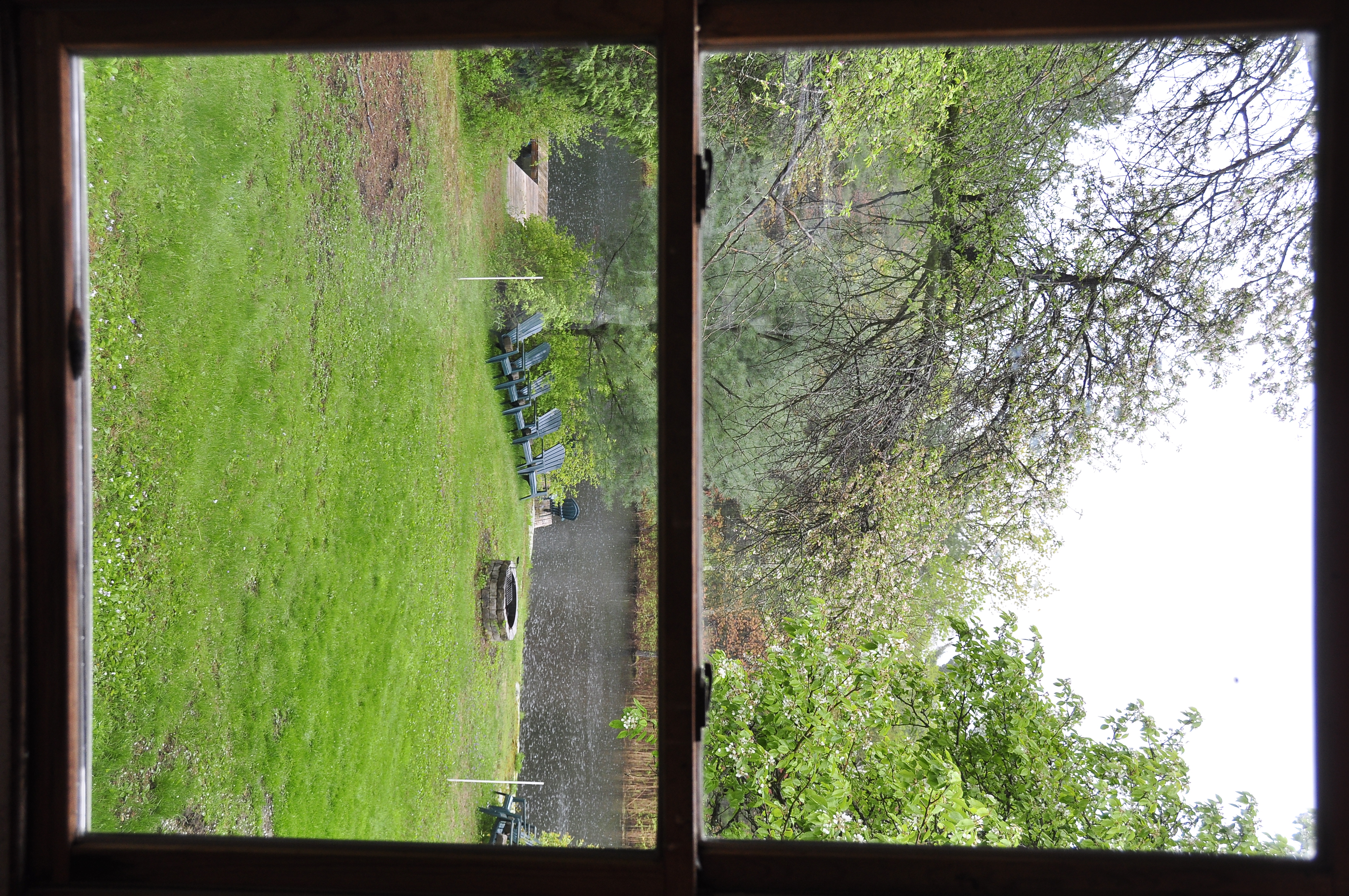

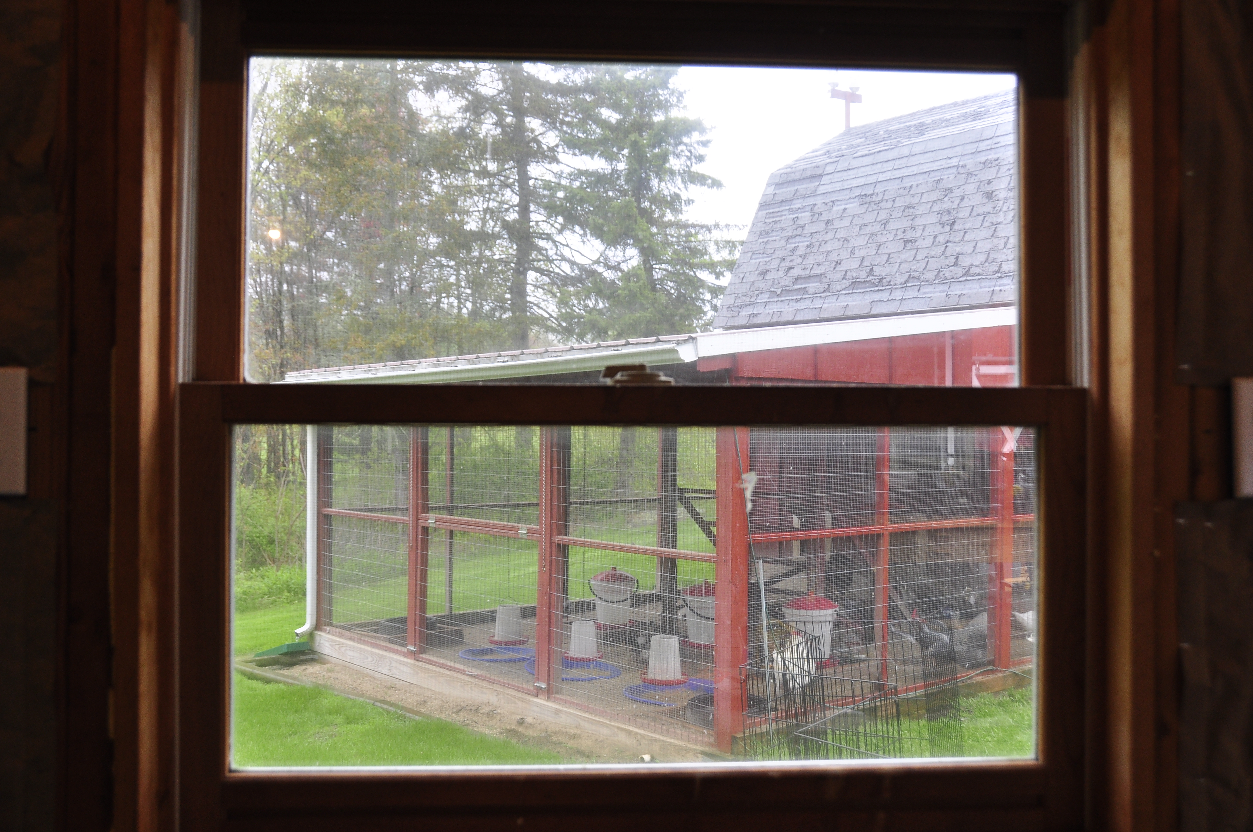

Here's the view from the 2 shop windows - some of the best views of any window on the property! The back window looks out over the firepit and pond, and the side window gives me a view of my chicken coop.

Looks good. What are you going do to for the ceiling? I always sheetrock the ceiling first, so the wall sheetrock buts up tight under it.
/ Finally Getting My Shop
#29
Eddie, I am not planning on anything for the ceiling at this point. That will come at a later date if I decide to fully finish the garage with the goal of having a heated garage (wood or pellet stove). There is no natural stopping point on the ceiling, so I think it would look odd if I only sheetrock a small section and not the entire ceiling. The walls have a garage door and window as natural stopping points to define the shop space.

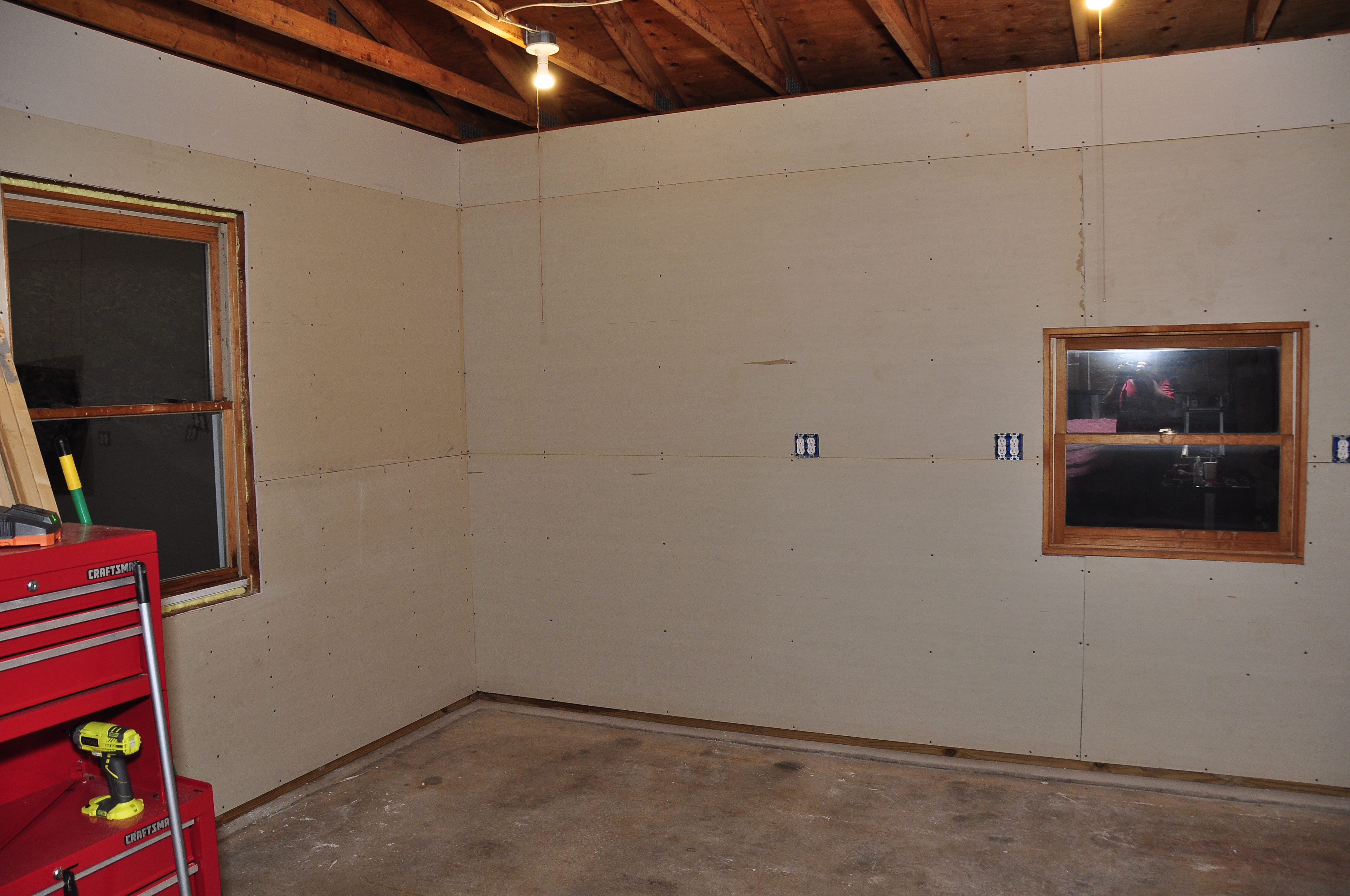

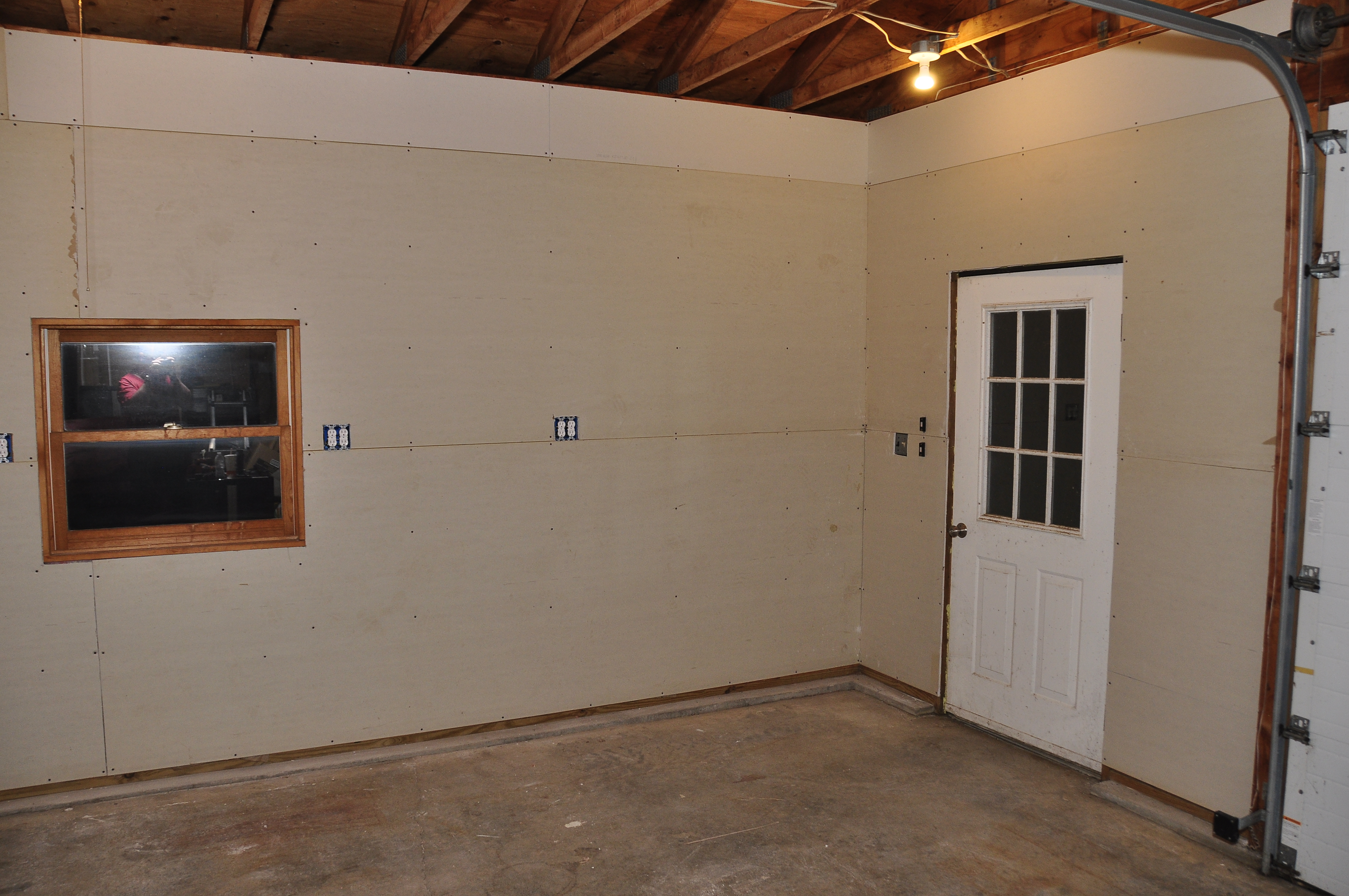

Sheetrock is up, and I am starting to mud the screws and seams. Also have to build sill extensions on the rear window and the door. Getting closer to having shop!
Eddie, in preparation for someday finishing the ceiling, I left a 5/8 inch gap at the very top of the walls so I can slip in the sheetrock so it is resting on the walls.

Nice job with the sheetrock. Good to see you cut the sheetrock to fit the windows and doors. Looks like a pro hung it!!!

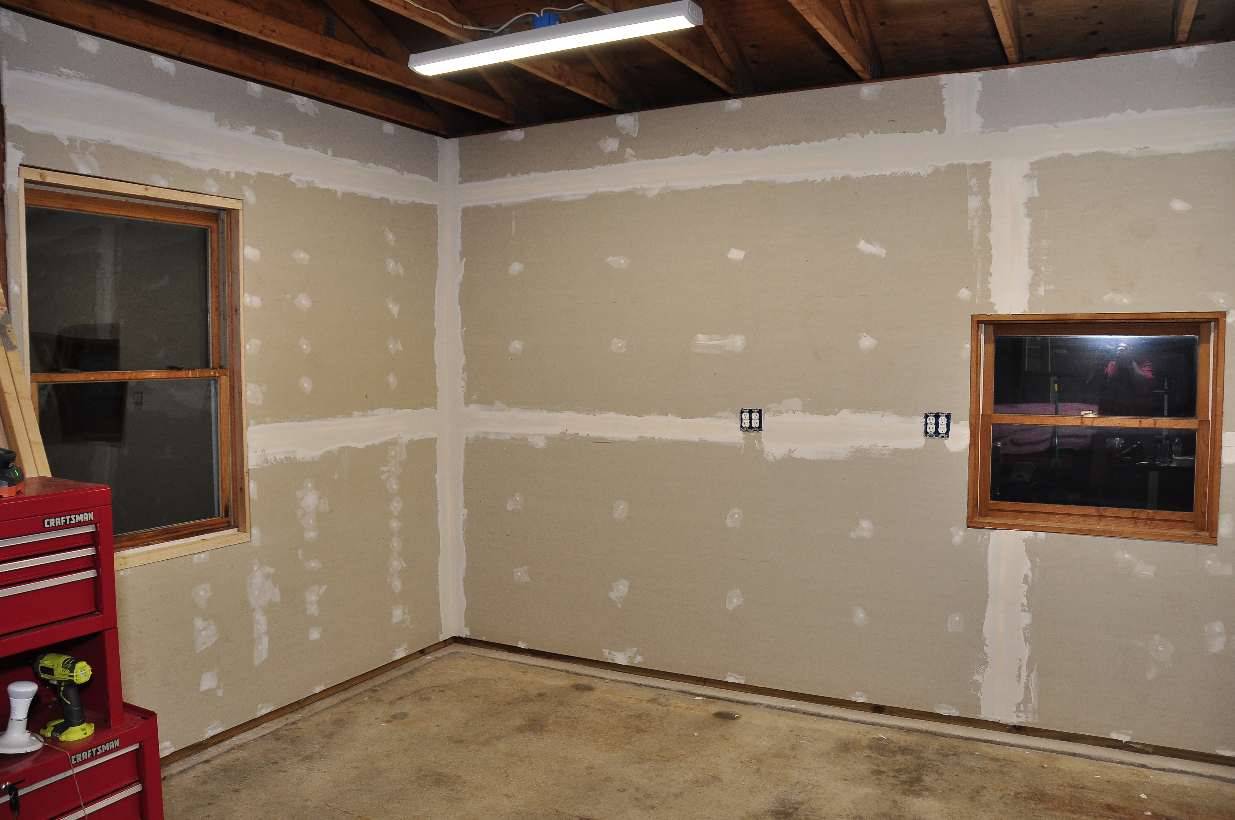

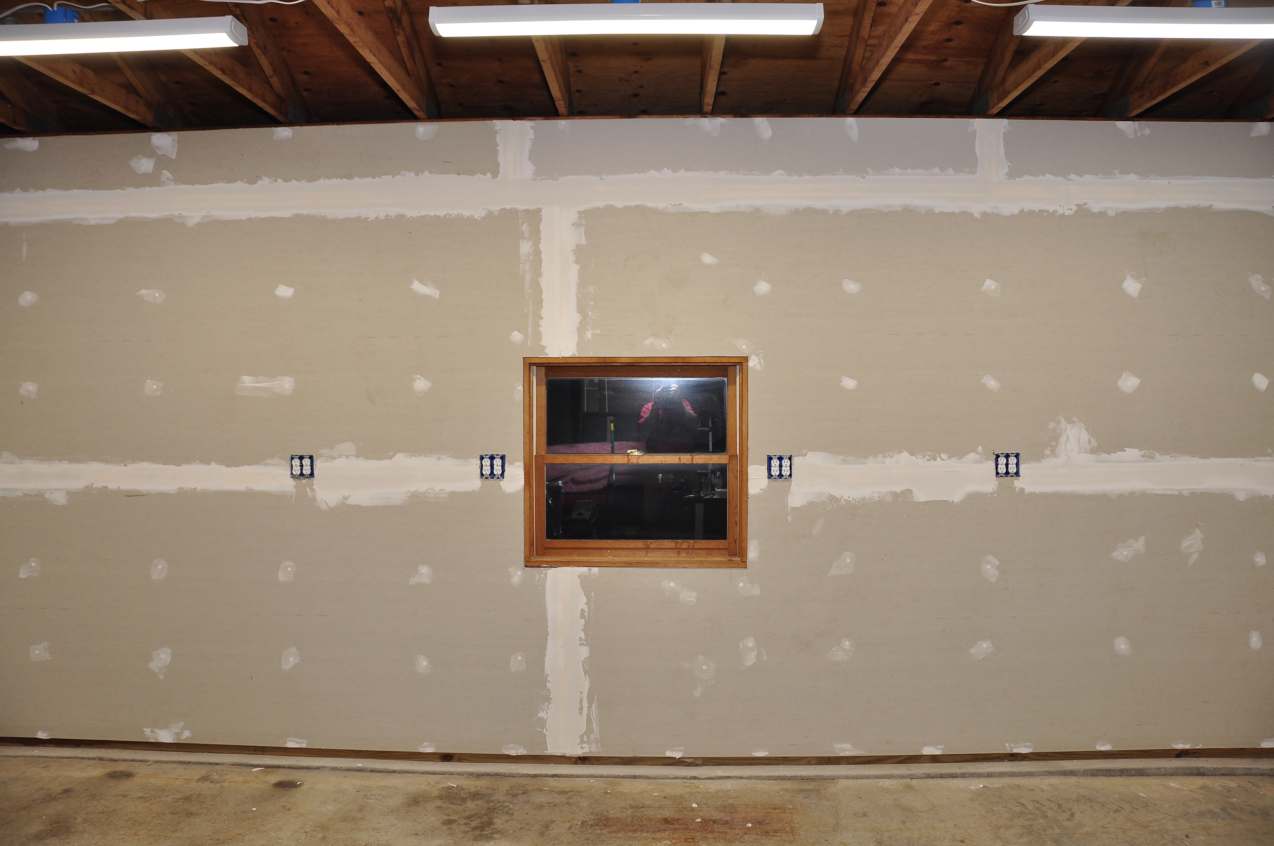

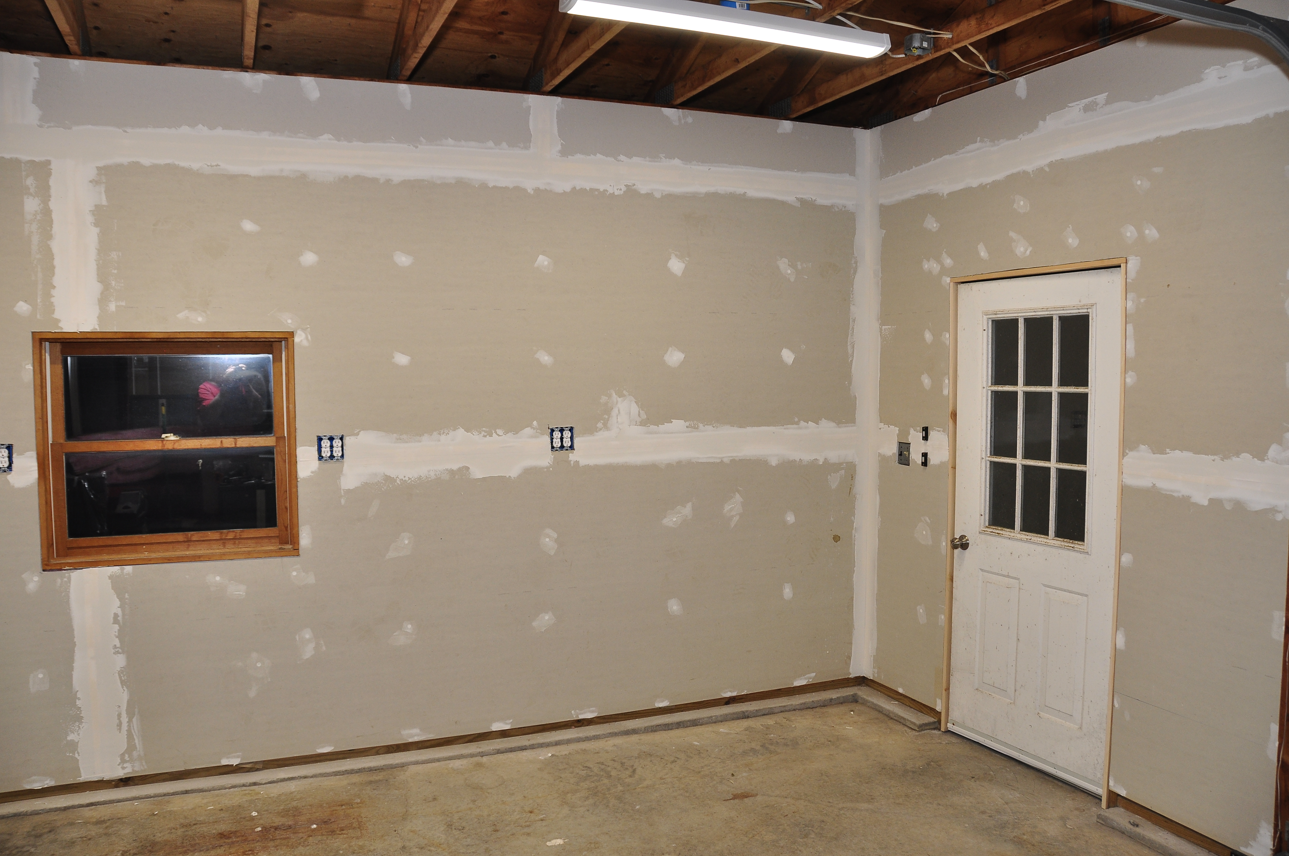

Today's progress was replacing the 3 single bulb light fixtures with 3 LED shop lights. Wow, what a difference! The 3 bulbs output 800 lumens each for 2400 total. Each shop light is 2400, so there is a lot more light! I also added the sill extensions on the window and door so they are now flush with the sheetrock and I have something to mount the trim to. Finally, I put the first coat of mud on the sheetrock. Mudding is a chore, and I have respect for the professionals who do it so quickly and so perfectly! I am neither quick or perfect!

I did think of that, but I am going the whole route - paint, window and door trim etc. Even thinking of epoxy painting the floor. Second coat of mud goes on this weekend, and then I'll paint the walls the following weekend. Thinking of a light gray paint with darker gray trim. I just replaced my home theater sound system in the house, and the old Sony 5.1 system will be going in the shop!
