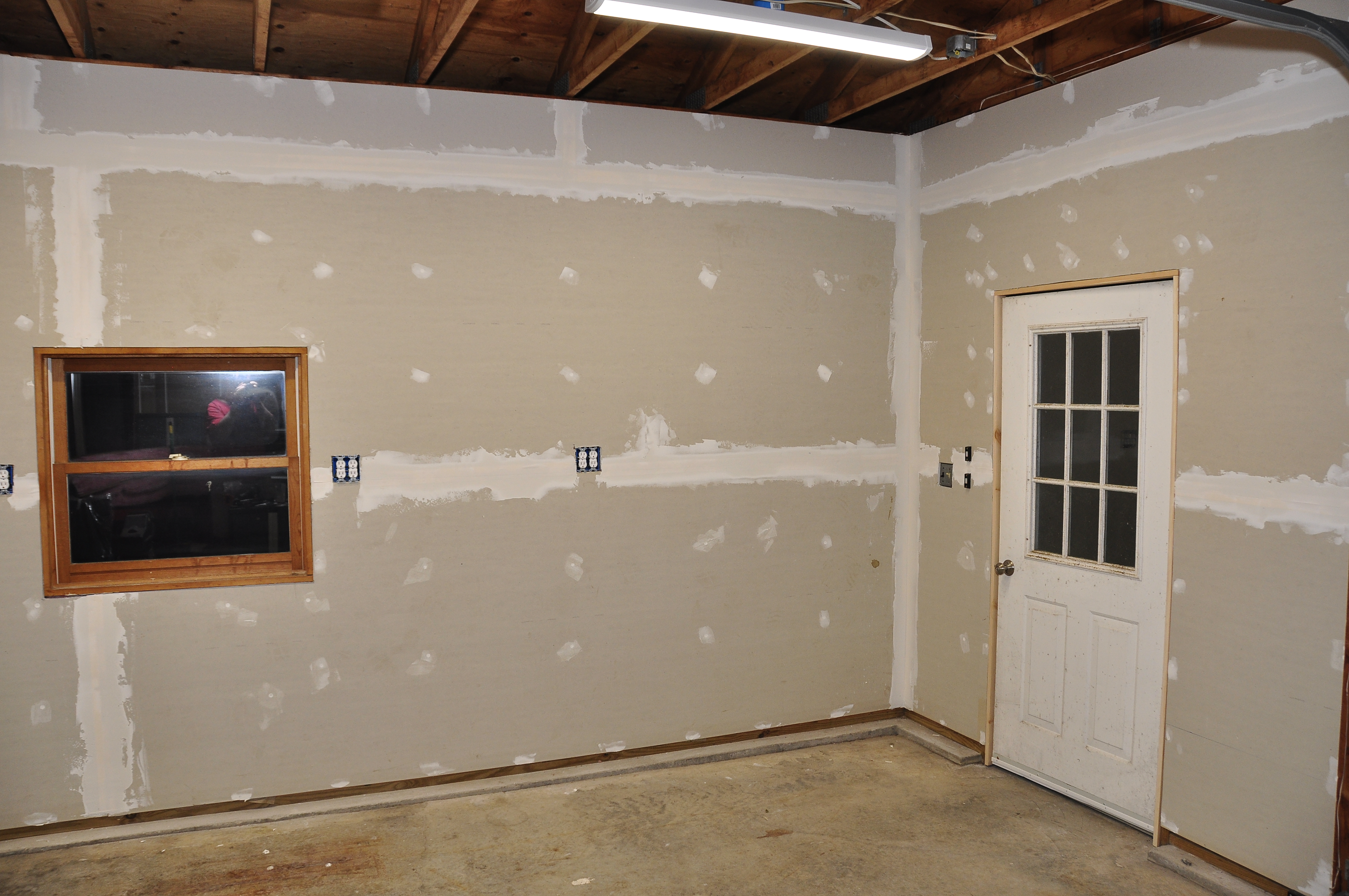

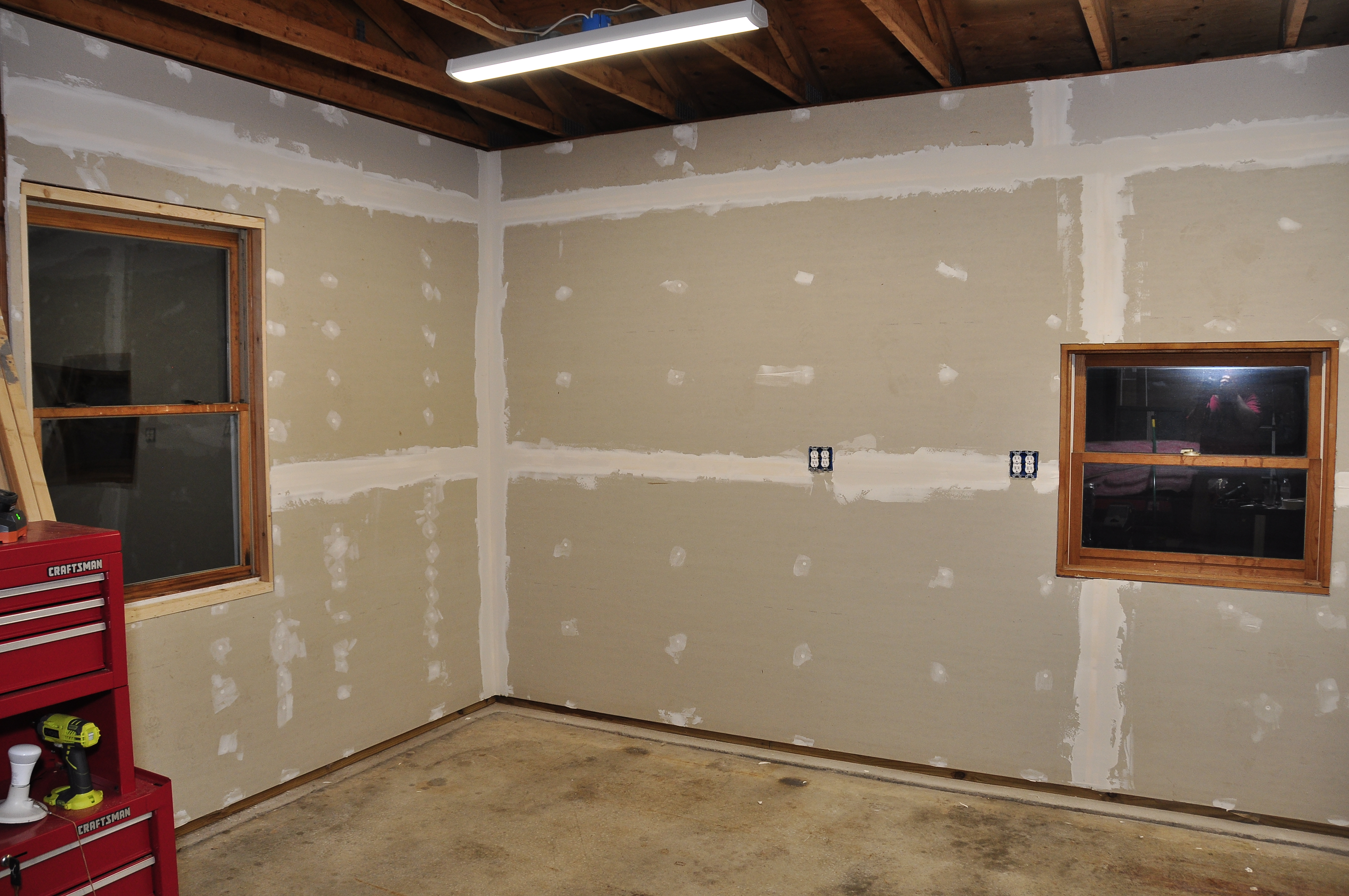

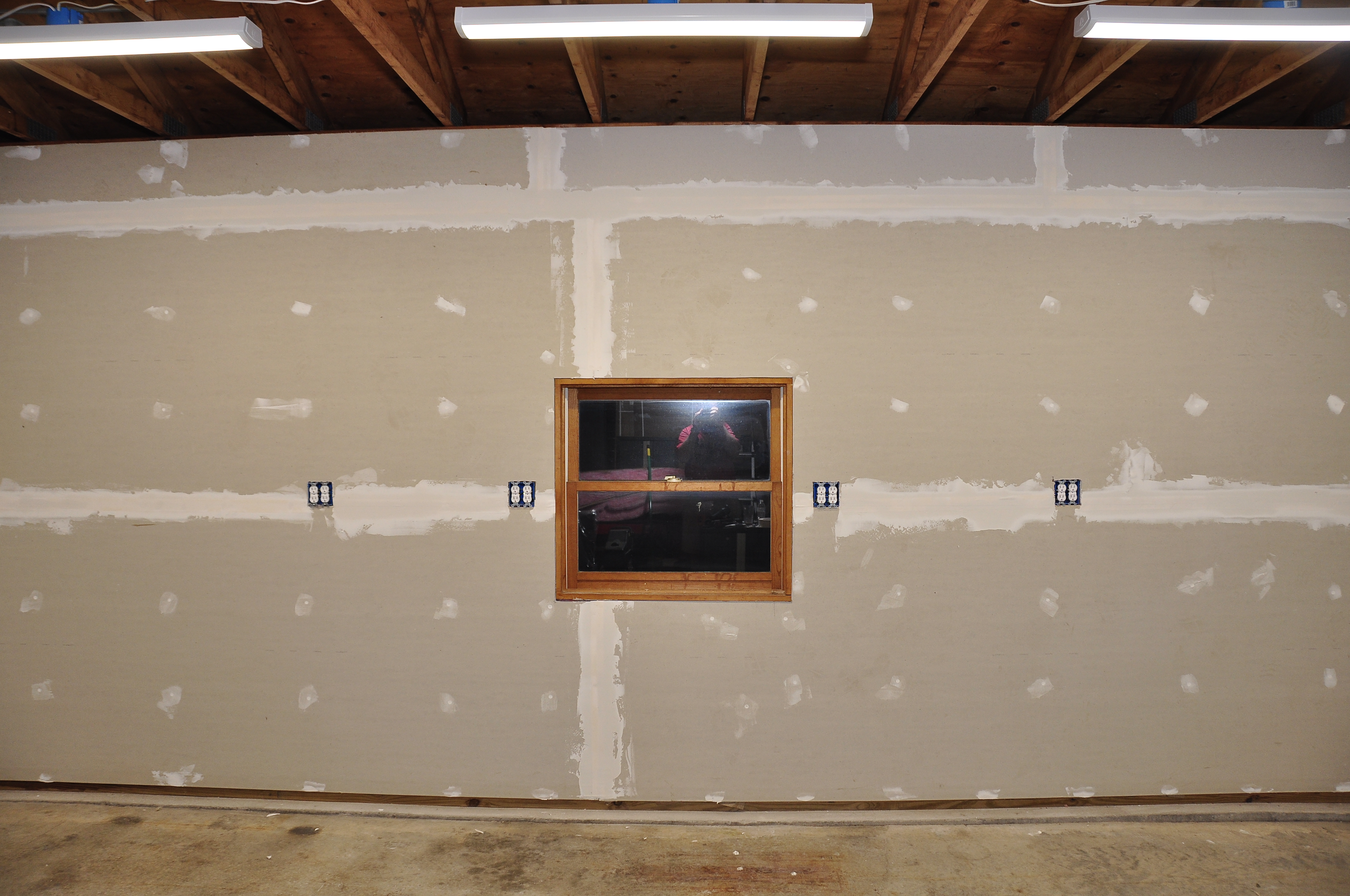

Today's progress was replacing the 3 single bulb light fixtures with 3 LED shop lights. Wow, what a difference! The 3 bulbs output 800 lumens each for 2400 total. Each shop light is 2400, so there is a lot more light! I also added the sill extensions on the window and door so they are now flush with the sheetrock and I have something to mount the trim to. Finally, I put the first coat of mud on the sheetrock. Mudding is a chore, and I have respect for the professionals who do it so quickly and so perfectly! I am neither quick or perfect!
   / Finally Getting My Shop #36
Looks real good and real bright. :thumbsup:

Just don't go the route of "I'll finish and paint later" on the walls, or you never will, for all the treasures you accumulate. BTDT.

Yeah second that... paint now before you populate your wall space hanging of VIP shi... I mean stuff.

I did think of that, but I am going the whole route - paint, window and door trim etc. Even thinking of epoxy painting the floor. Second coat of mud goes on this weekend, and then I'll paint the walls the following weekend. Thinking of a light gray paint with darker gray trim. I just replaced my home theater sound system in the house, and the old Sony 5.1 system will be going in the shop!
