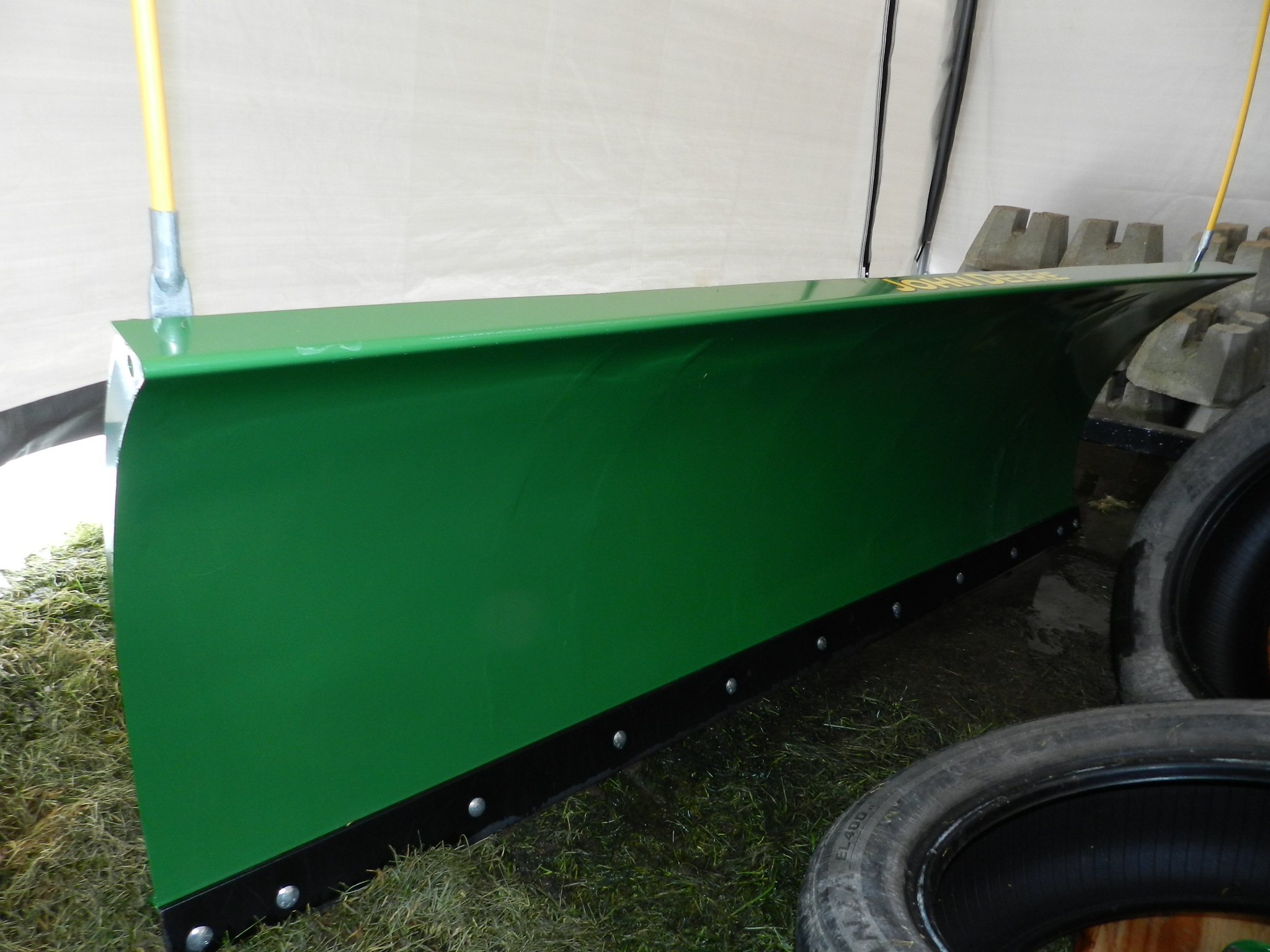

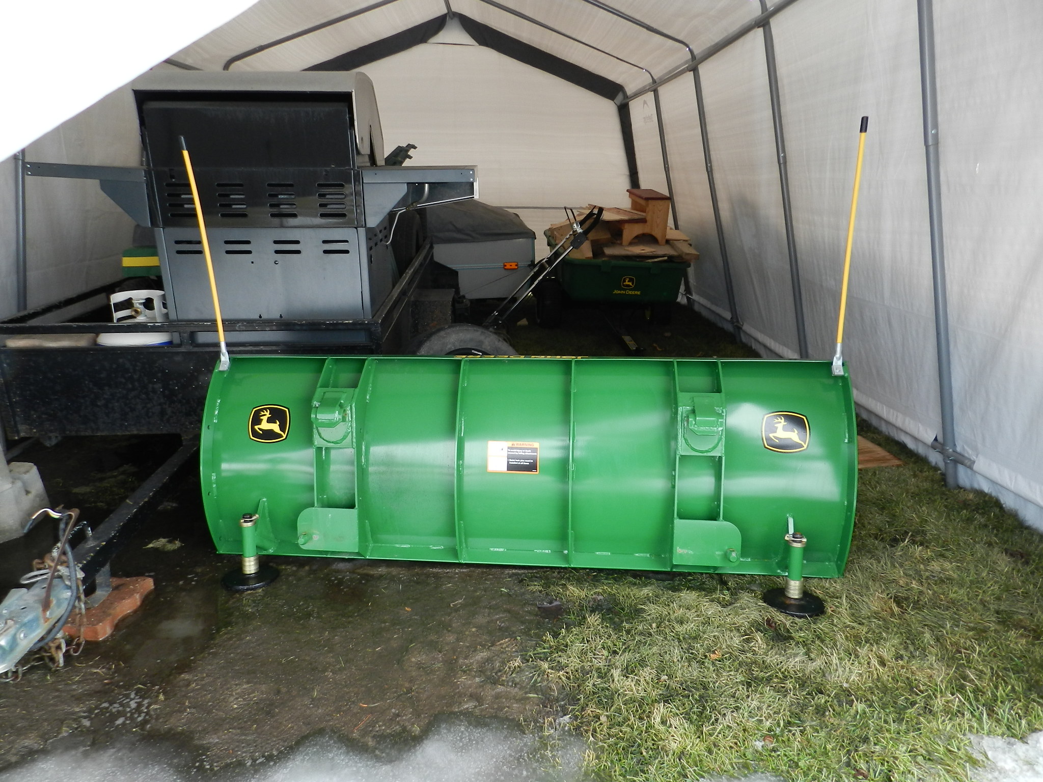

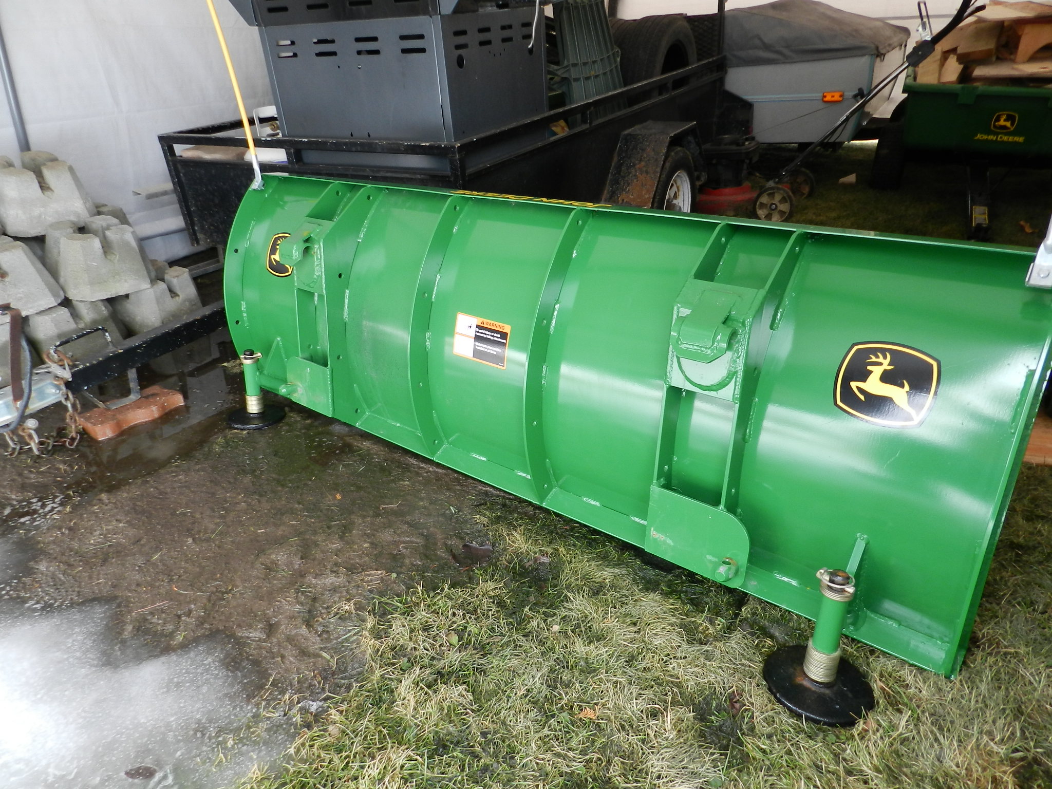

Sorry I haven't posted anything sooner. Here are a couple pics of the finnished blade. I will try to get more posted while mounted on the loader when my yard dries up a little. I pretty much got a soaker walking to the cover-all to take the pics.
/ FEL Snow Blade Build #45
Wow, that is a excellent looking blade. Well done. Have you had an opertunity to try it out.
I've actually have been using it for the last two years. Works awesome... I was thinking of putting small sides on it to help it float a little better. It tends to want to dig into my laneway. I was also going to weld a pipe on the cutting edge which should solve the problem. Thanks for the complements.

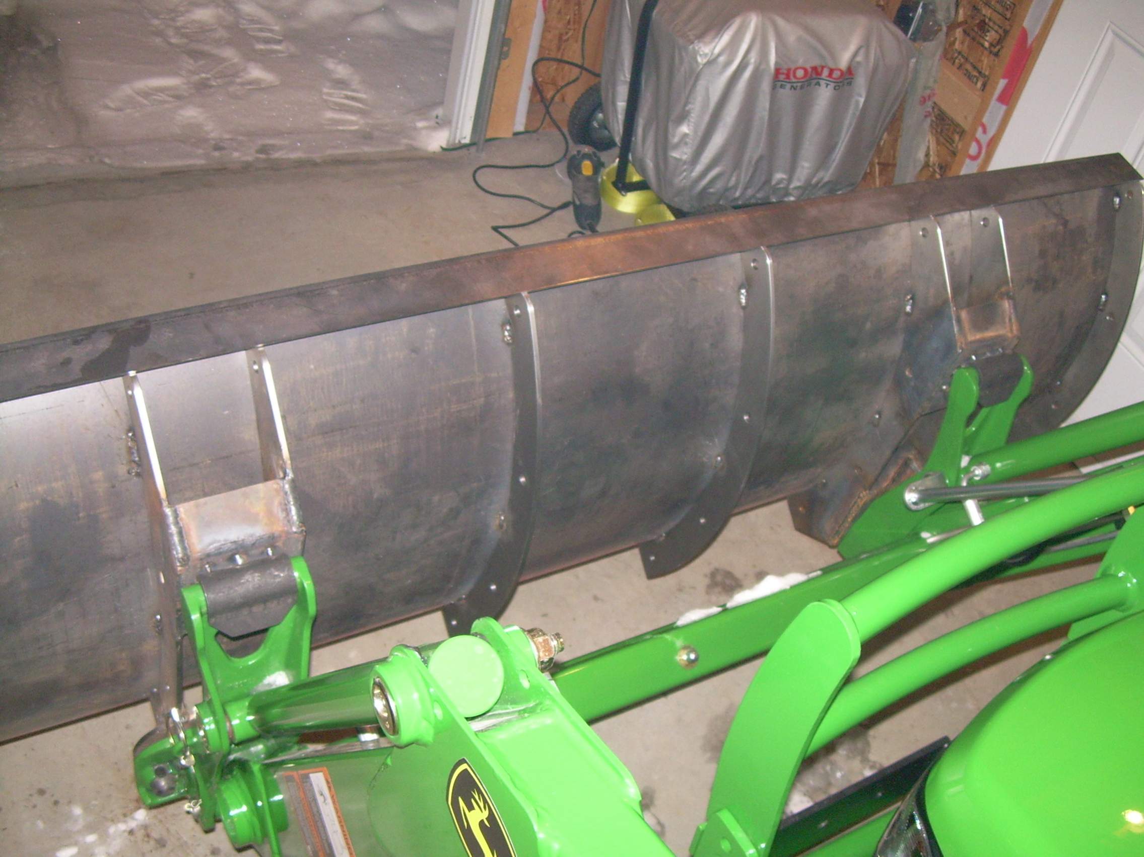

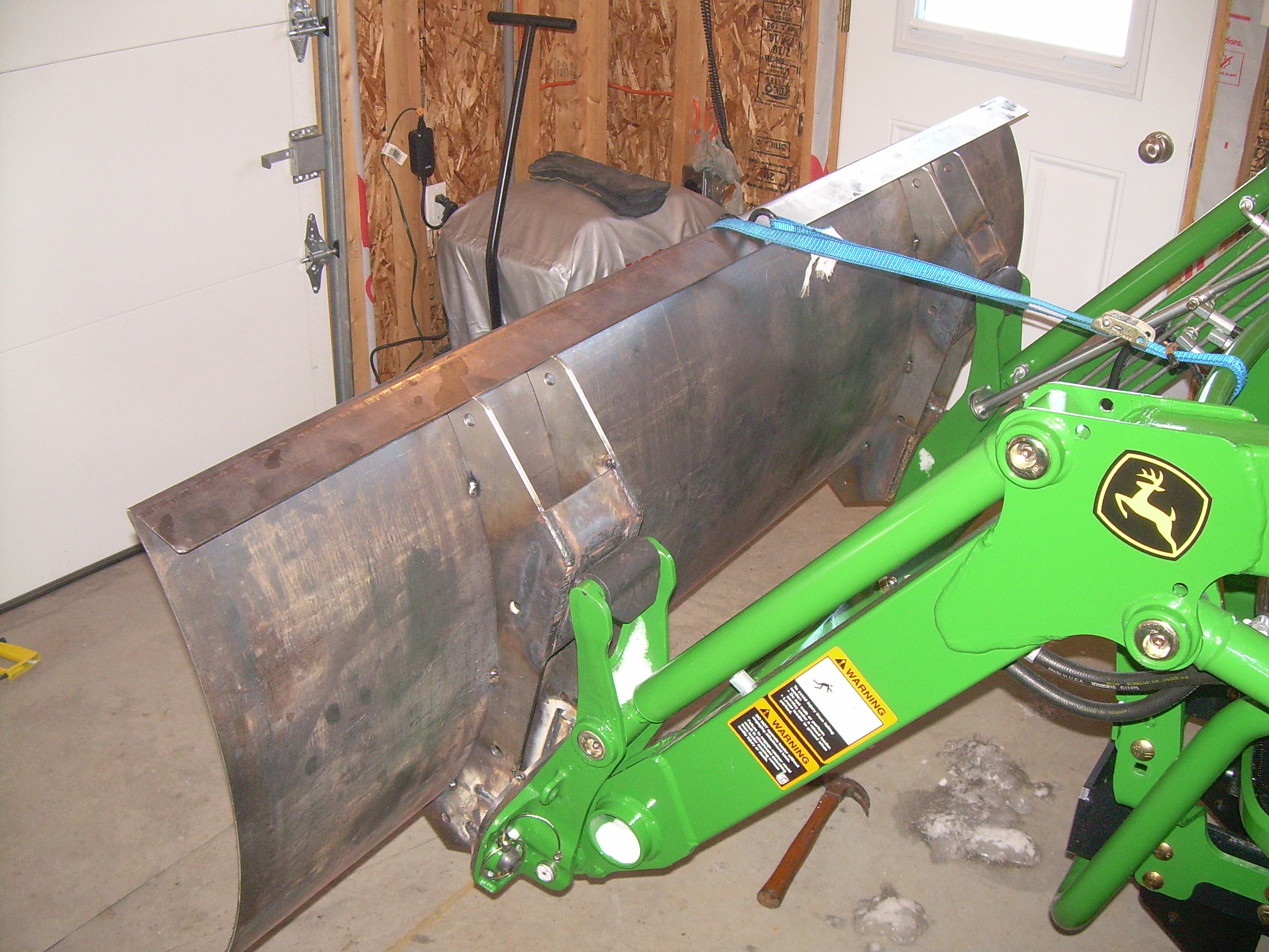

Did you have someone roll the steel for the blade

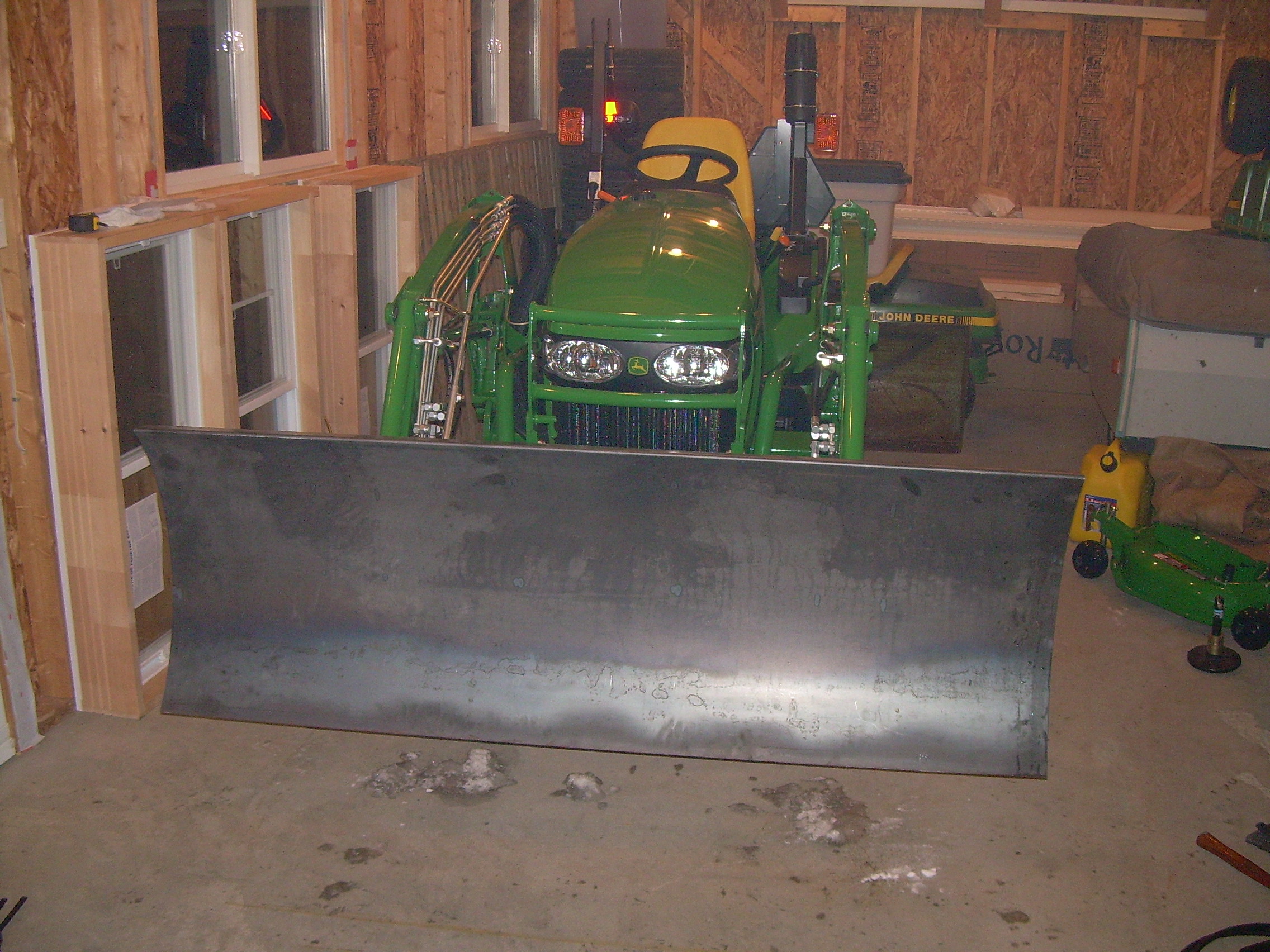

Wow, that is really slick! Did you end up having any problems moving snow without angles and all that?
Also, is it really much different from just using the bucket?

I built a plow for mine that angles. I found that I hardly ever had a need to angle it. I am seriously thinking about doing something similar Nyen0004's setup but adding wings to the end.
I had no problem pushing, unless we get a really wet snow fall it worked great. I dont really have a long lane way so i have enough pushing power to make it all the way.
I can clean the lane way in a 1/4 of the time it would take with a bucket.
Sfrankland, I was actually thinking of making side wings. That way i wont get the spill out therefor have to make less passes.
