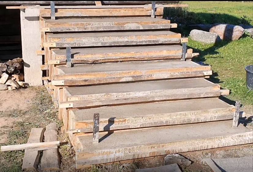

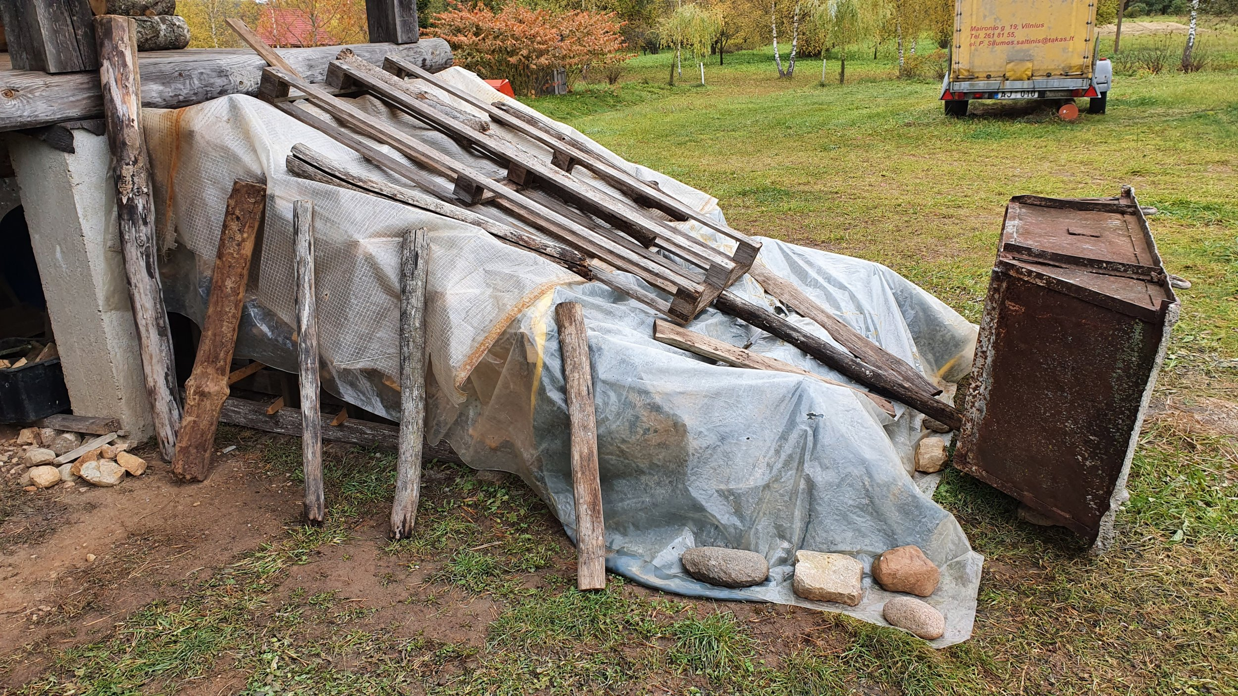

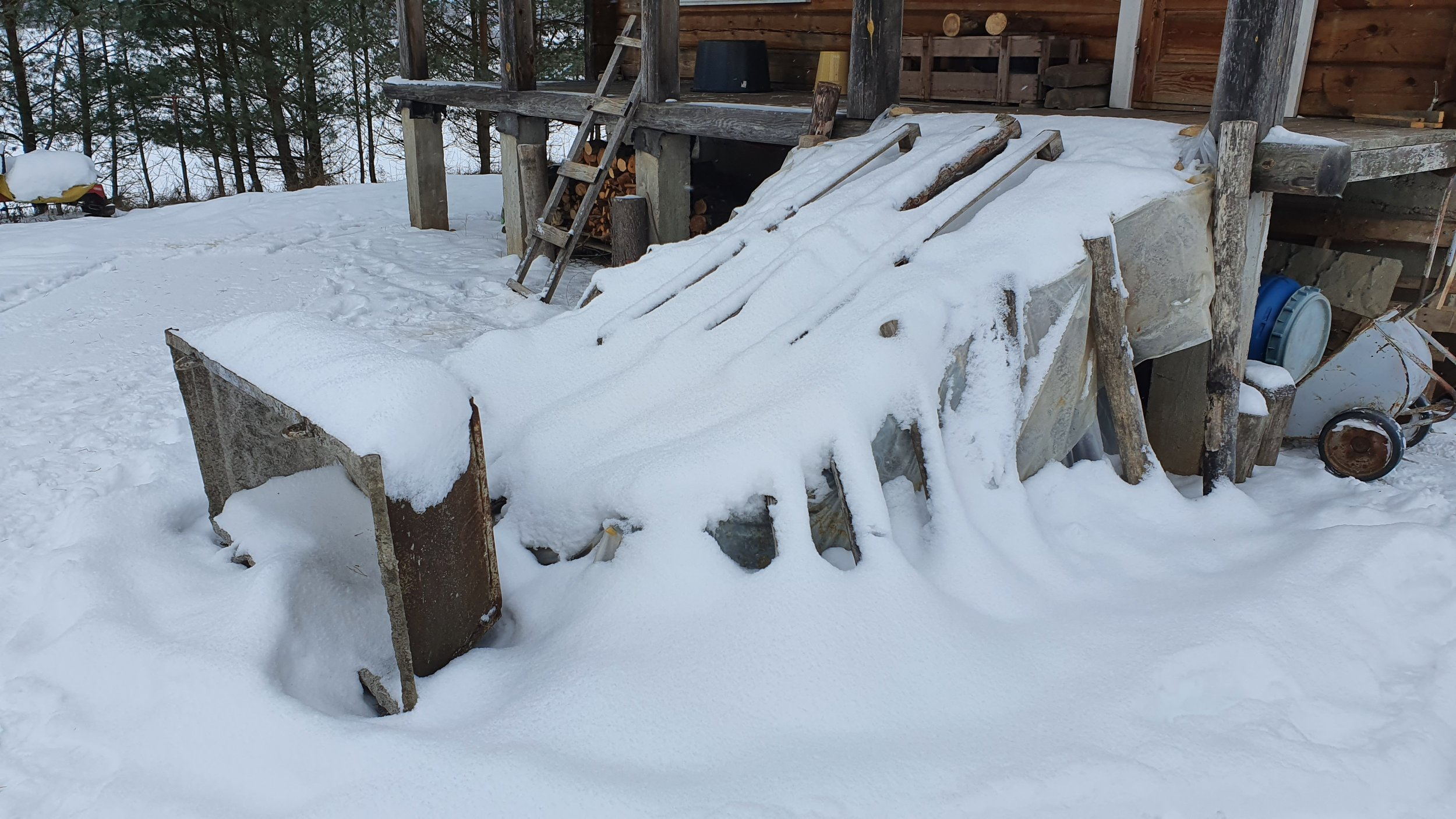

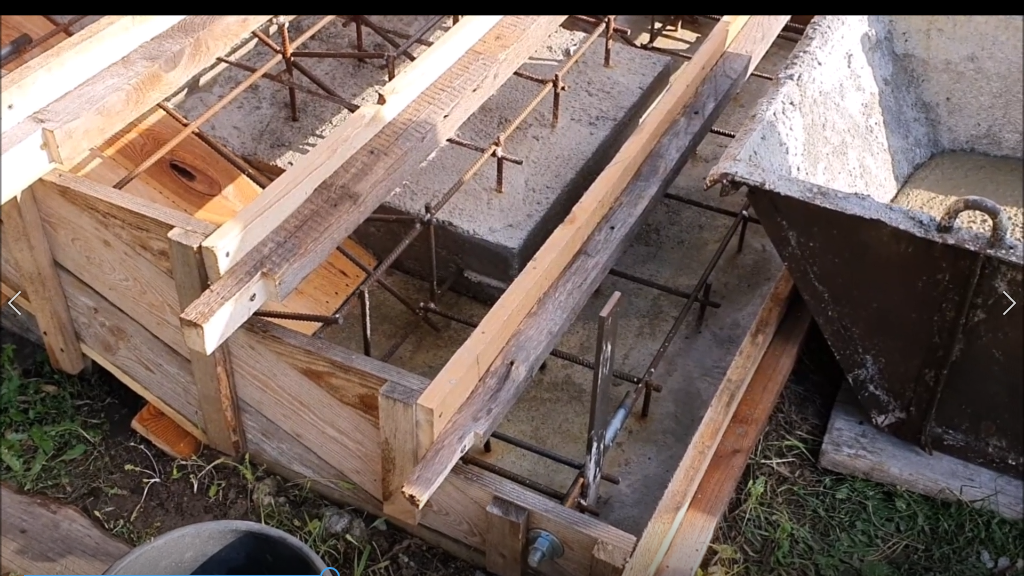

Here comes the time to build the concrete outdoor stairs at the entrance of the house. The process is stopped due to the winter time. I have covered the stairs to prevent concrete from sucking the water, wet snow and freeze. The last 2 upper stairs will be finished next year.
I'm doing that myself, although it's not my profession. That's why any comment or advice what must be taken into account will be much appreciated.
There are a few pic of the job done till Oct 6, 2021.

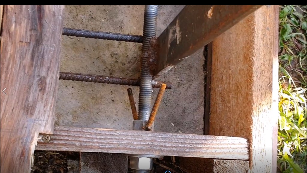

Looks good so far. Lots of rebar. Is there any pitch to your stair treads for shedding water? Are the vertical rebar “stickers” for the purpose of securing your railing? What will railing materials be?
I would make sure to thoroughly seal the areas where water can seep in and get to rebar as well as any joints. I like a concrete sealer after curing on steps and caulking any open joints to stop water infiltration
/ Building The Outdoor Stairs
I envisioned this so, that when puttying the steps I'll make small slope on each step. And before that I'll put some primer and paint on each of the steel strip to seal them from humidity.
Yes, they are for railing. They'll be made of steel by the local company, which specializes in such works. They have many examples of handrails of various designs.
Yes, I know that. Moreover, there are 3 protruding threaded rods on both sides now holding the formwork, but after they'll be removed, a light roof frame also made of steel will be installed on those rods. I will definitely need to seal them all.
Thank you for your insight. (y)

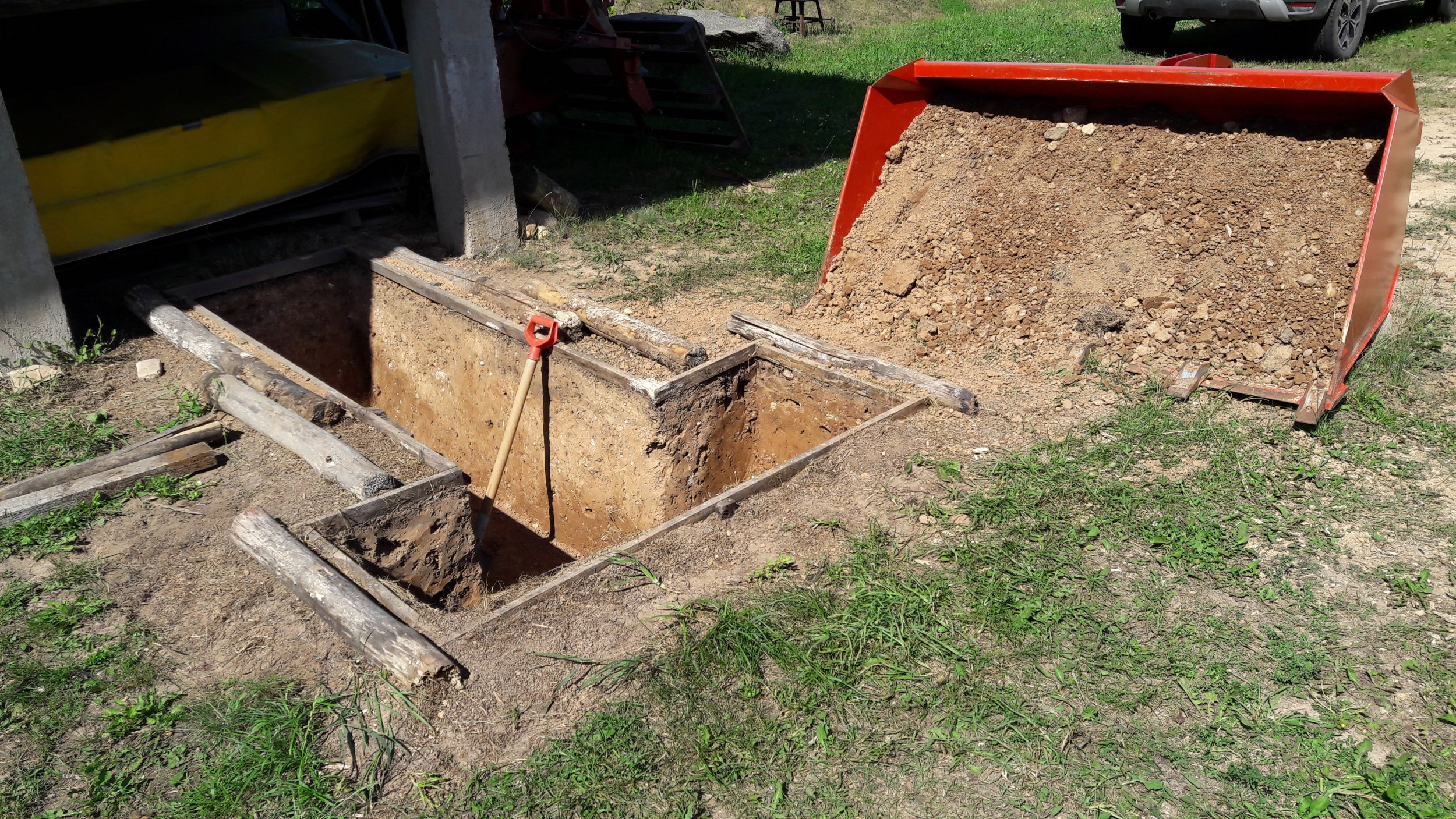

/ Building The Outdoor Stairs #9

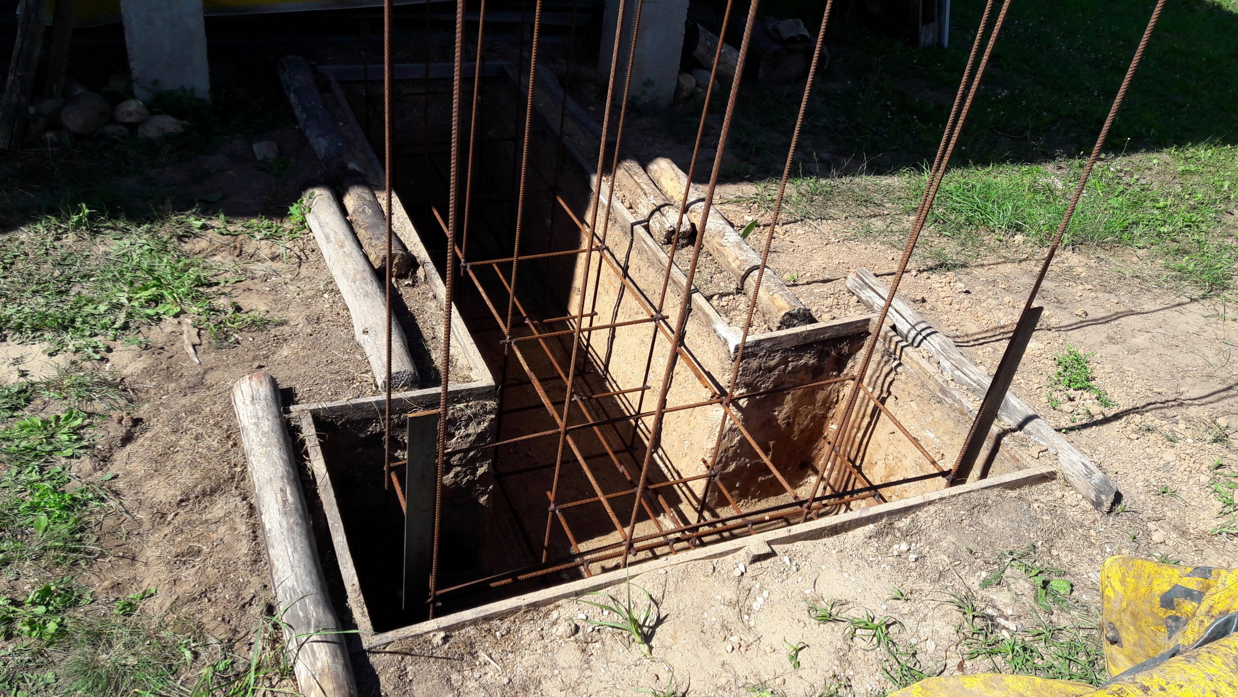

Looks good and well done. Got a lot of it done. I am wondering why the base is so deep. Looks like 3-4 ft unless I am not seeing it correctly. How cold does it get there?
/ Building The Outdoor Stairs #10
Yeah X2
and nice dirt for footings. Looks easy to shave with a long handled spade.
#11
Here is a clay. Soil freezes deeply in my country, up to the range of 0.3-1.2 m. In winter, frozen clay distorts the foundations of buildings. Moreover, after digging a pit in the clay, a sand pillow still needs to be laid under the concrete and compacted. In this case, I laid a foundation in about 0.7 m deep. I know there are more ways to solve this problem, but I chose this one.
/ Building The Outdoor Stairs #12
Thanks for the reply. That is a deep freeze or frost level. I thought it might be necessary because of the temperatures there. Good job. And I like the added amount of rebar. Do you use air entrainment in the concrete there? Just wondering.

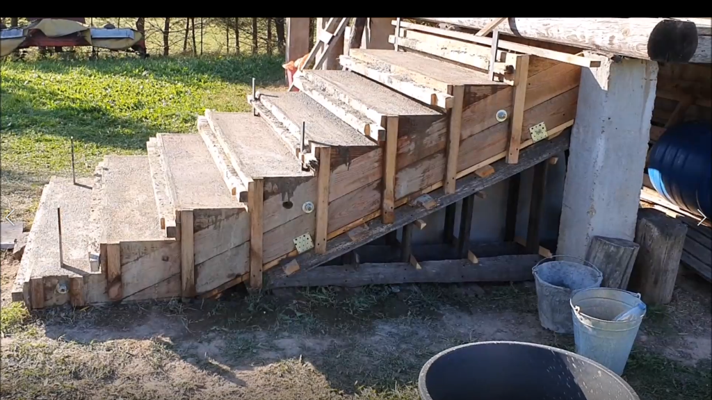

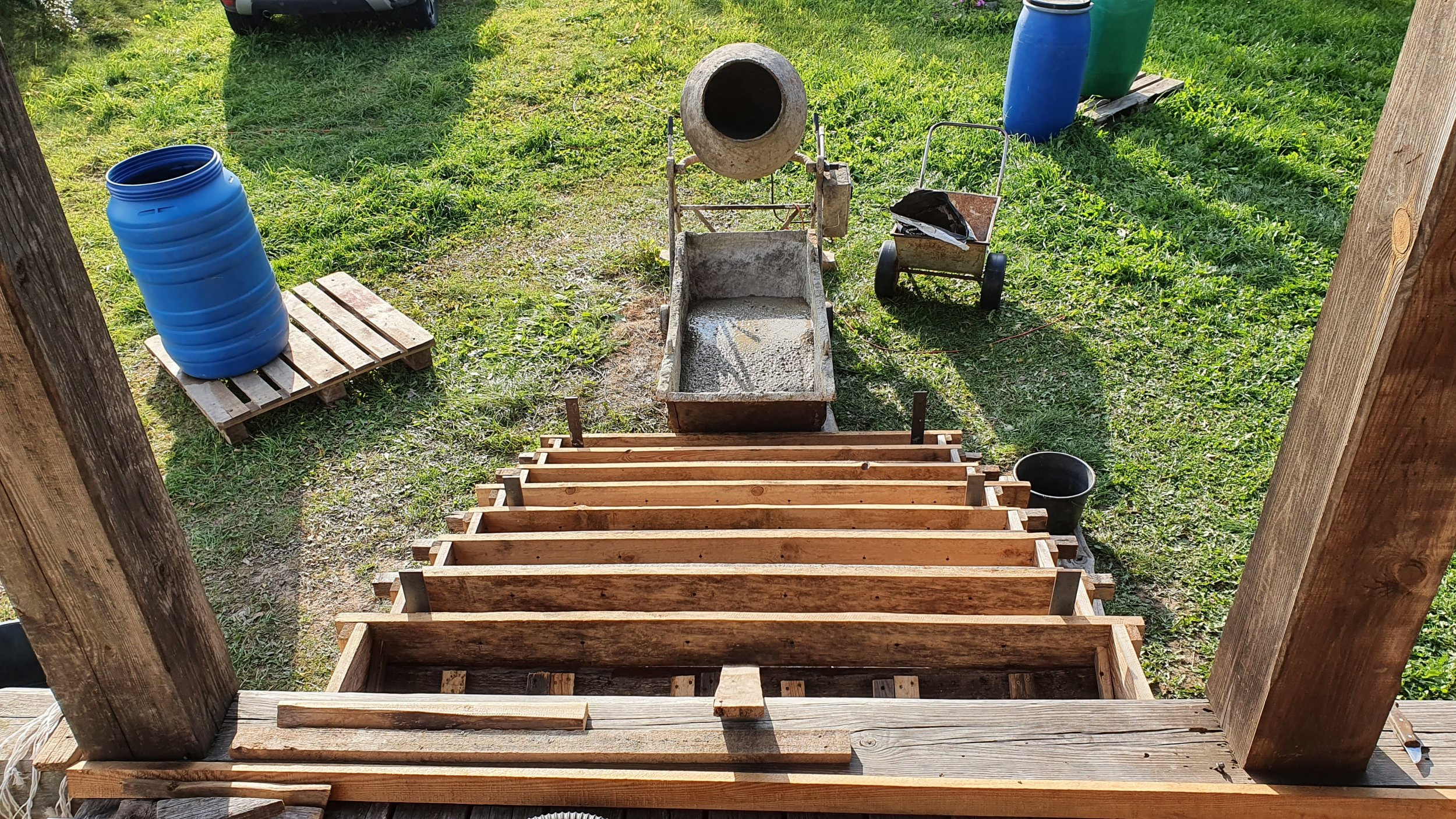

I have a small electric mixer machine, bought some concrete sand, cement, rebar and did it all myself. Including formwork.
I welded up the rebar. Some others are joining the rebar with a wire, and I started to do it this way. But later I found the rebar joints are more stable while welded.
I didn't vibrate the concrete, because, as I mentioned before, I made it more liquid, more than recommended. Don't know is that good or bad. But concrete flowed very well while filling a formwork.
Next year I will need to concrete a beam under the wooden columns to replace rotting wooden log.
The concrete beam will have to be integrated with the upper stair steps and the concrete columns on both sides of a staircase. Hope the staircase will be sunk down by Nature within the winter time and the connection of the concrete beam with the staircase would not make a problem (cracks).
