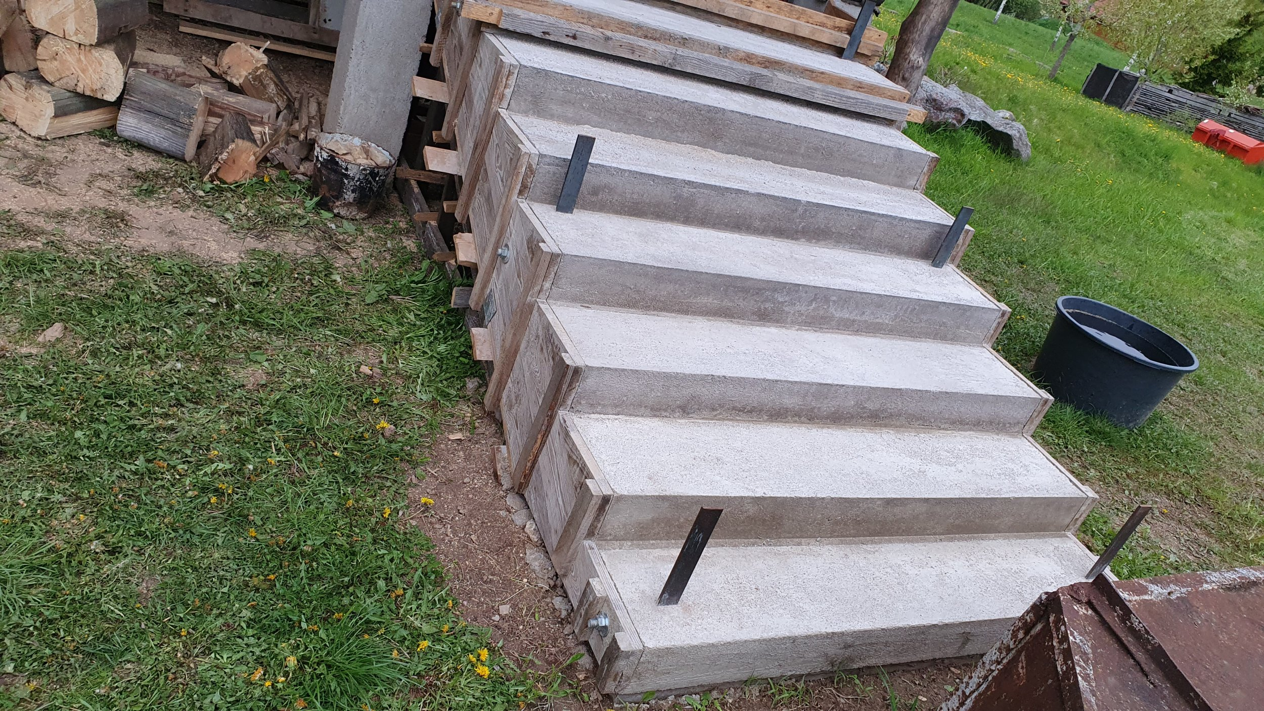

Beautiful job on forming and reinforcing your stairs. Hope everything turns out good.
Here are some things to consider when you are ready to pour the upcoming supporting deck beam.
1) Be sure to include aggregate (different sizes is best).
2) Mix as stiff (less water) as you can (add water a cup at a time near the end of the mixing process). The optimum ratio is 0.4/1.0 water/cement
3) The wetter you can keep it during the curing the stronger it will be. This is a cement hydration process, it is not "drying".
4) There is a thing such as to much cement in a batch and will actually make the finished concrete weaker.
5) Typically, it is expected that a concrete mix will reach 50% of its design strength in 3 days, 75% in 7 days, and 98+% at 28 days.
I know you were trying to mix thin to get the concrete to flow in the forms but a "Hand Held Concrete Electric Vibrator" such as this one on Amazon
(Amazon.com)
this is just an example because I don't know what your electrical requirements are.
This vibrator will make a very stiff concrete mix flow very good and fill your forms without a lot of air pockets.
Good luck

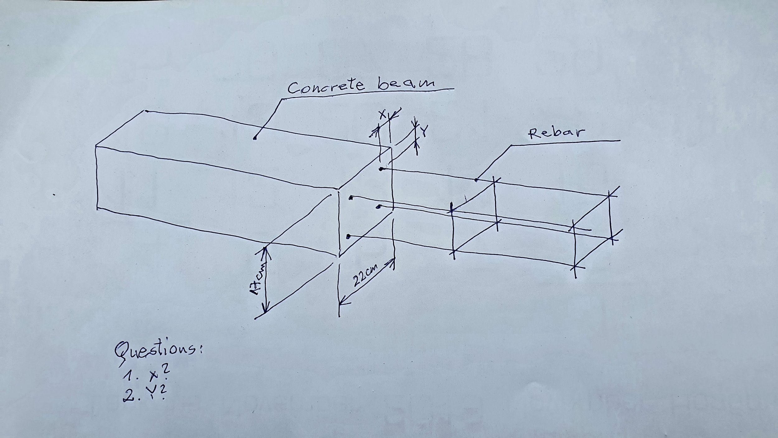

Ok, lets go further with the project. Before that I have something to ask.
I'd be much appretiated if someone might answer a question.
How deep should the rebar be sunk in the concrete as shown in a picture below? I mean distances "x" and "y"?
Thank you in advance.

I'm sorry, my question was probably incorrect. I will need to make that beam of concrete. It doesn't exist yet. But before that I need to know, how should I place the rebar in the formwork correctly.
Minimum cover for concrete is 1.5 inches. That is minimum - more is better. Your decision is complicated by the size of this beam. I would recommend 4cm for ""x" and "y"
   / Building The Outdoor Stairs
#60
Very good. I thought so, but was not sure. I was prepared it'll be between 4 an 5 cm. Many thanks.
