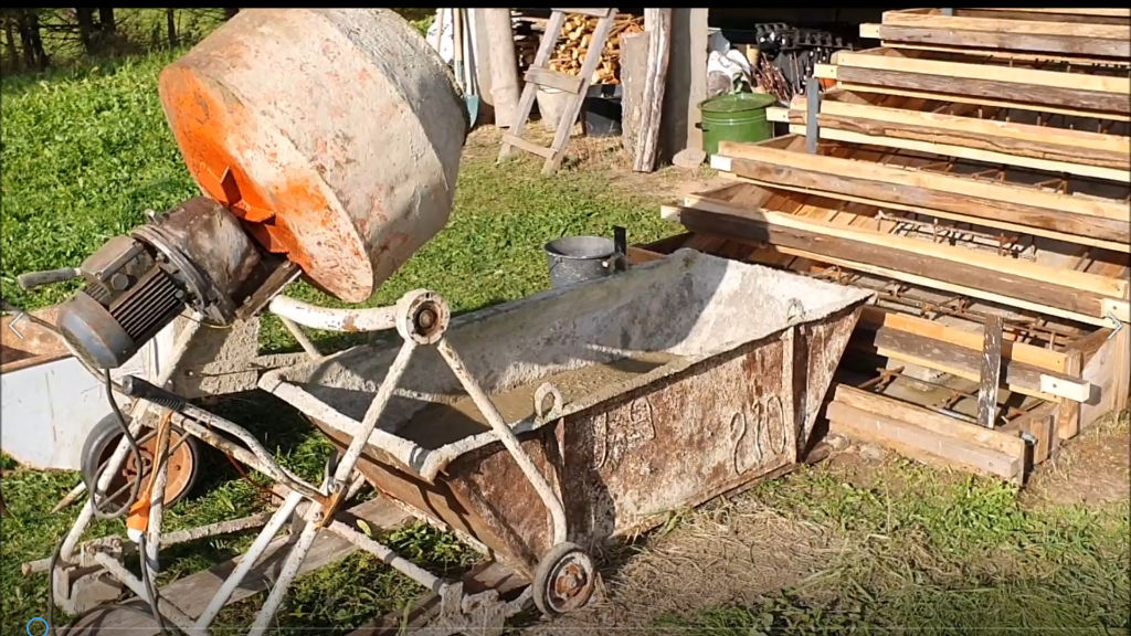

OK. To make it clear I'll tell the mix proportion in metric unit liter, what I put into every mixing machine.
According to volume:
1/ 40 L of concrete sand;
2/ 10 L of cement;
3/ 7 L of water.
According to weight:
1/ 77 kg of concrete sand (wet);
2/ 14,4 kg of cement;
3/ 7 kg of water.
1/ and 2/ are recommended by cement producer.
Is that catastrophic?

Well, it wasn't like soup. In my opinion it was like the one which flows from a mixer truck pipe. It doesn't create an ordinary pile if it's placed on the ground, but it makes a low, wide, wet pile.
Here below how it looked like in a box.

At a glance. That would be absolute maximum water for your concrete. If your sand is wet, that changes things. The wetness of your batch maybe caused by the wet sand.
Question? No aggregrate?

#36
When I discussed concreting with knowledgeable people before all the work, most of them said that if you want to fill in the formwork well, make more liquid concrete. It's all about in HOW MUCH MORE liquid - 0,55; 0,6; 0,65...? This is not my first time concreting in my life, and I have some idea what it should be like when the ratio is 4x1x0.5. It turned out to me that 4x1x0.7 (at a glance) is still appropriate. If you add more water than this ratio, then yes, concrete mixture becomes like a soup, it becomes difficult to control, it runs through the edges, but it wasn't like that. The filling was easy to control. After a couple of hours there were no traces of water left. After a day, the surface had hardened. Since the stairs are on the South side and there were sunny/windy days, the stairs dried really fast. I understand what Streetcar stated "Concrete cures by chemical reaction not by drying". But the excess of water certainly didn't seem big. The water which appears while you're puttying the top surface just disappeared quickly, maybe soaked into the formwork or a lower base, I don’t know. After a few days, I even watered the stairs a few more times, according to recommendation.
Another thing is that I don’t know what an easy way to determine the hardness and quality of concrete in general. Some weeks later I did not detect any cracks on the top surface unless they are microscopic or they'll appear later. And when I tried to hit it after three weeks with a chisel and a hammer, it didn’t even try to crumble. There will be places where I will need to smooth the surface of the steps, I will do that with a diamond grinding disc. Maybe then it will turn out what happens with a quality.

Google "To much water in concrete mix".(https://razorbackconcrete.com/what-happens-if-you-add-too-much-water-to-concrete/) and "Concrete Slump Test". These will shed some enlightenment on mixing concrete.
Simple and good explanation. Thank you. One consolation is remaining - there were no cracks noticed after days and weeks passed from the pouring day. The question now is - ether I am at the edge to ruin entire project, or I ruined it. We'll see it in the spring.
