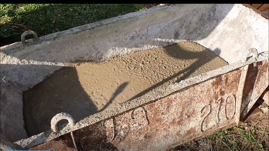

Something to consider is that the advice you are getting from everyone is for flat work. While it's true that extra water will cause the concrete to crack and it will not be as strong, it is also true that what happens on flat work is not the same as what happens on monolithic pours like your stairs.
Ideally, less water would have given you more strength. But in all reality, the stairs are not going to support anything heavier then people carrying furniture. Never will there be more then half a ton of on them, compared to several tons of weight on a flat slab.
It's nice that everyone took the time to suggest other methods to accomplish what you have done, but from what I saw in your pictures, and all of the rebar that you used, there is no doubt in my mind that you have created a set of stairs that is more then strong enough for the task, that will last hundreds of years.

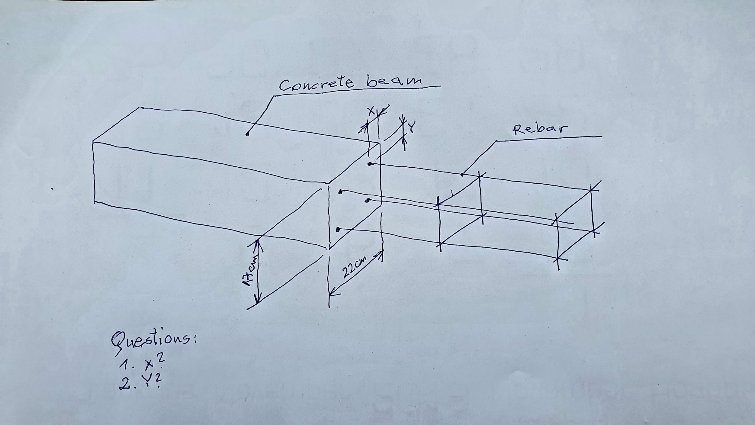

Ok, lets go further with the project. Before that I have something to ask.
I'd be much appretiated if someone might answer a question.
How deep should the rebar be sunk in the concrete as shown in a picture below? I mean distances "x" and "y"?
Thank you in advance.

I'm sorry, my question was probably incorrect. I will need to make that beam of concrete. It doesn't exist yet. But before that I need to know, how should I place the rebar in the formwork correctly.

Minimum cover for concrete is 1.5 inches. That is minimum - more is better. Your decision is complicated by the size of this beam. I would recommend 4cm for ""x" and "y"

Very good. I thought so, but was not sure. I was prepared it'll be between 4 an 5 cm. Many thanks.
