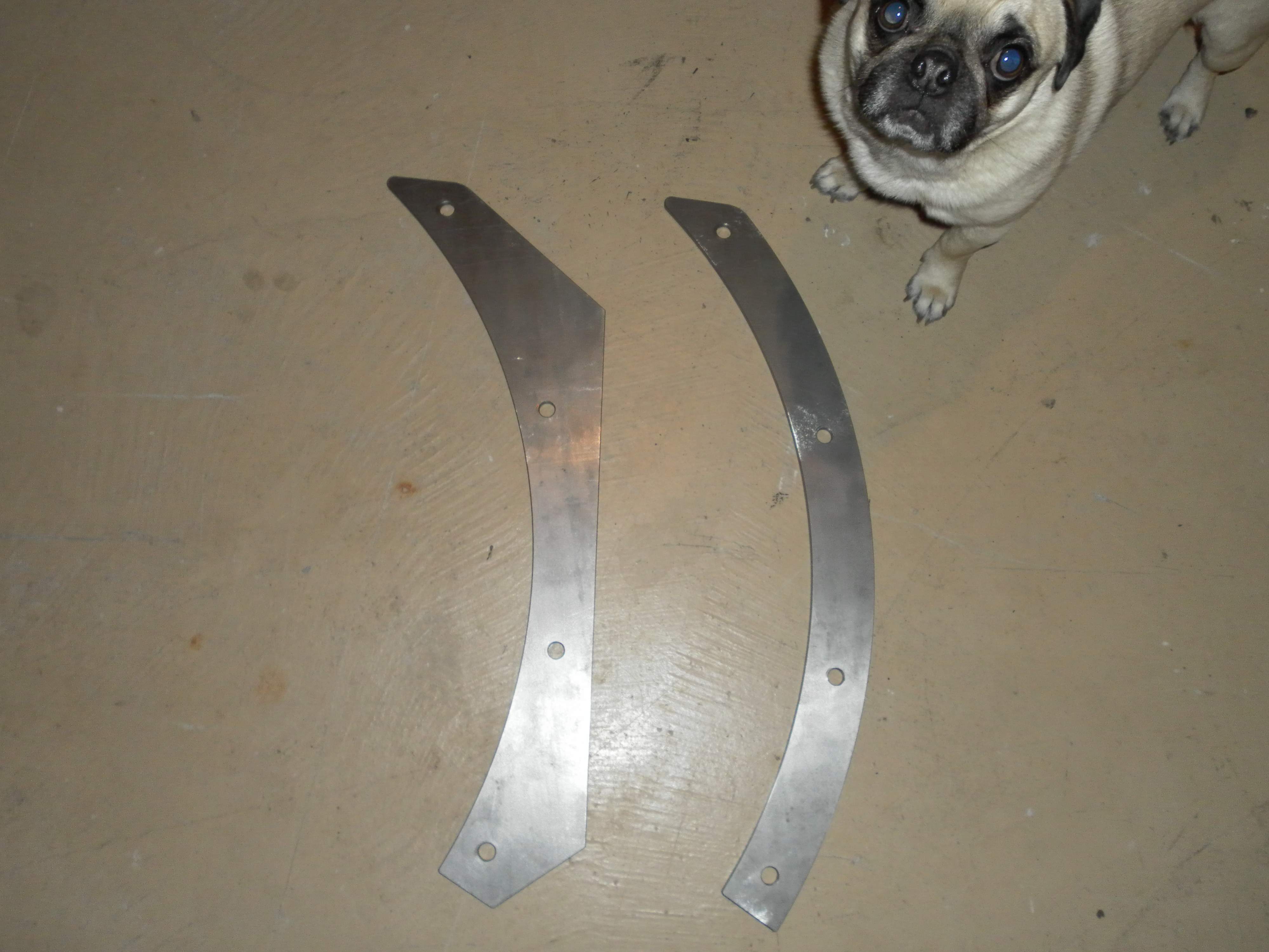

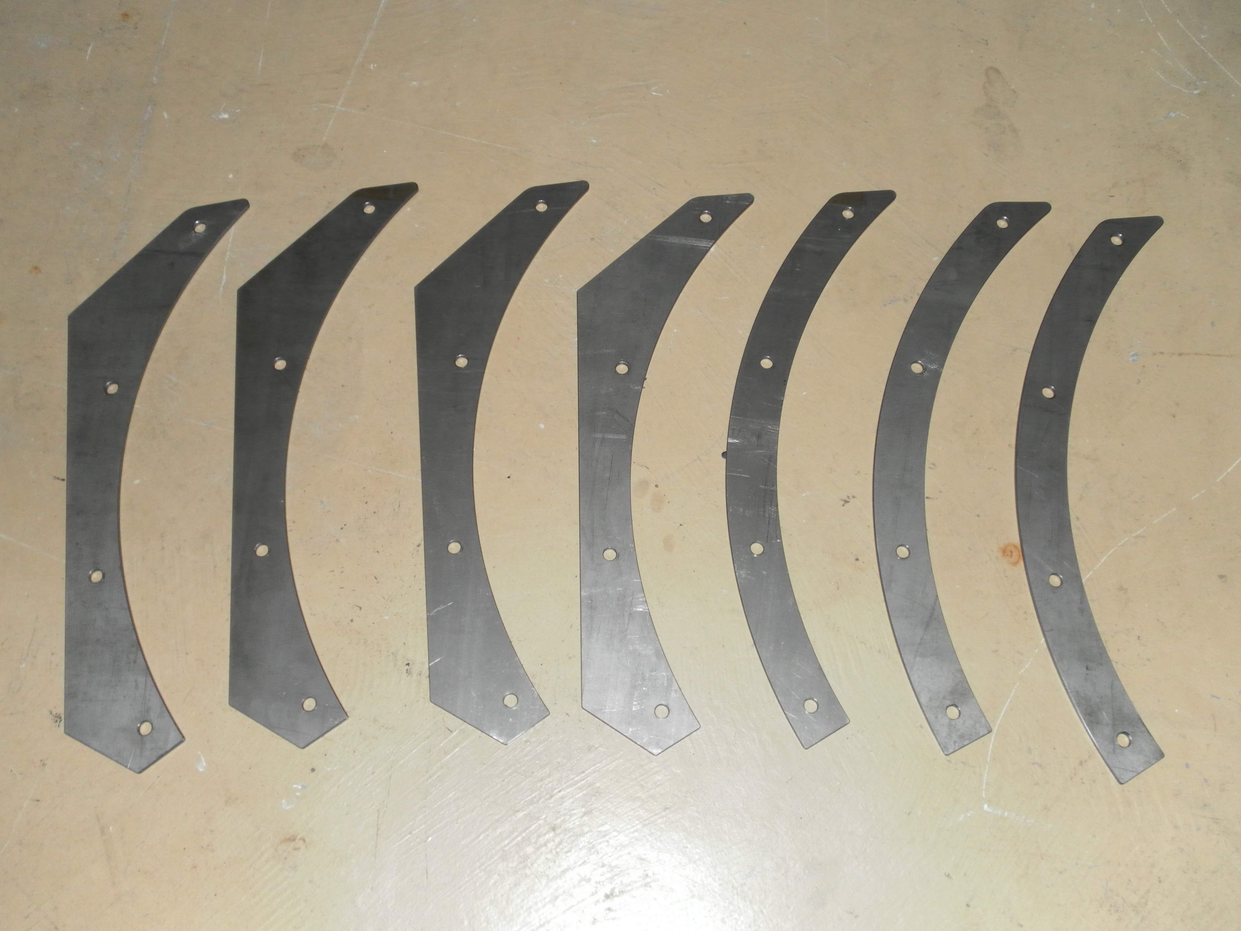

I've contemplated each and every kind of tripping method out there and mentioned by all of you. I basically decided to build a pusher with no sides to start. Its turning out to cost a little more then I anticipated:2cents:. Got some stuff welded up today, should get the moldboard early this week. I'll get more pics up here soon.

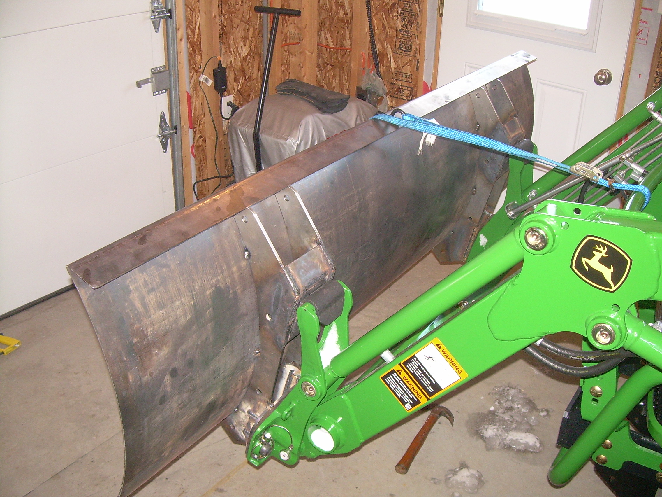

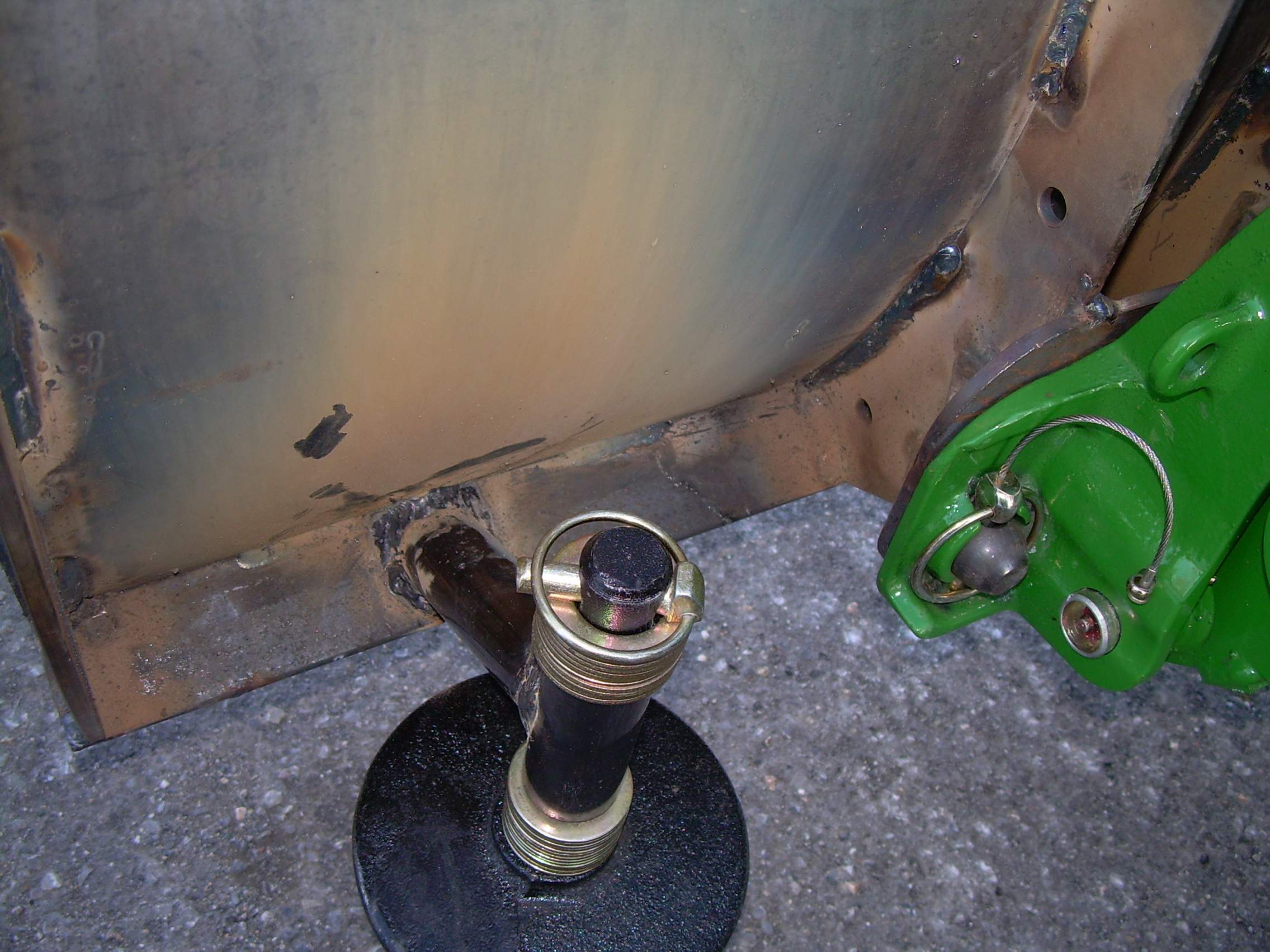

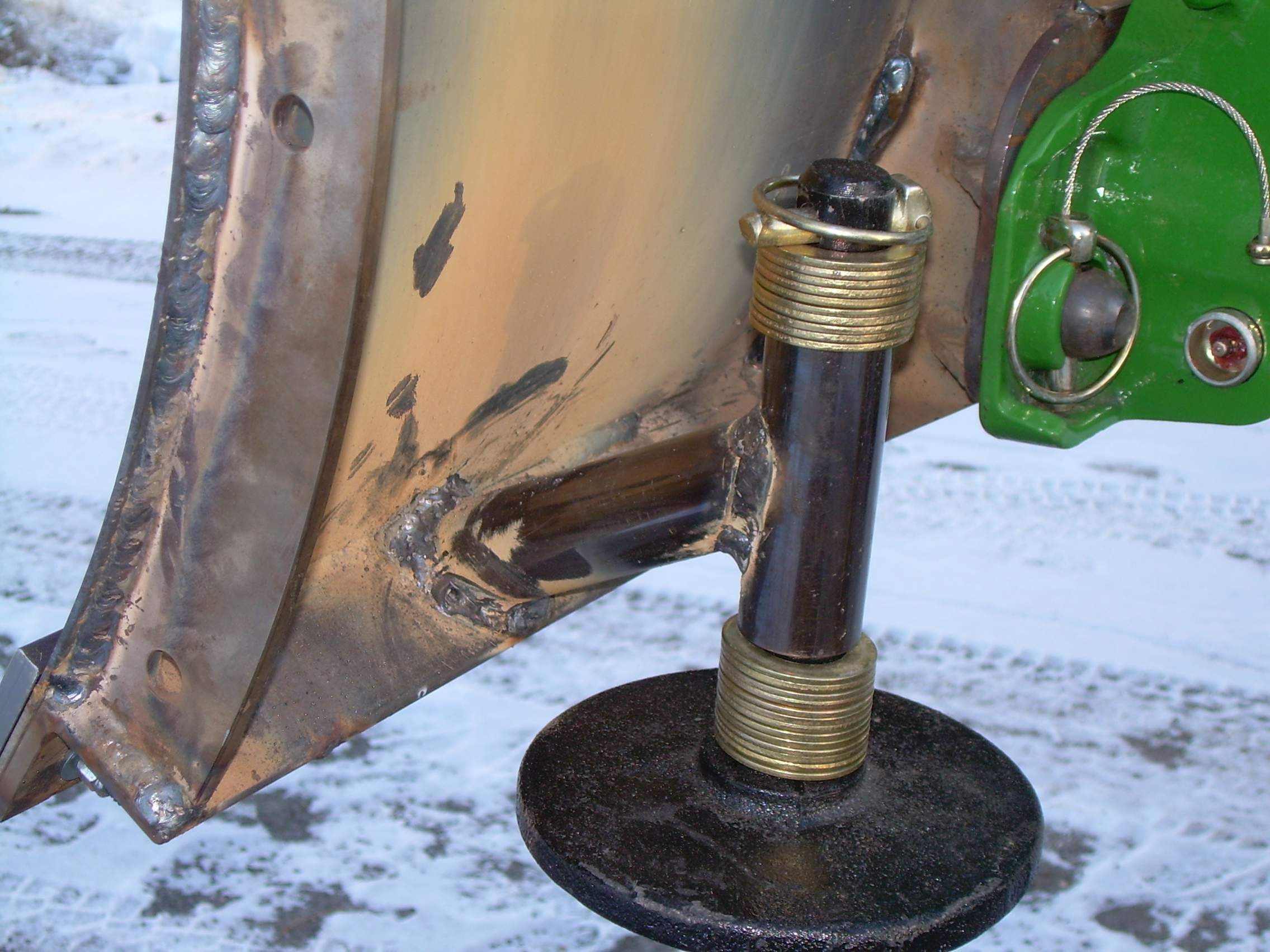

Got the blade all tacked and fitted:). Now its ready to get fully welded up. Here are some pics

   / FEL Snow Blade Build #26
Looks great!

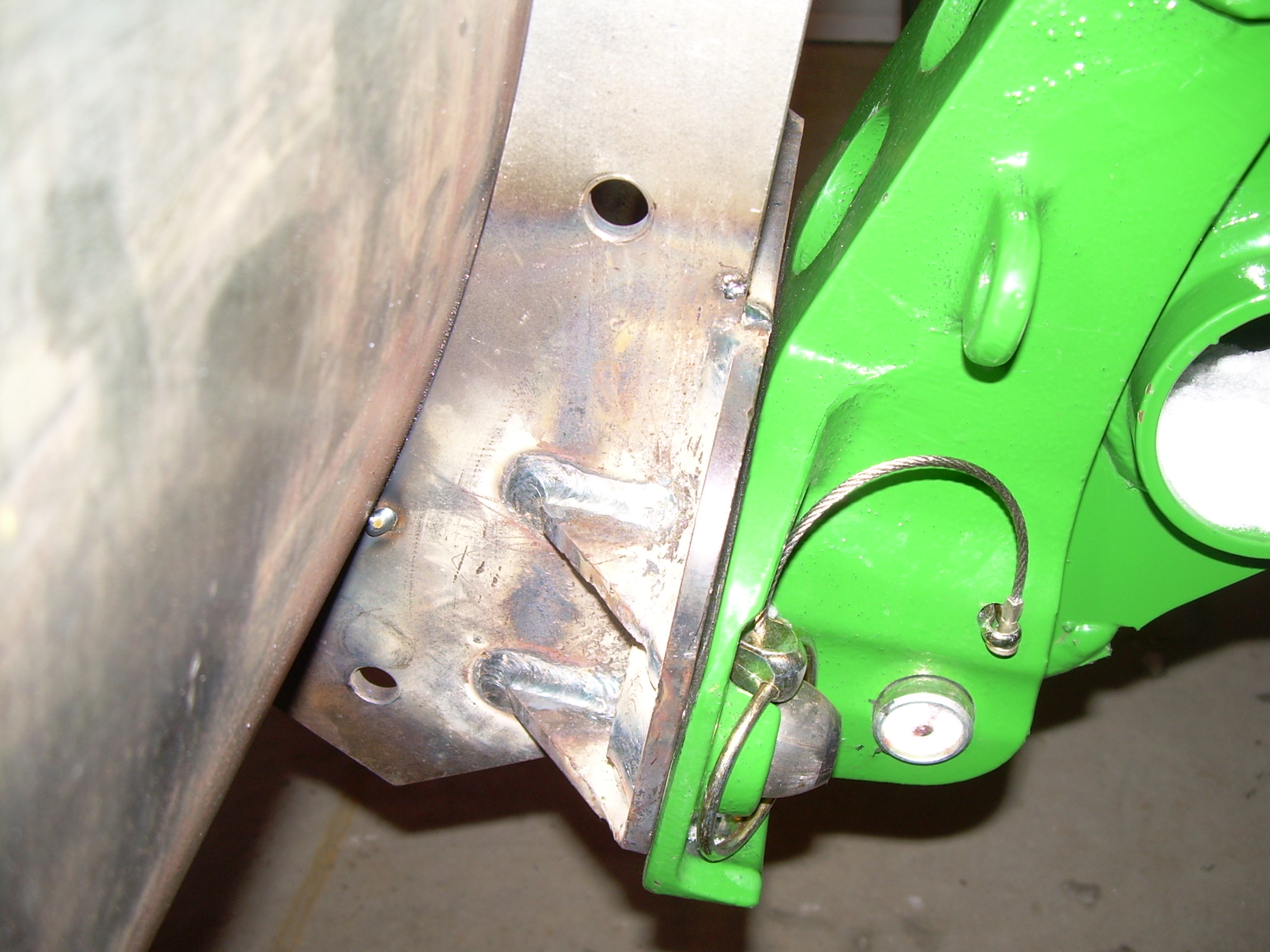

Where did you get the duck bill bucket mounts for your john deere? Did you make them?

If you mean the U shaped hooks for the quick attach.... I bought them from JD. They are around $15 cdn each. The Quick attach Pins were also bought from JD for about $20 cdn each. What are you planning on building?

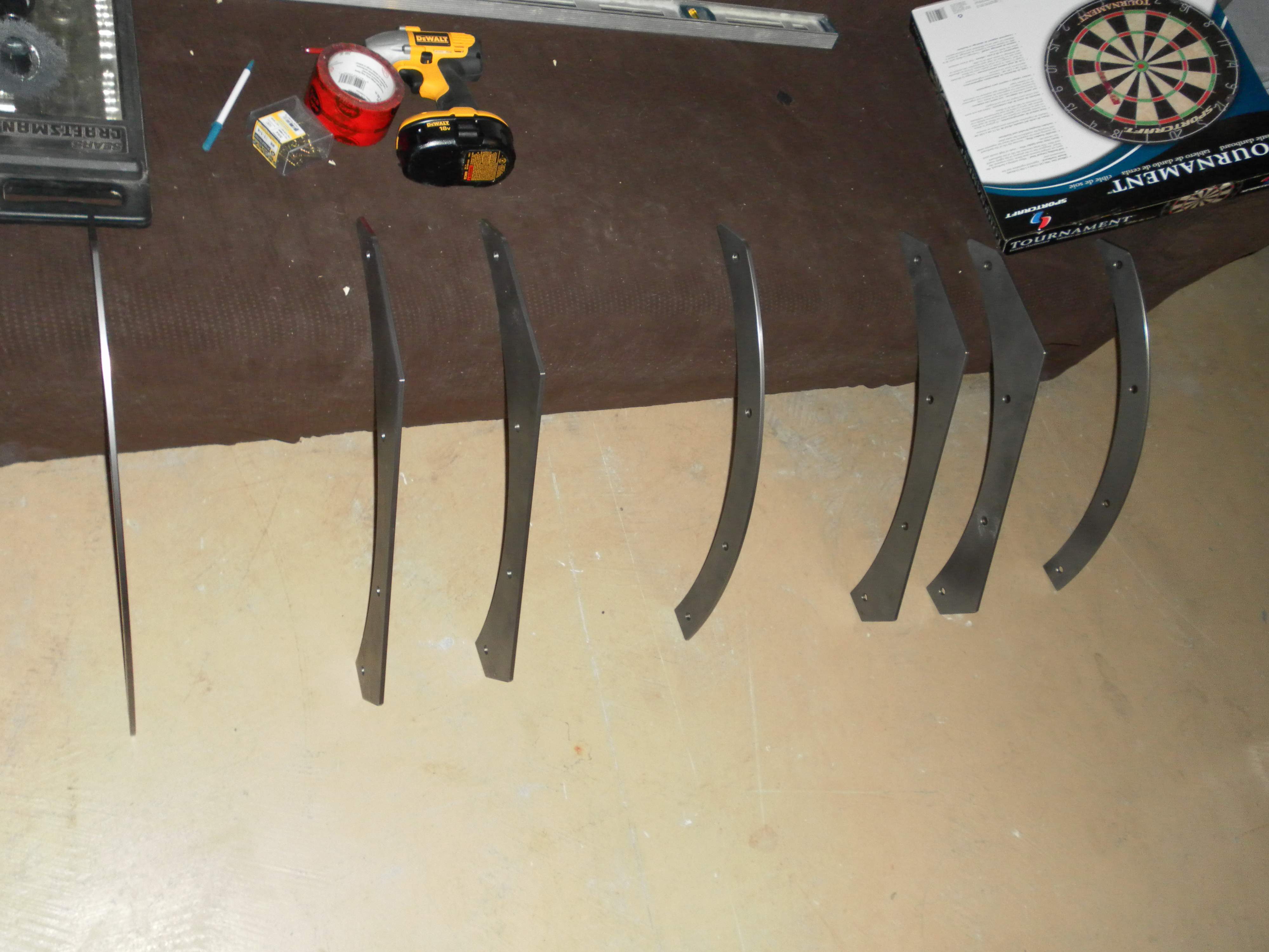

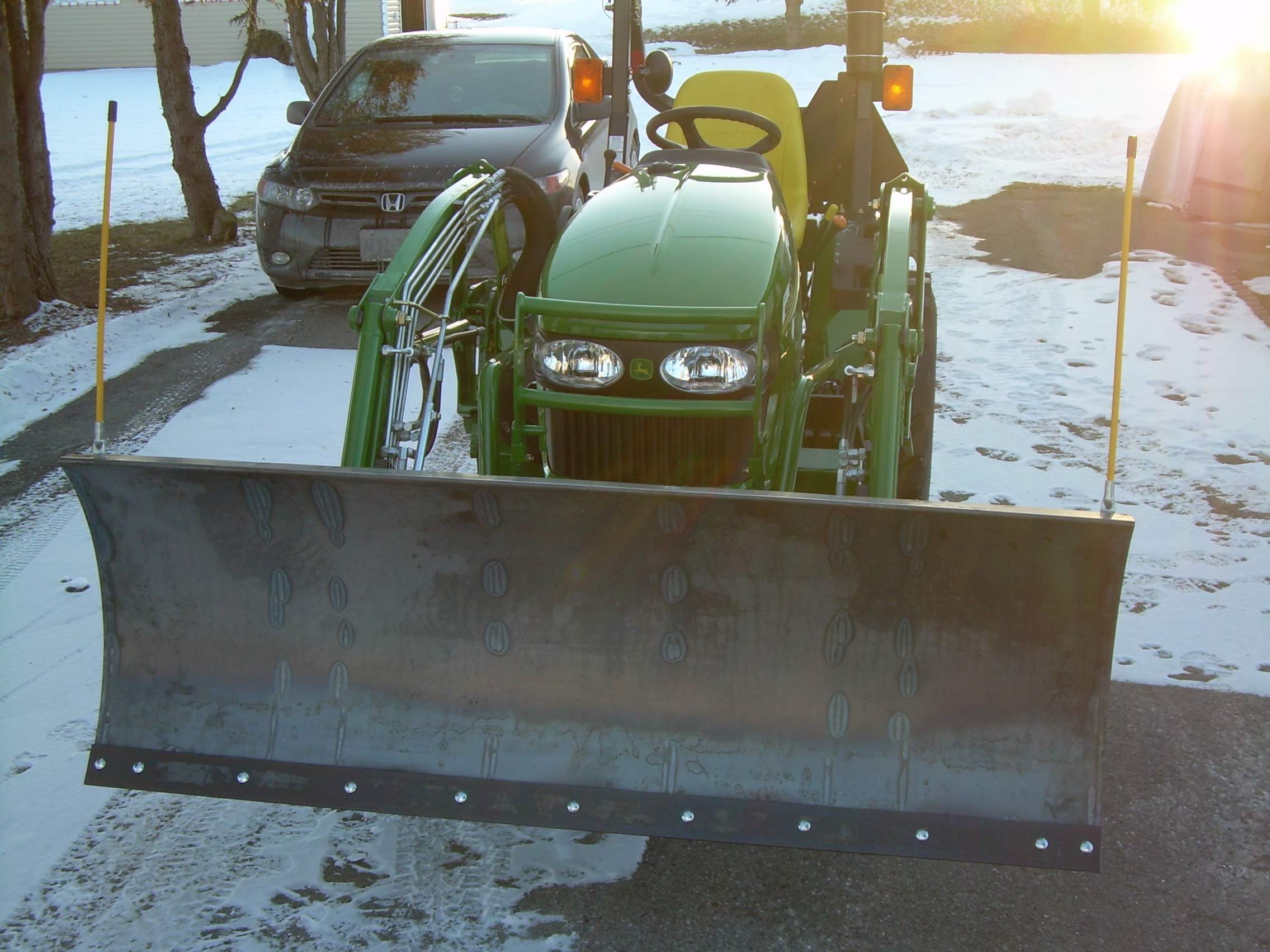

I'll be putting some pics up tonight of the finished blade before paint.:D
Let me know what you all think and if it needs reinforsing anywhere...

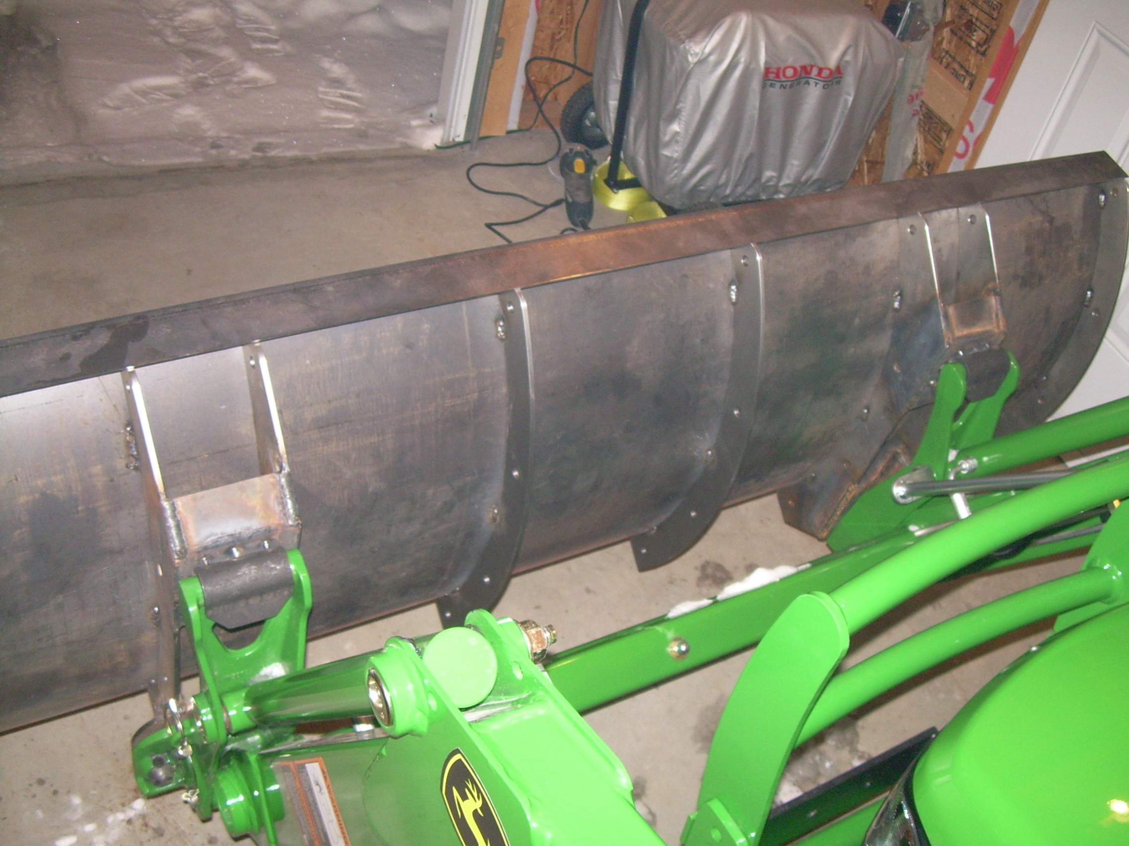

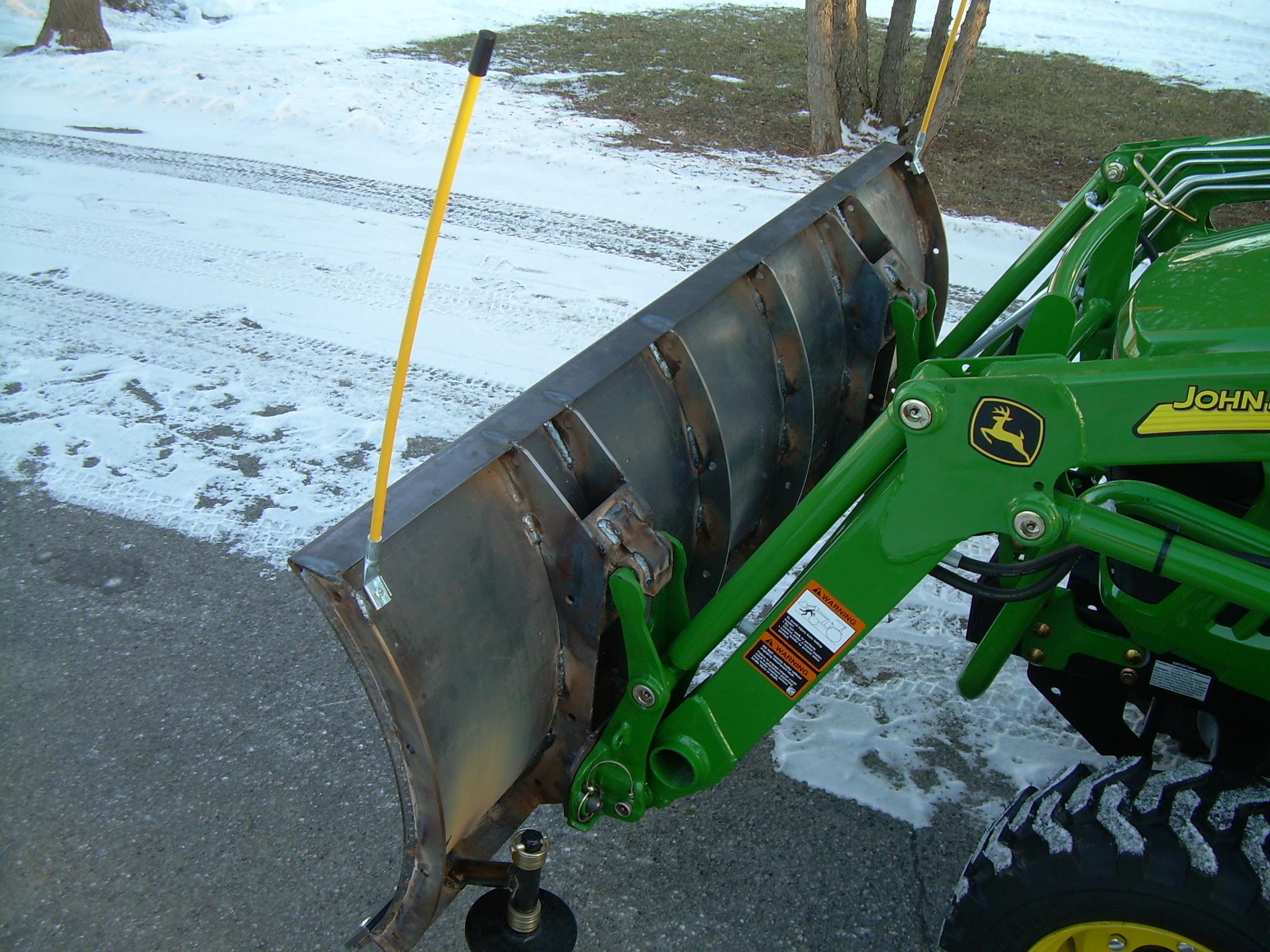

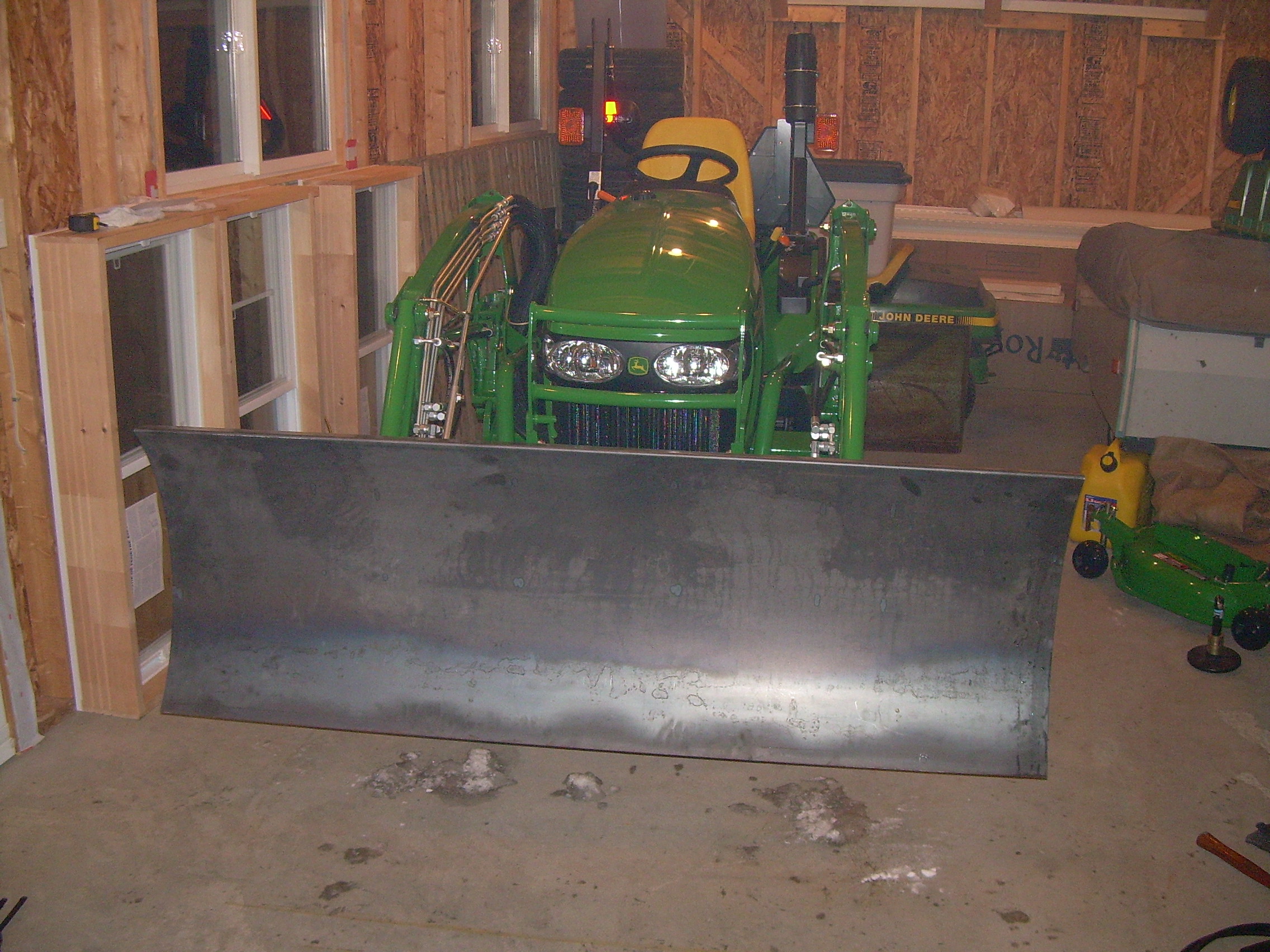

Here are the pics as promised.

   / FEL Snow Blade Build #33
That look really good. Are you going to put sides on it or leave it to be a plow? Just out of curiosity did you use a Mig-welder?
   / FEL Snow Blade Build #34
Excellent job so far. You will want the angle capabilites. Take a look at a BOSS "V" Style plow if you want something serious. With what you have built sides will provide the most bang for the buck. To keep them from bending rebar can be welded from outer edge back to a point 16'' in from edge of blade. This should be about half way between top and bottom of blade. I am making something similar. Just taking a box blade and putting it on the front of a 743 Bobcat. Good luck and continue the good fab work.
I'm not sure yet wether or not I will put sides on it. We will see next winter I guess since we have no more snow here.:laughing: The only thing I used a mig on is the skid shoe mounting pipes, the rest I had a welder weld since I didn't have a welder (I just bought one now) he stick welded it.

#38
I am thinking obout putting small sides on the blade to give it a bit more of a larger sitting surface... It seems to really want to dig into my laneway right know.
   / FEL Snow Blade Build #39
Looks great but if it does not angle you will not have much fun.I have an old homemade one my Grandfarther built from an old fule storage tank .I re-vamped it with a 6" connector arm on one side and a 18" arm on the other to get angle.I built some plow shoes from 2" galv pipe that keeps mine up about 4 inchs with the rest of the shoe frame work.I use this to keep over a half mile of woods road open all winter.Good luck with yours great job.
