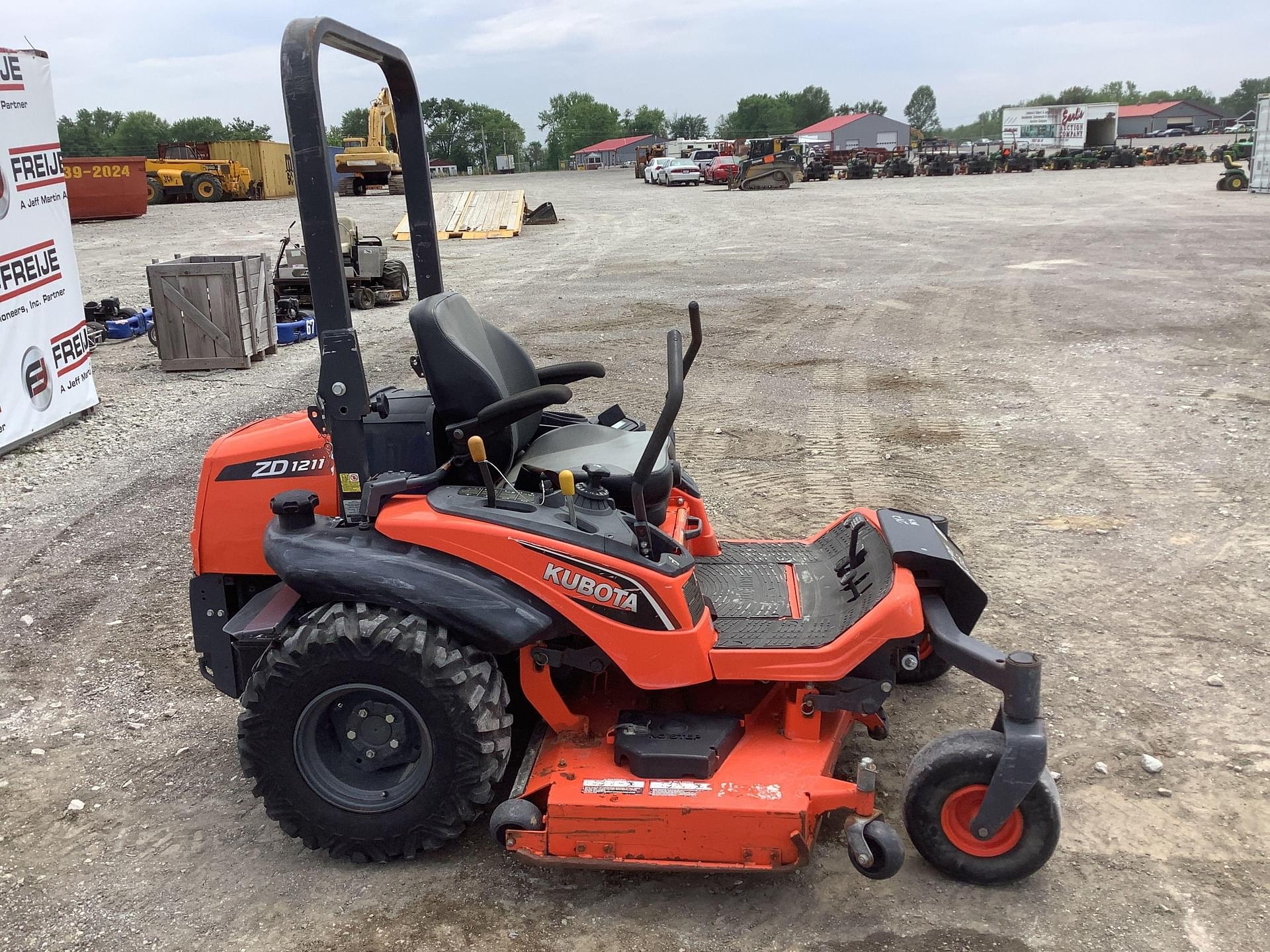

My ZD1211 72 (sold) Bogged pretty bad in thick grass but again I have steep hills & banks here I mow.
It was absolutely fine on flat ground mowing weekly growth.
I don’t like a mower, tractor or truck that bogs lol
The extra $$ for more power is absolutely worth it to me.
The ZD1511 emissions is Fine as long as they have the newer calibration in them & the newer ZD1611 is Fine too.
No problems on either one here mowing 20+ acres a week on my farm.
Way better mower than JD Scag or Ferris imho.
I just wished they offered a 84” deck.
You don’t want a RD deck especially if your grass is thick and / or tall : it’ll windRow TERRIBLY.
They cut exactly the same but clippings dispersal is knocked down by the wide tires & the radiator will suck dry clippings up & run hot every 2hrs.
Don’t buy one imo
Correct. exact thing happened to me. I purchased a brand new ZD 1211 RD and during my first use it overheated - alarms and lights...I mowed for about 4 hours and it overheated about every hour. dry grass just gets thrown right on radiator - took it back for an F3710 - mowing field type stuff...

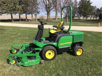

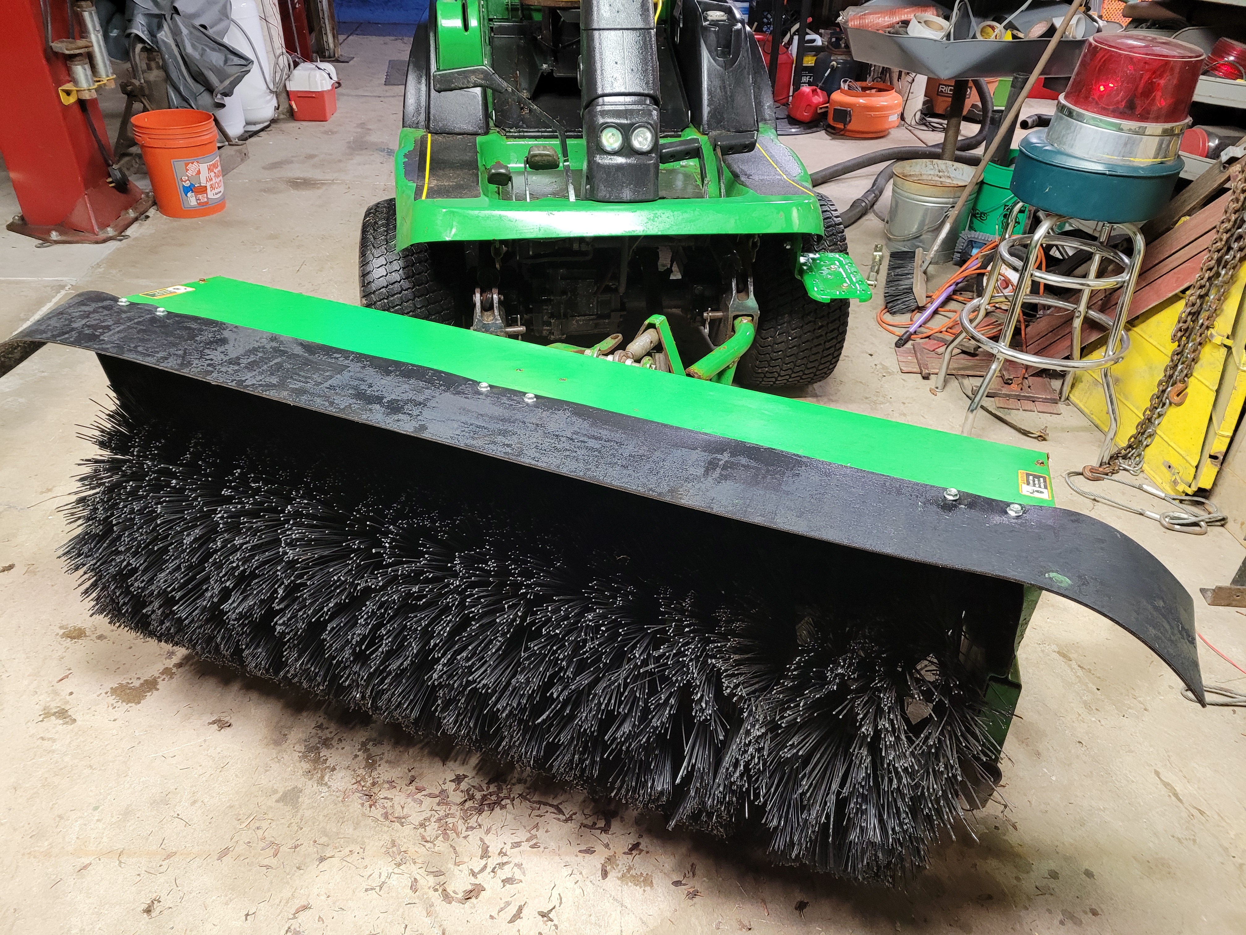

I bought a used JD 1435 diesel front mower side discharge 7-iron at a local Metro Parks auction $2500. Yanmar motor. Starts on the 2 revolution even after sitting for a few months. Found a 60" front rotary broom for it and I will NEVER use or need a snowblower, plow or pusher again, and I've tried all 3 before getting a broom. The driveway is spotless after brooming snow and is dry in 1 hr. I can spray the snow even from 10" drifts as far out as I want or need to using rpm. And it does all this at 15 (measured) mph. The motor isn't even warmed up when I'm done.
As and added bonus, I bought a 3:1 gearbox with a 540 pto stub on it and can run my 45kW Winpower PTO genny off of it. The 1435 is about 22hp so its 11kw potential is plenty of electric power for us. I also still have my F935 earlier version of the 1435. It can also run the genny and a 76" rear discharge deck for chomping thru high field grass, weeds, trees, woodchucks, and whatever it chooses to munch on.
