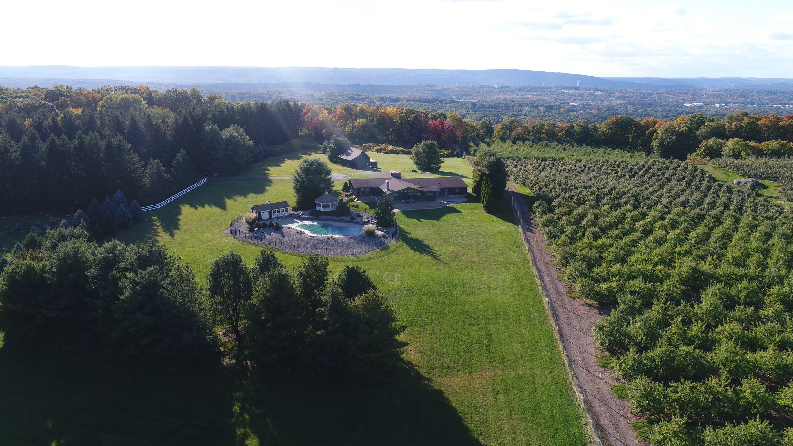

Have been doing a ton of research regarding f series vs zero turns. Right now mowing with a John Deere 770 with 86” finish mower.
I have about 5-6 acres to mow. I’ve been leaning towards a f series because of its versatility. But I read that they are slow and rough compared to a zd zero turn.
I don’t have many hills but I’m struggling to rationalize 20k on a piece of equipment that only does one thing. At the same time I don’t want to compromise.
I have to imagine both machines would be faster than my current setup.
Any feedback is appreciated.

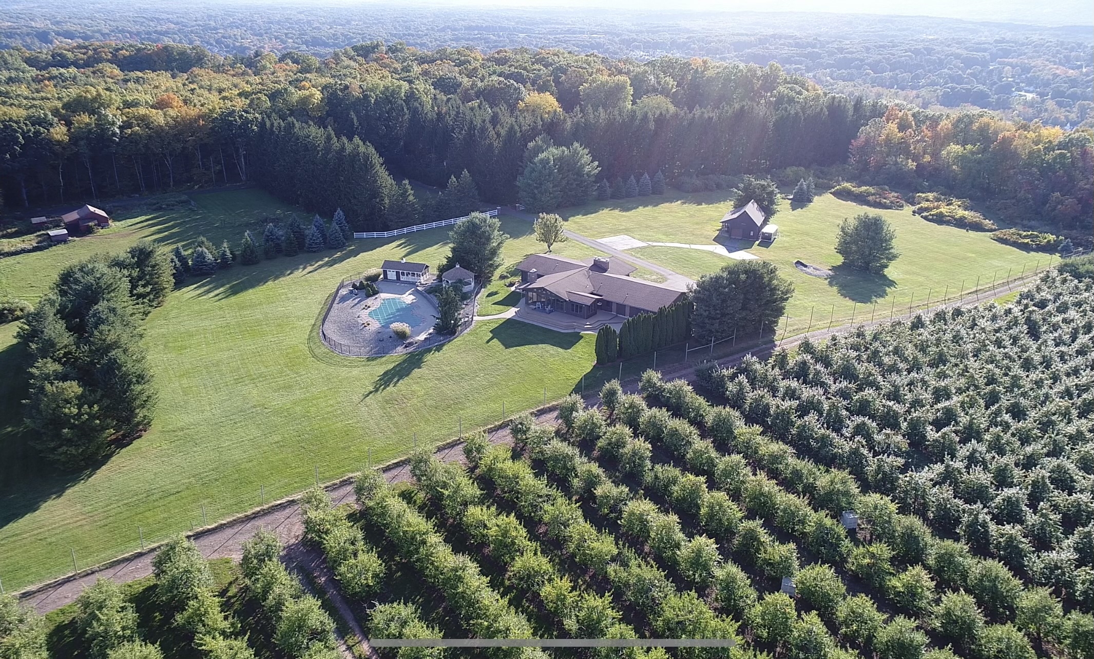

Here are some more aerials of the property. There are some obstacles. But not a ton.

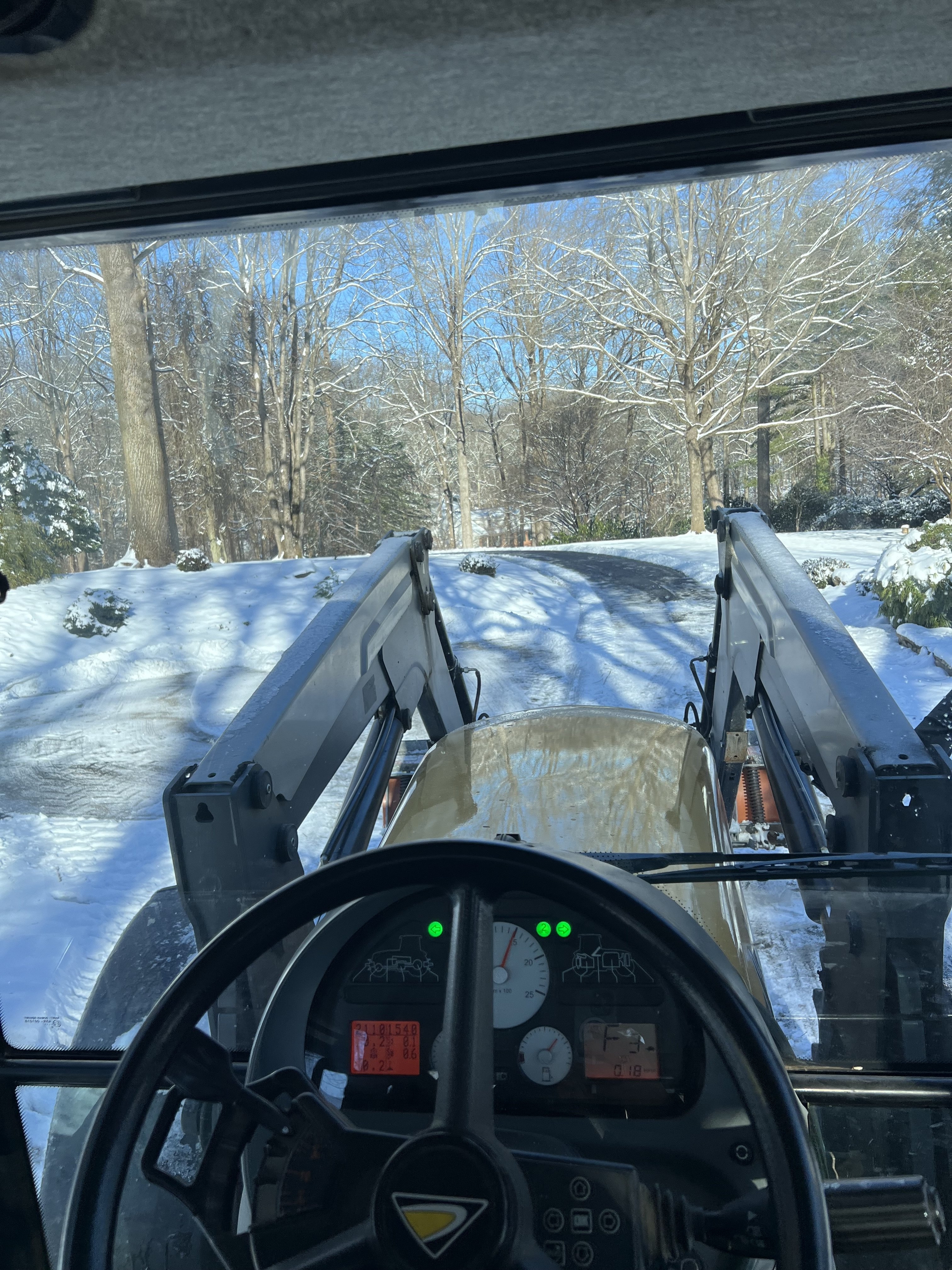

I am in Connecticut. So it snows. Not a ton…but I have to be able to remove it. Our driveway is a hilly 3/4 mile long.
Right now I use a 54” rear econor blower. Driving it backwards blows 🤮
It does not have a quick disconnect for anything. It’s an older tractor so finding attachments and implements is a challenge.

Meh……you’d be surprised. I plow snow with a 135HP Challenger with a plow mounted on the loader and it’s very maneuverable.

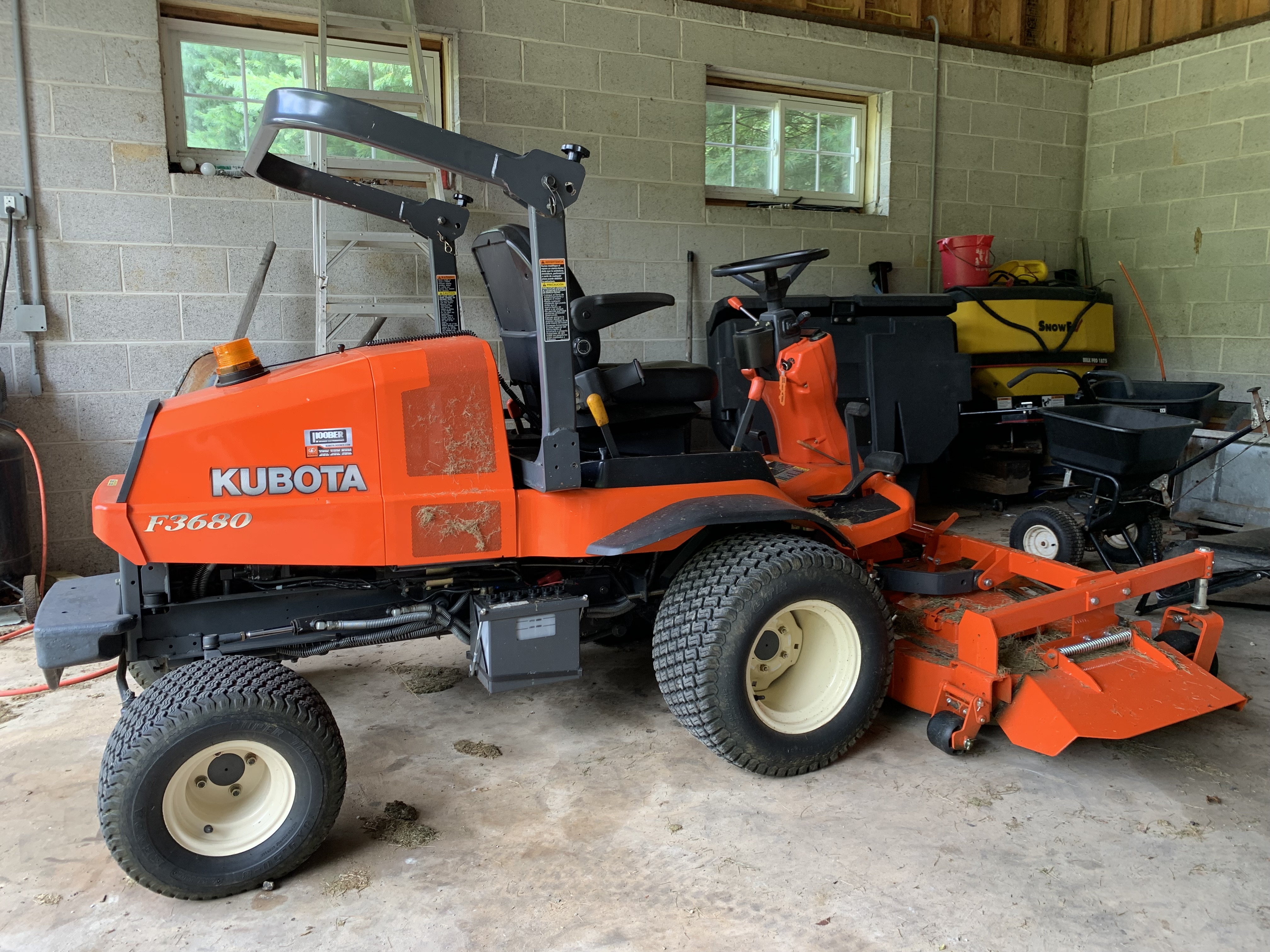

Here’s my F-3680. I sold it last year and bought 2 ZD-1211-72”

When you mowed with the f3680…did you mow in low or high gear? Also what rpm?
Based on f series user manual high rpm low gear is 5.5mph…which is already faster than my current setup.
Max rpm and high gear is 12 mph. I don’t think anyone is mowing at that speed.
/ F Series vs. ZD #16
I've had both, and fully agree with HayDudes early post.
Remember anything with "lawn mower" size tires is going to ride roughly if you go fast enough.
If I had to generalize the difference between the F and a Z, think about what vehicle you drove in your 20's and what (and how) you drive now.😆
The Z is a hotrod
The F is a gentleman's vehicle.
/ F Series vs. ZD #17
High range, unless on very steep ground. The problem with low range is that the foot throttle becomes very touchy.
Overall, the ride is challenging because the foot throttle can be a mess when going over bumpy ground. A ZD-1211 is much smoother because it has twin sticks. Honestly, I think the F series looks better on paper than it performs in the real world.
Also what rpm?
Full throttle
I ran high range full RPM, but at 5.5MPH, I would be thrown out of the seat on a bumpy lawn. The problem is the small tires on the back flap up & down over bumps harshly. It sort of “bucks” like a bronco on rough ground. It also has a steering wheel which is very touchy on bumpy ground.
No, definitely not. 12MPH is reserved for transport over pavement.
