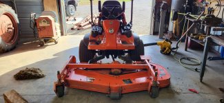

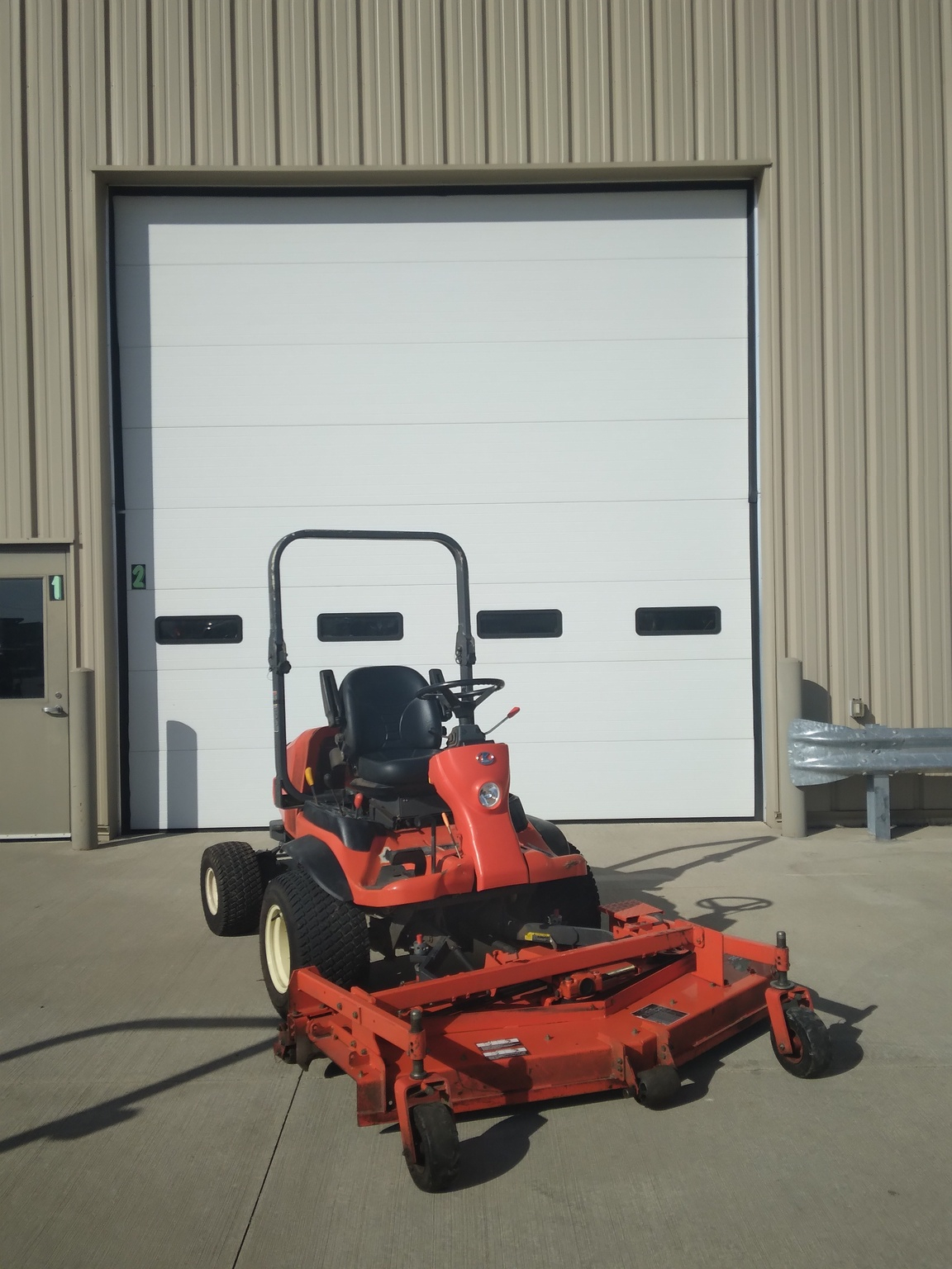

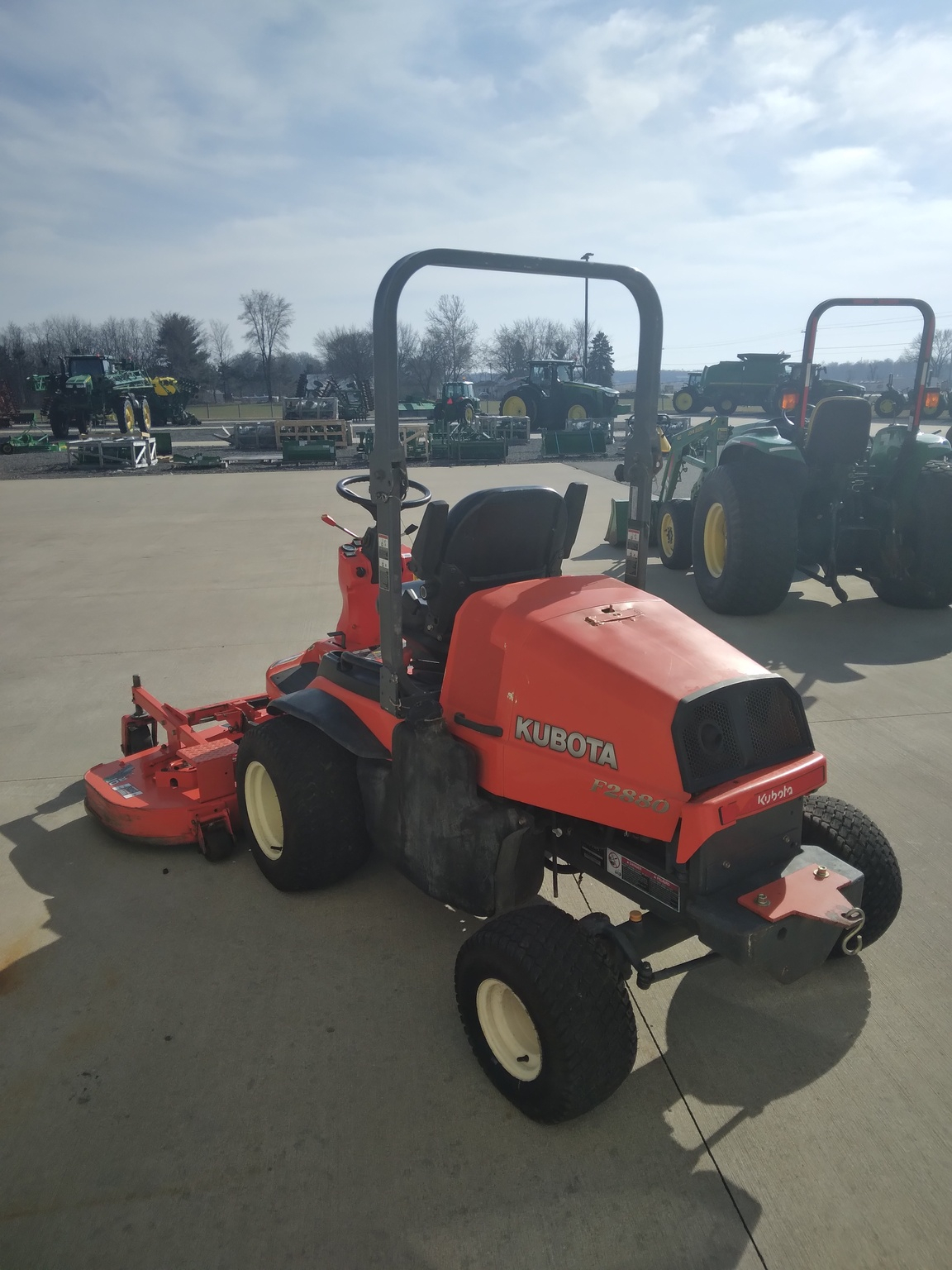

Well, the title says it all. I plan to share my story and experience with my F series. This is my first out front mower. Brought home on 3.31.23
Some of my mowing history:
Kubota BX 60" MMM 2008 to present
Kubota GR2120 2021 to present
Kubota Z726X 60" zero-turn for two seasons (sold)
I've operated several other zero turns and mowers owned by others over the years, but never a front mount. Deere 455 and 757, a few Bad Boy zero turns, and I have demoed Grasshoppers. I prefer a steering wheel and pedal over levers so I will sacrifice some maneuverability for that.
This F2880 machine was bought new by a park service and traded into a Deere dealer with 2300 hours on it.
Repairs needed, etc.:
-Front lift arms are bent, so deck is angled slightly to the left, i.e. the left side is about 2" from the front tire and the right side is about 5" away.
-Hood lower plastic piece is broken
-Suspension seat adjustment knob is frozen, will not turn by hand
-New blades needed
-Anti scalp rollers are in bad shape
-Missing deck belt guards
-Missing deflector shield, I may build a block off chute
I plan to flush the cooling system and change all fluids and filters. I will also clean the exterior of radiator. I am debating if I should remove the fuel tank and clean it out good just to be proactive, it is nearly 20 years old, there could be some buildup.
I prefer to adjust the mowing height on the fly, from the seat if at all possible, so I will be entertaining fabricating a mechanism to accomplish this, if anyone has ideas please post them.
I have read through just about every F series post on this forum which only affirmed my decision to purchase one.
Sorry for the long post, just trying to document properly. Any advice is appreciated!

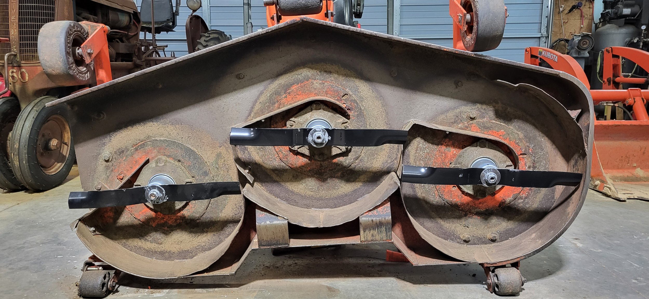

The baffles under the deck are beat up. I don't know if they are required or not, can someone provide some insight?
/ Walker's F Series Thread #5
Walker,
Another member on the forum is very knowledgable regarding these F-machines. Arto98607 is his user name. He has an extensive thread concerning the gearboxes and their parts.
Also, there is not much capacity for gear oil in these boxes, so be sure to check often until you can get it taken care of. My brother in law ruined a debris blower gear box on his Kubota F mower last year before he realized the box was dry!
Concerning the baffles, I assume they are designed to help with efficient discharge of clippings. My baffles are in very good condition, but a prior owner installed a plate at the center rear of the deck and rubber flaps on each end of that plate to inhibit discharge. I assume this was to help keep the chaff out of the radiator and engine compartment. I understand the rear discharge decks do a good job of spreading the discharge evenly behind the deck, at the cost of heavy accumulation of debris on the radiator screens and on the engine.
I am going to remove the plate and rubber flaps sometime and see how it works. As the deck is set up now, heavy cutting leaves a clumpy mess behind the mower, which I do not care for.

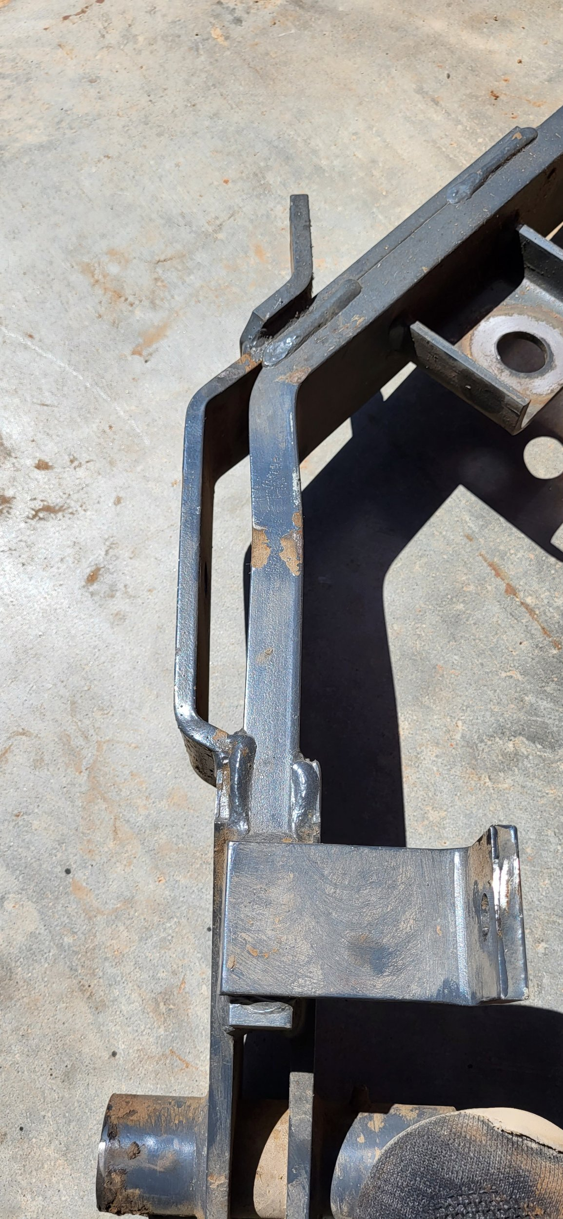

I just got off shift yesterday (7 12s), so today I pulled the lift arms off, straightened them in a press, and re-installed. The deck is now square with the machine.
I installed new blades and dust covers, and blew the machine off really well while I had it lifted up and the front wheels off.
I took the baffles off and beat them straight again and reinstalled.
Greased everything I could find. The seat suspension knob loosened up and I was able to make the proper adjustments, feels much better now, I guess it just needed jostled around a while.
I topped off the gearbox and ran it for about 15 minutes, I don't see much gear oil like before, so I'm proceeding with caution and will check it frequently. I have a seal ordered and it should be here next week.
To do:
-Rebuild front castors, need pin and bushings for swivels and also pin and bushings for wheels.
-Replace guage wheels and pins
-Replace all fluids
Pictures of arm is before straightening.

On the left side there is 4.25" between deck and tire and 4.5" on the right.
