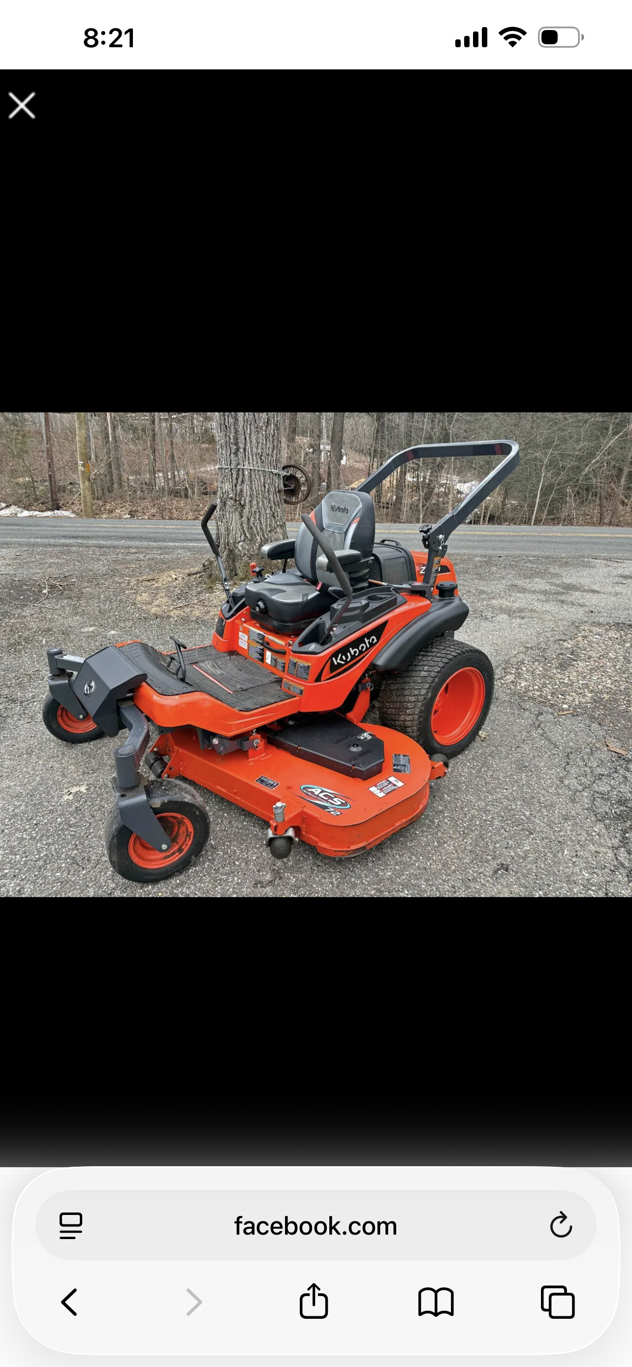

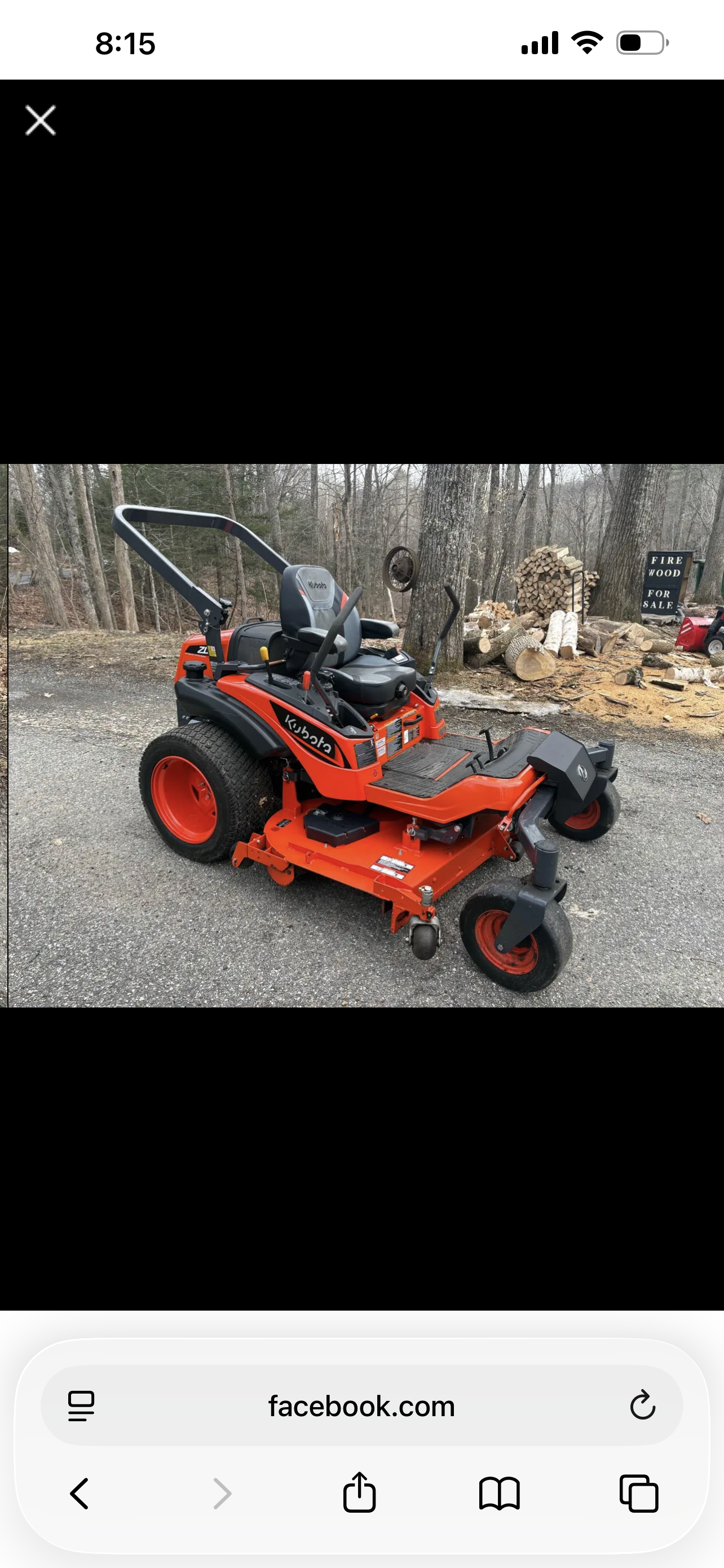

End up putting a deposit on the machine I went to see today. It’s a 2022 zd1211 72” with 100 hours. The gentlemen was asking 14,200 I bought it for 13,000. I thought it was a good deal.
