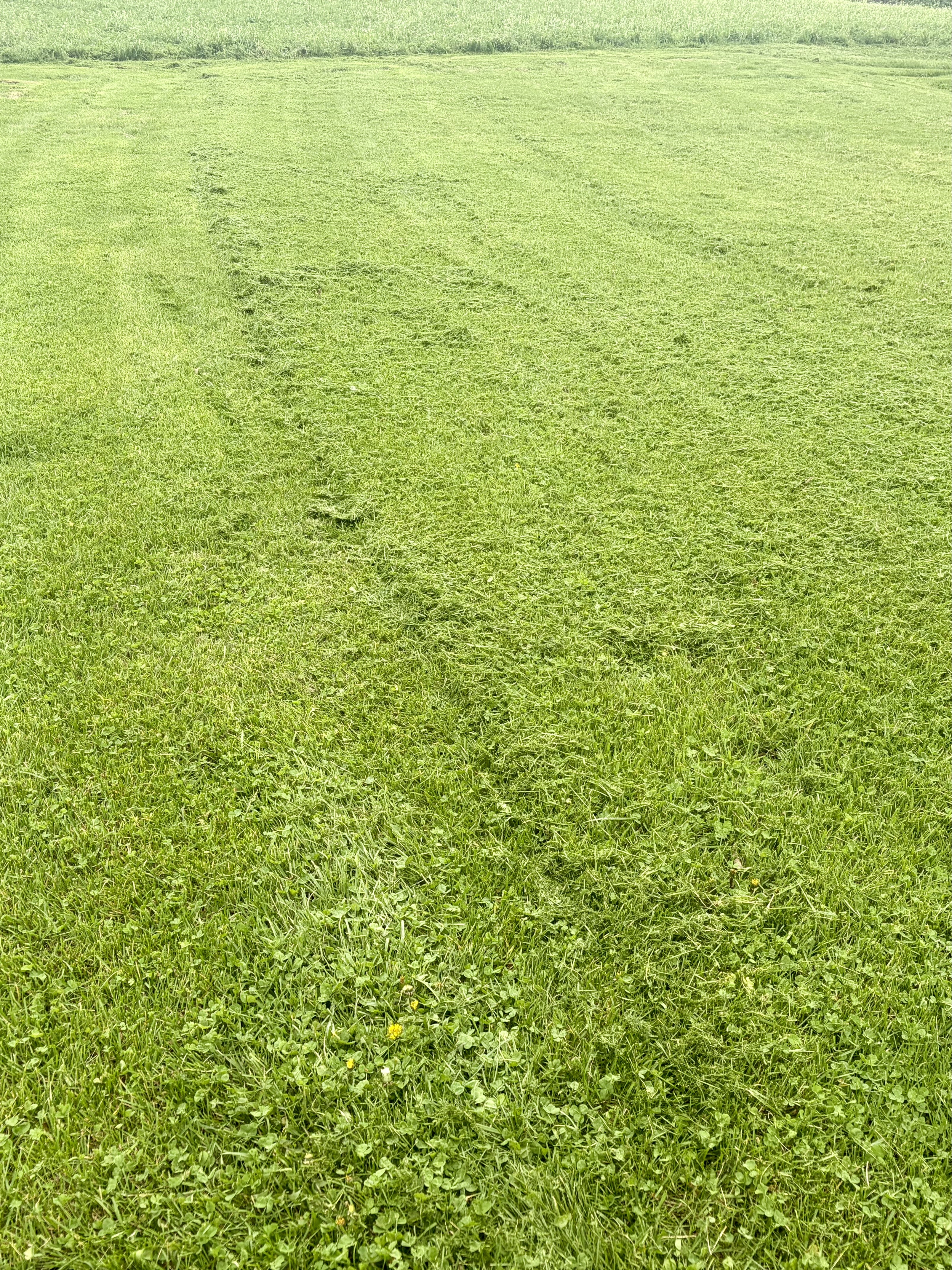

I run with my discharge chute open except when I am mowing a cemetery, when I have most of my problems is around late June to July when we have what people around here call water grass , which in my opinion is basically crab grass . The water grass was so bad last year you could have a perfectly clear day and your mower wheels would run wet all day. Height I mow is usually 2.75, and I now run copper head after market blades which are not perfect but do a better job than the Kubota blades. Basically when I have a problem I mow , trim and then run over the problem spots a second time with my deck partially raised.

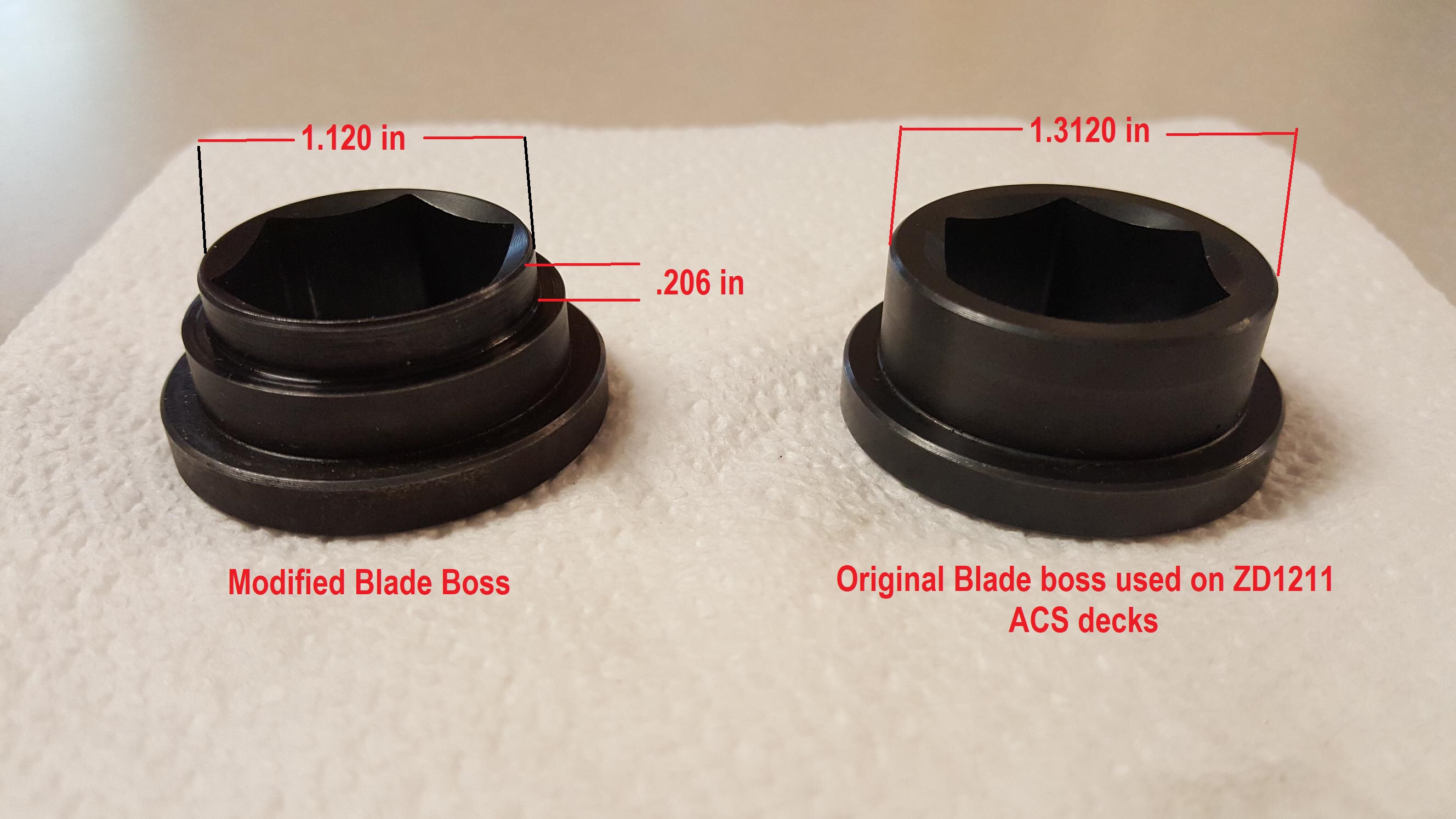

Wet crab grass is challenging here also. Several of my lawns are mostly crab grass, and they generally get mowed in the afternoon at the end of my day. If you have the time and inclination, running a blower over the lawn knocks a lot of the water off the grass blades and results in a better cut. You could also raise the deck for cool season grasses (tall fescue, etc) to around 3.5-3.75" and see how it does.
I really like the Oregon G5 or 6 Gator mulching blades year around. Downside is that you would need to modify the blade bushing to use them on your side discharge zd1211 (last checked there wasn't a Gator blade with the larger center hole for the 1211 side discharge).
/ F Series vs. ZD #167
I’m think you are correct raising mower deck height would help, unfortunately most of the mowings I do are farms, and they typically like a shorter cut. As far as gator blades are concerned you are correct, they do not make a blade for that size center hole yet
/ F Series vs. ZD #168
Here's the modified bushing that will allow the use of the Gator blades if you are interested. Credit to a user here on TBN from 4-5 years ago, unfortunately I don't remember who to give the credit to. I have been using them for the last 2000 hours.

Thanks, out mowing this afternoon, this is an example of what I am talking about. I have mowed 2 hours since blades sharpened and deck cleaned

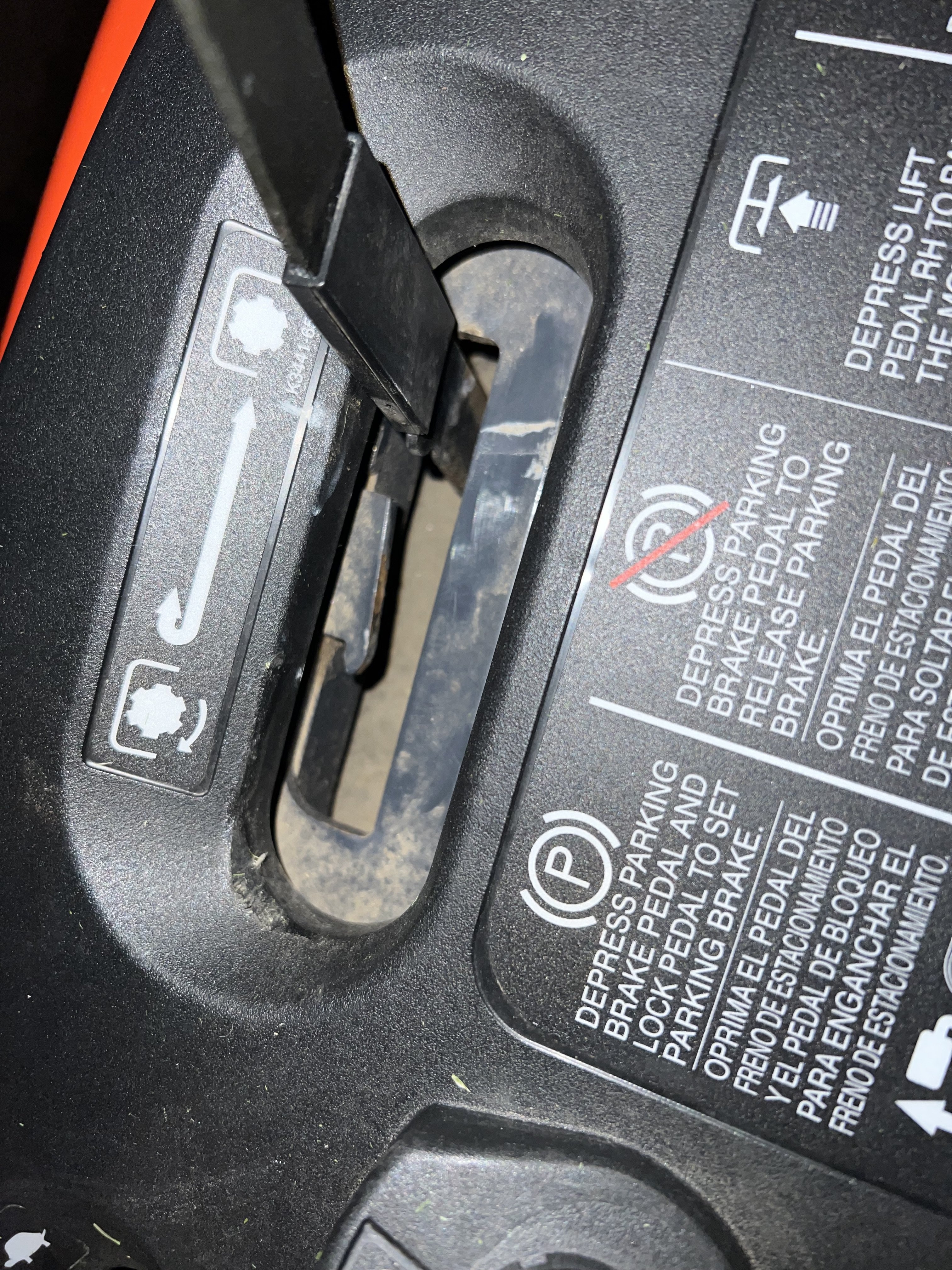

I don’t have many. The hose clamps loosening seems like a systemic problem. Mine were loose and leaking coolant. Seems like others have the same problem. The shift lever for the PTO is awful. I took a picture. The lever is incredibly flimsy and the notch for engagement is so close to the plastic. I have a hard time engaging it. I’ve looked at pictures of other units. They suffer the same problem. I saw a brand new unit in the show room. They seeemed to fix the issue but not sure why it’s like this to begin with. Some of the grease zerks are not placed well. Getting to some of them is difficult. Not a huge fan of the neutral and e brake setup. Its way more complicated then it needs to be. Placing the levers in neutral should be the e brake. Like on most other units. The area for a tow hitch should be a little beefier. I’m surprised it’s not better built. Unit is not as snappy in the corners. Which is expected with the weight. The digital read out should have rpm. That’s a little disappointing.

I cut that little plastic cover off of the pto lever, and it works fine without it. I agree that the dash should include an rpm indicator.
Glad to hear that you're enjoying the zd1211 !

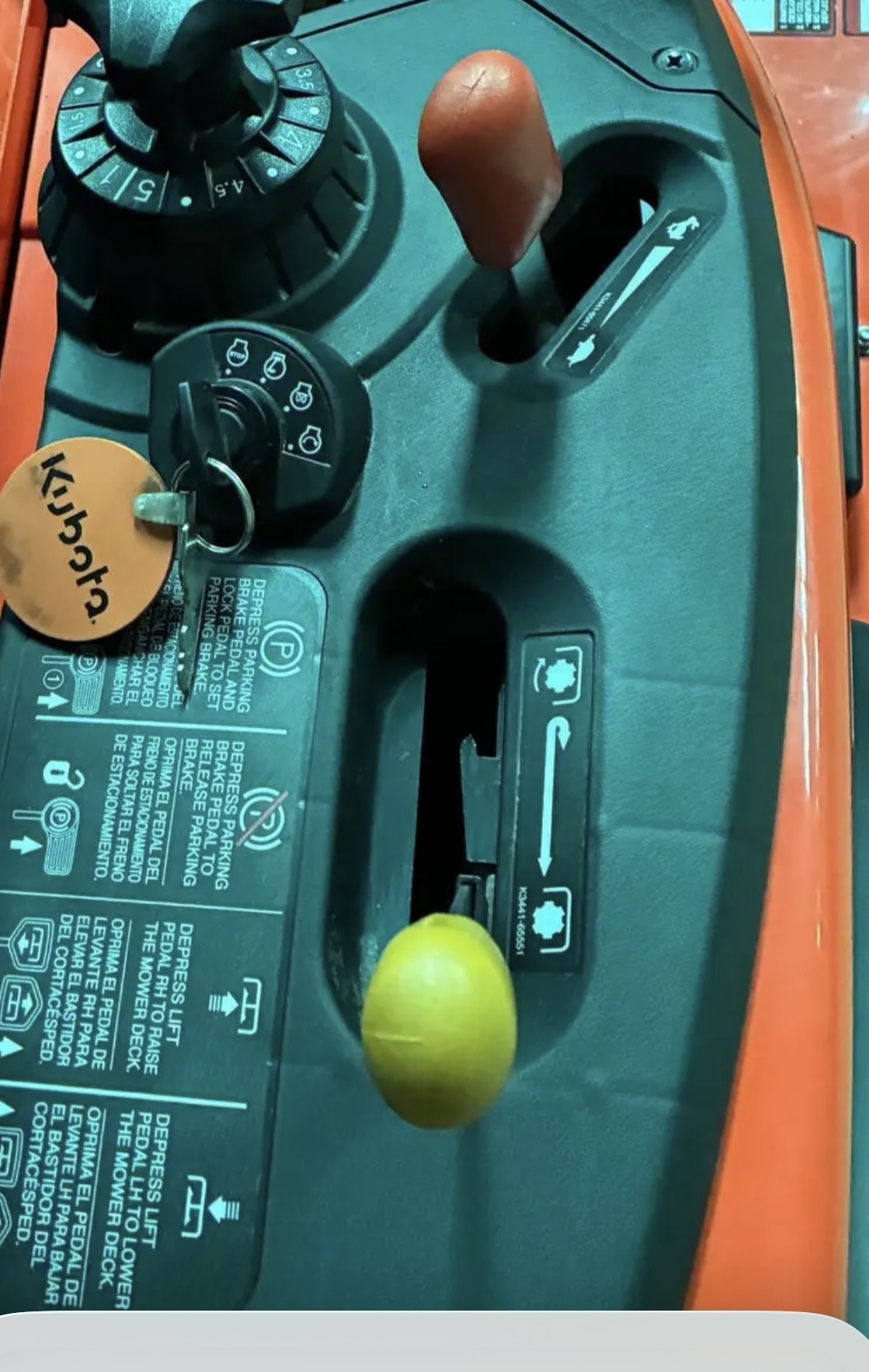

I opened my unit up today to see if there were any adjustments I could make with the bracket. I didn’t see anything obvious. Unfortunately.
I did reach out to Kubota. They said the bracket was recently re-designed because of the issue I stated. They made the notch wider from 3 mm to 5 mm. This centers everything better. It’s a $130 part if anyone wants to do the replacement.
Otherwise I’ll have to deal with it. The new ones look like this.
