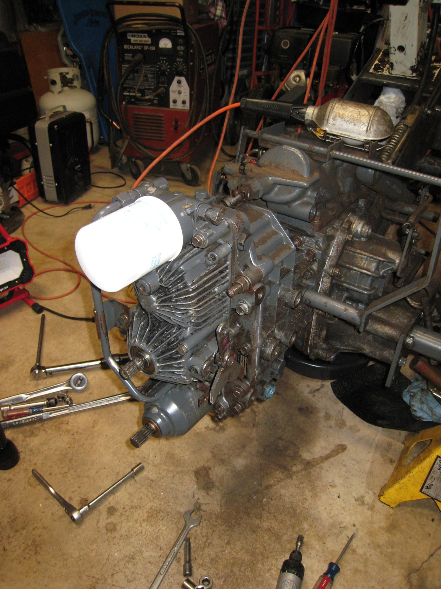

My F-3680 has had a minor hydro leak that just became major from the swash plate / trunnion shaft left (solid) side support cover plate. Would be simple fix, but tight access/visibility inside the frame. Has anyone dealt with this in F-series or other B/BX machines and have any tips??

Hi Rip,

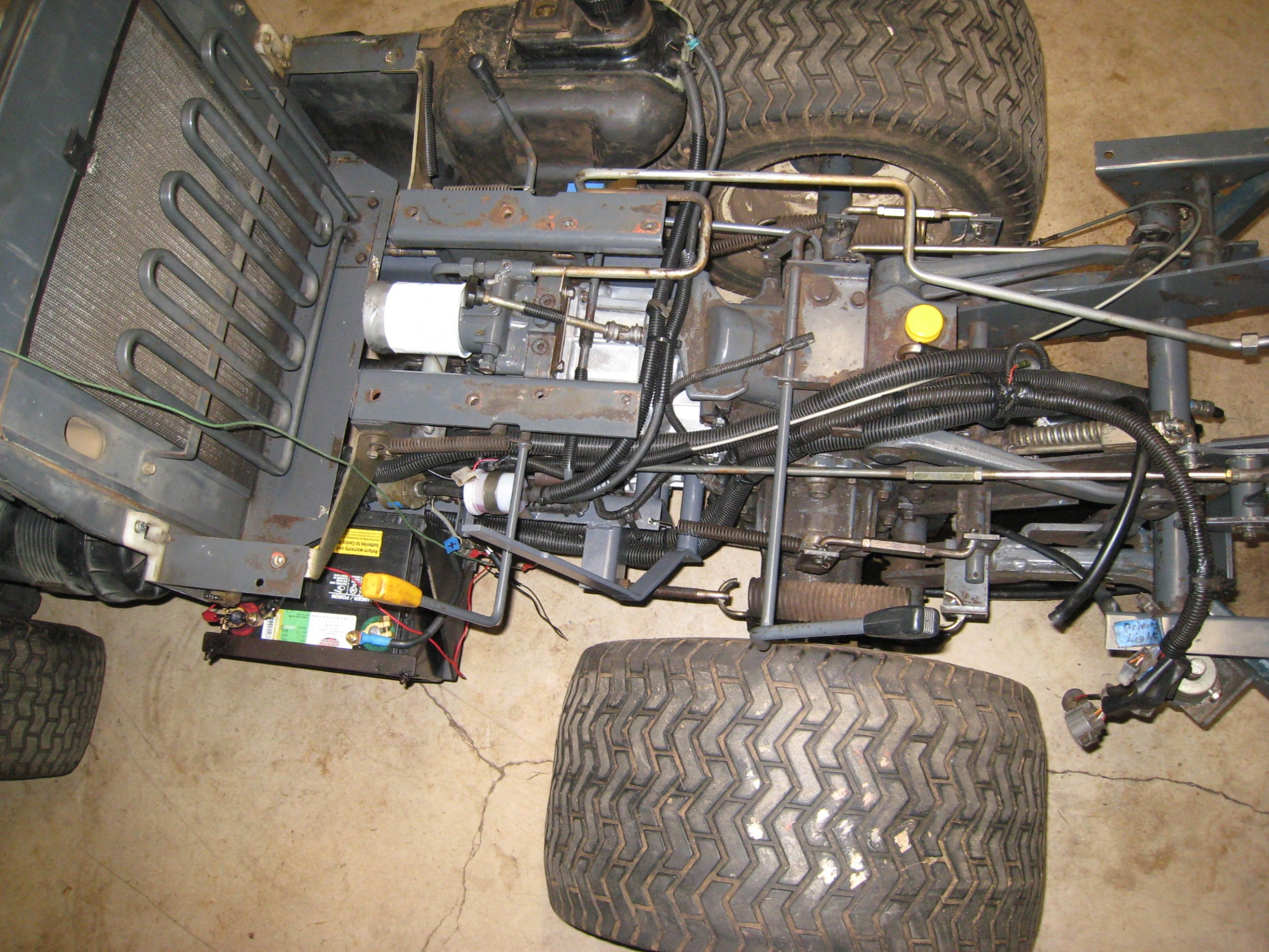

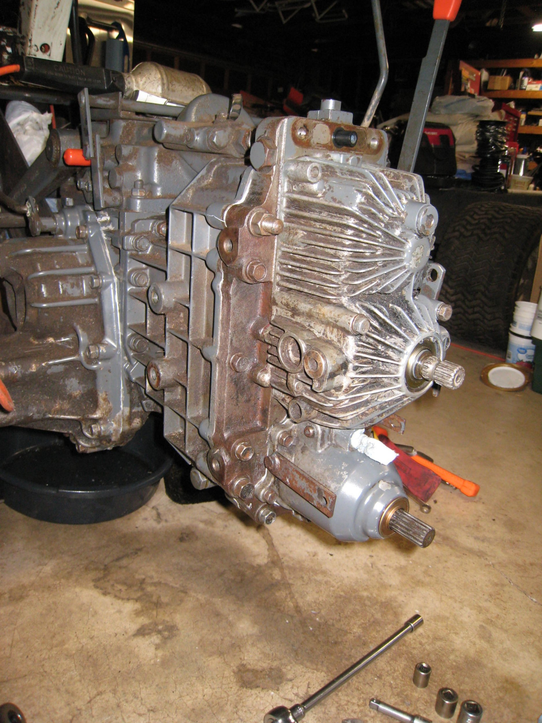

Couple of years ago I took the HST, speed range selector & front axle apart on my F3060, which should be very similar design as F3680
Kubota F3060 HST / 2-Speed Range Selector Housing Oil Leak
It's nearly impossible to access much of it without removing the frame etc. which is fair bit of work involved.
Do you have any photos of the area in question?
PS.

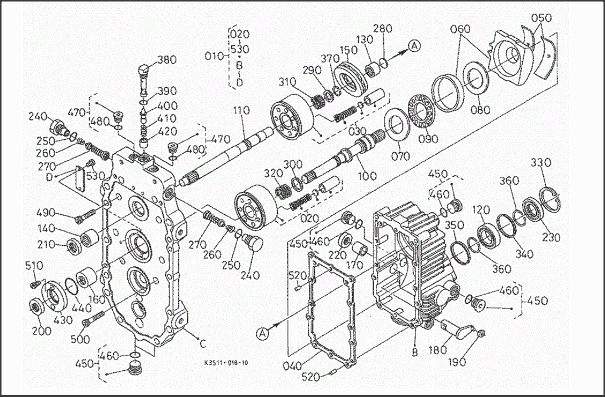

I also took the HST apart in order to replace the cradle bearings just to be sure they will be new (Item 050 below), since the speed change treadle was little stiff to adjust.
The design of later model F3060 of this particular detail is different.

Thanks Arto, I am either going to do this "in place" or send to the dealer. Looks tight but doable with the (un)appropriate cursing to move it along. My leak is on left side, middle of hydro section (opposite the forward/reverse shaft, which is on the right). Looks like you had a major job on your machine!

F3060 has threaded removable plug (item 220 above) for the left hand end bearing of the forward/reverse shaft.
I did not remove it, but it must have seal of some type (aluminum or copper?).

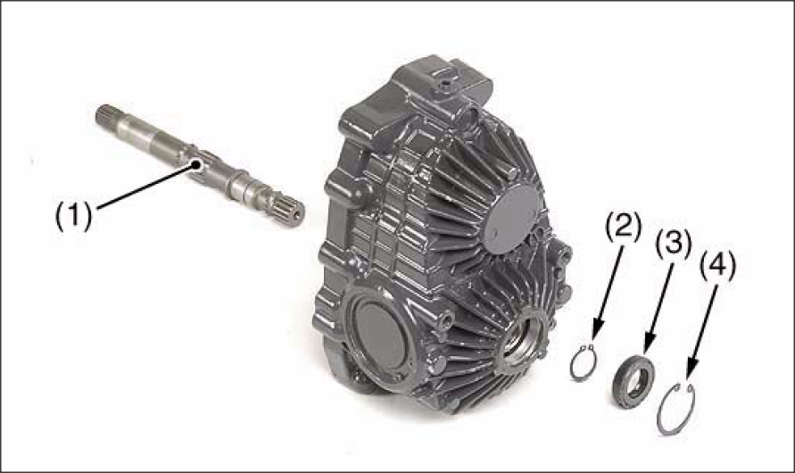

Like mentioned above, the swash plate design has changed - this is the F3680 HST housing left side view:
And here is the inside, showing an O-ring seal for item 4:
You can get detailed F3680 parts drawings for example from Messicks site.

Thanks Arto, I have the Workshop manual and use the Messicks parts lists all the time... both quite helpful. The B cover is circlip retained, not threaded and is O-ring sealed. Figure the O-ring gone bad, but getting to it in-frame is the tricky part. The side cover plate is also the bearing support for the swash plate/trunnion shaft and I may replace it with the O-ring as I do not want to do this job twice!

I gave up planning to deal with this myself.... just not up to doing all that seems necessary at my age (73), even though just a lot of bolts to remove ROPS, seat, floor pan, fuel tank, inner side frame, etc, etc before getting access to the hydro side cap to replace one O-ring! Had dealer field tech look at it and order parts.... will take to shop and will let you know if they do all the above or have some tricks up their sleeve! Lot of these machines around for many years so has to have happened before.

Dealer got it fixed but did take all the disassembly I had figured.... and dreaded, but all good now! Took 1 1/2 mechanics over a day to accomplish.

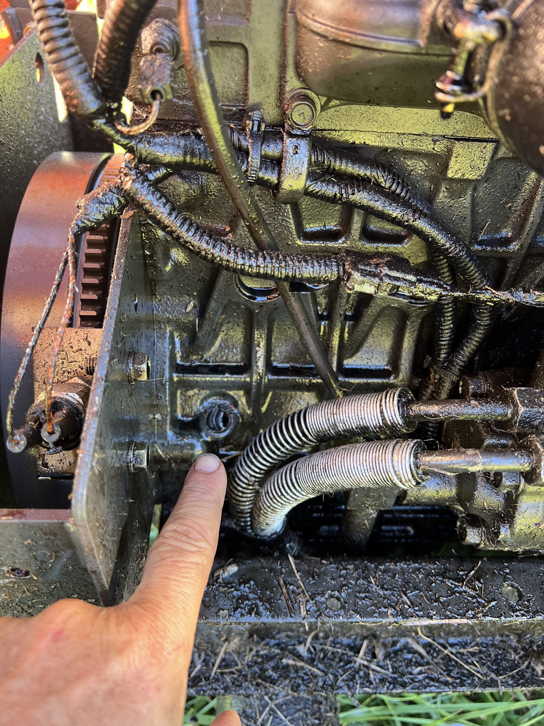

Sorry it took me so long to respond.
The back right side (“passenger side”) of the engine. I’ve lost 2 of them and began carrying spares.
Beginning to think this happens on very steep slopes. Oil runs to back and pressurizes crank case and blows off cap???? Otherwise I don’t see how else it happens

Big Thanks Dude.... looks like a casting plug that should not be subjected to more than (vented) crankcase pressure, thus my thought that crankcase vent on top of valve cover blocked or defective. I have been running an F-2880 and now a 3680 on terrain so steep (to 40 deg) I have made up a set of tire chains for even better control and safety margin and not blown such a plug nor have high oil consumption.

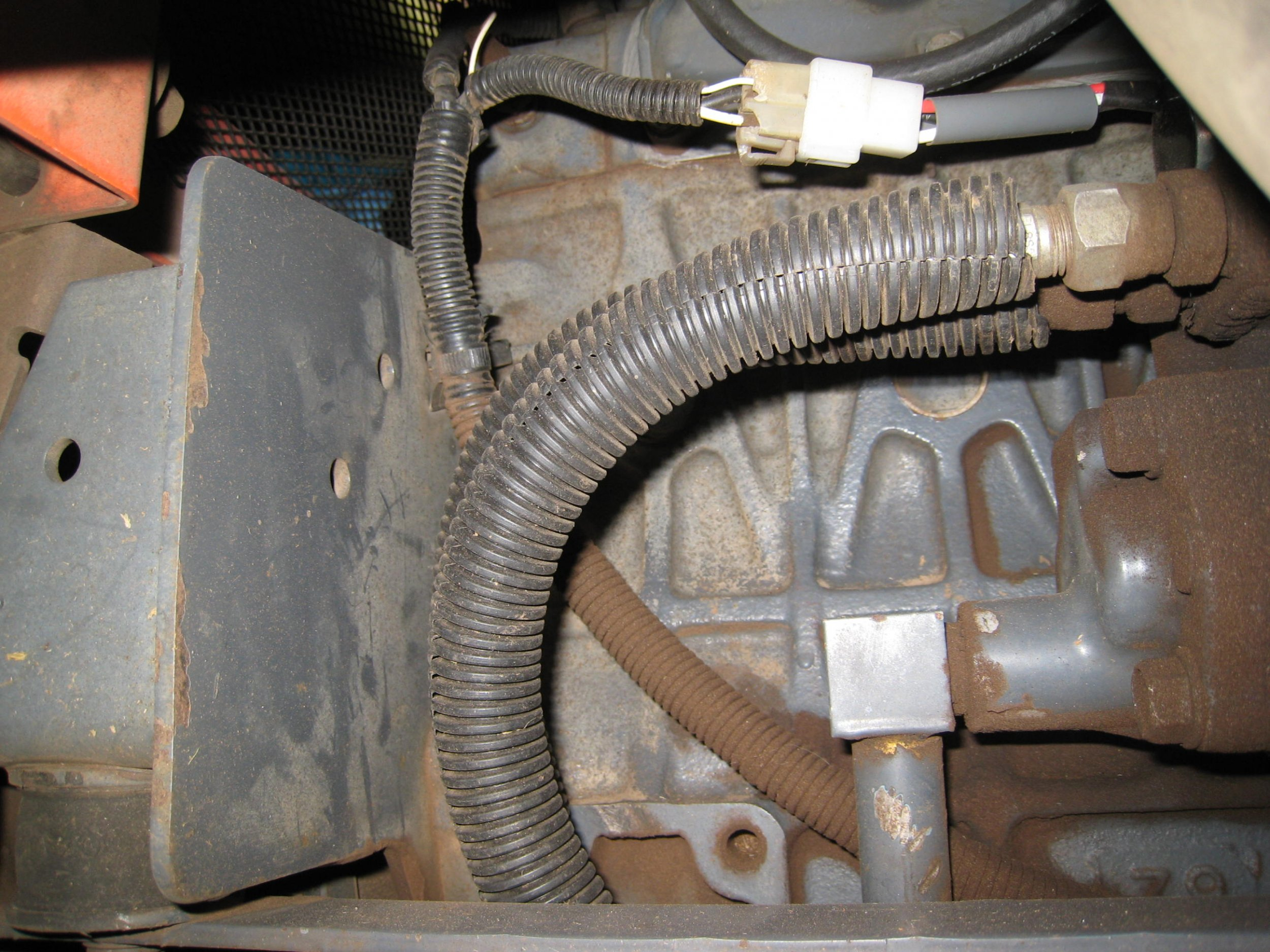

Wow that was a quite a leak and made a mess - hopefully you can figure a permanent solution.
I got little concerned and just went out to check my F3060 which has a 4-cylinder 30 hp V1305-FM engine and looks like it does not have an opening for a plug in that location.
It's due for valve clearance check soon so I will make sure to inspect the crank case ventilation while at it.
