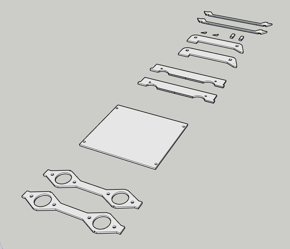

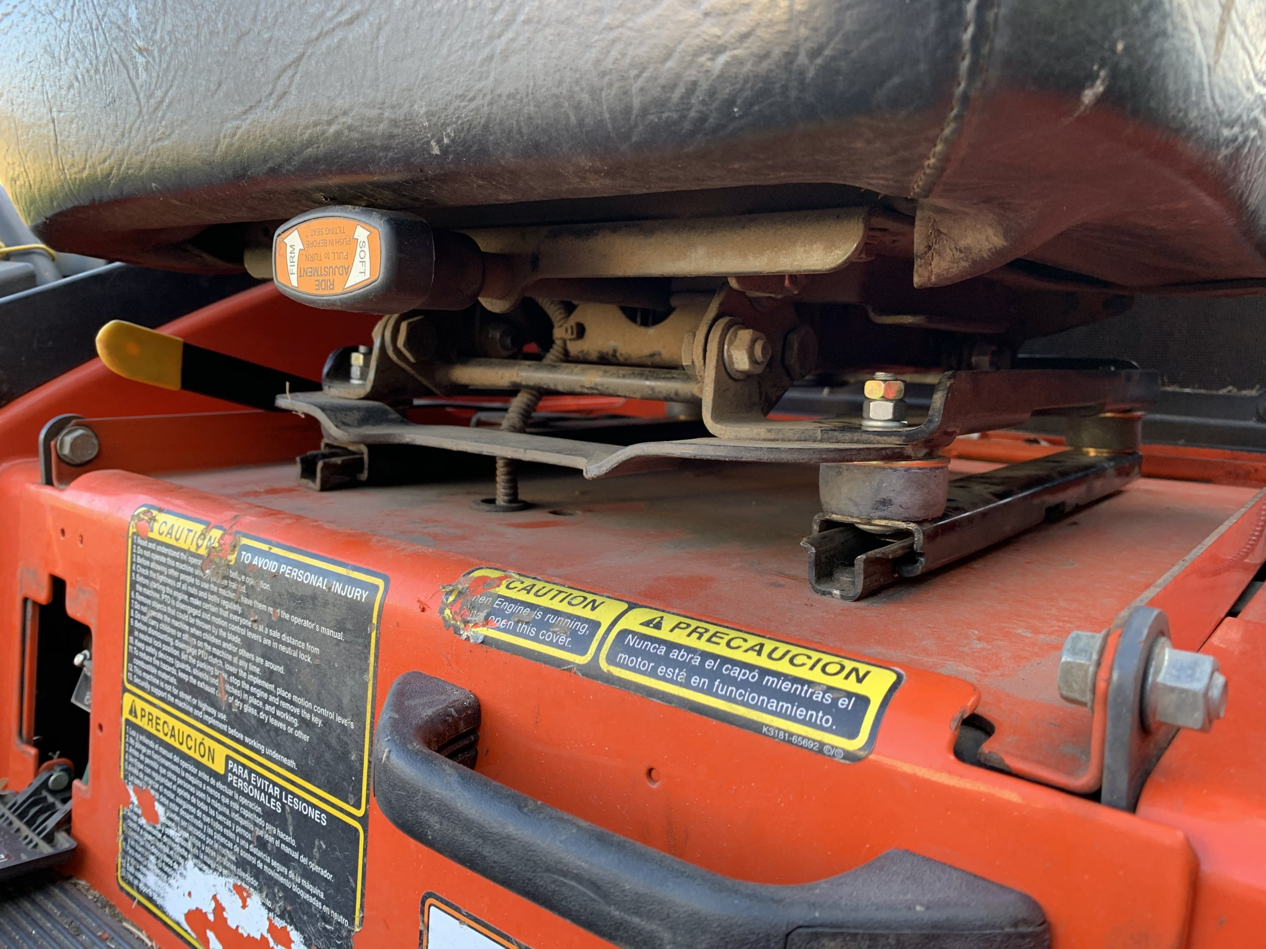

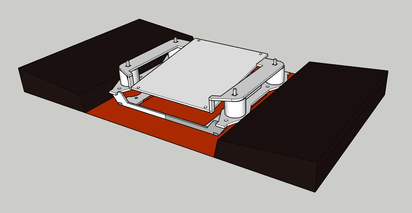

Found a pack of 4 new ones on ebay for $118, they should be here this weekend. That is about the price I paid for new ones from a local dealer in 2016ish. Hopefully 4 of the right parts show up this weekend :)
The 3d parts have already been modified, I added some gussets, I go back on shift tomorrow so it'll be a week or so before I cut any parts out.
/ Walker's F Series Thread
#22
I just finished cutting the parts out... now it's time for a test fit and then I'll weld it all up!

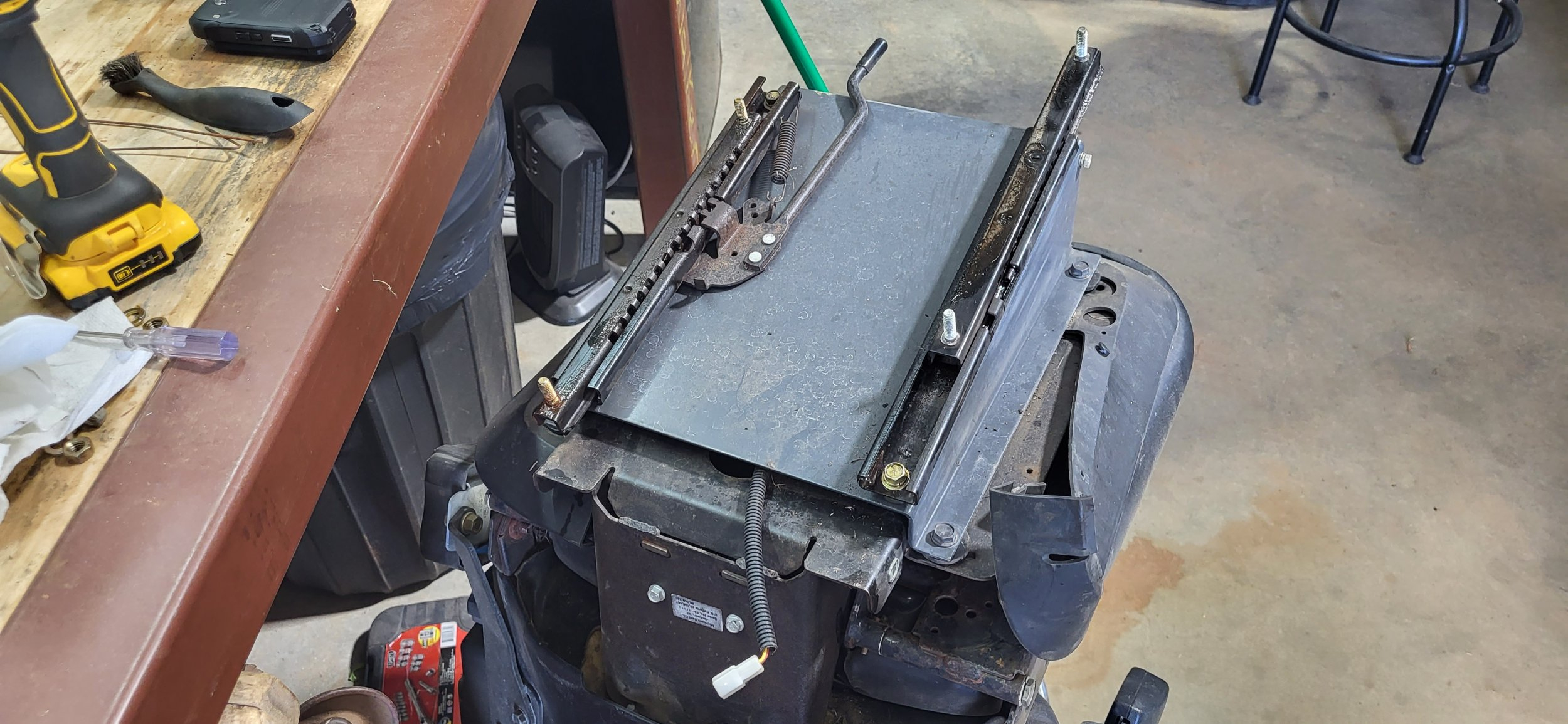

Got it together for a test, works just as planned. I did have to do one field modification, the front of the seat rails wouldn't fit between the supports. Never trust design engineers.... wait that was me!
Anyways, some quick work with the cut off wheel and an adjustment to the front brackets to have a slight angle and I was back in business.
The tolerances were all quite close, I'm about 1/8" from the ROPs and an 1/8" from the plastic controls housing.

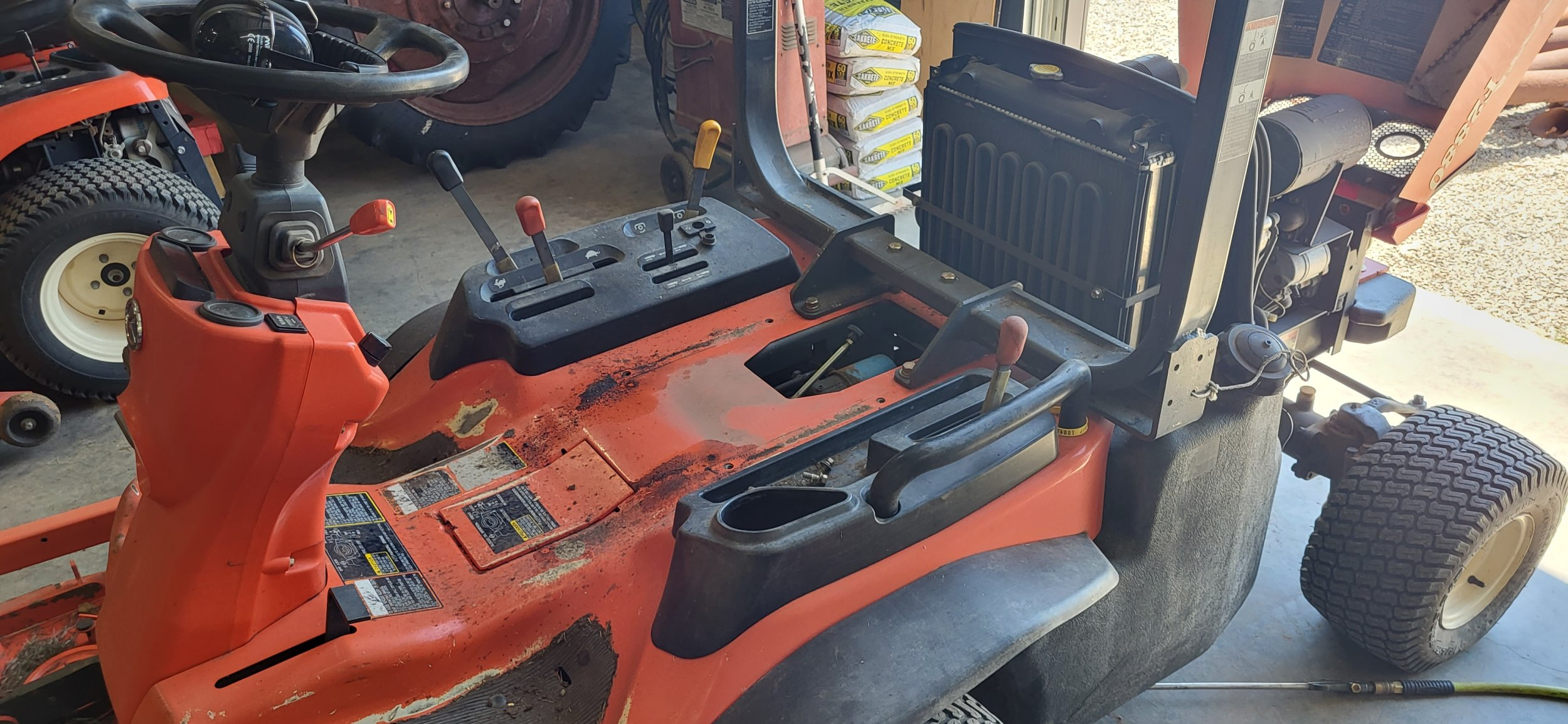

Time for a deep clean while i have the radiator and hood out of the way...
