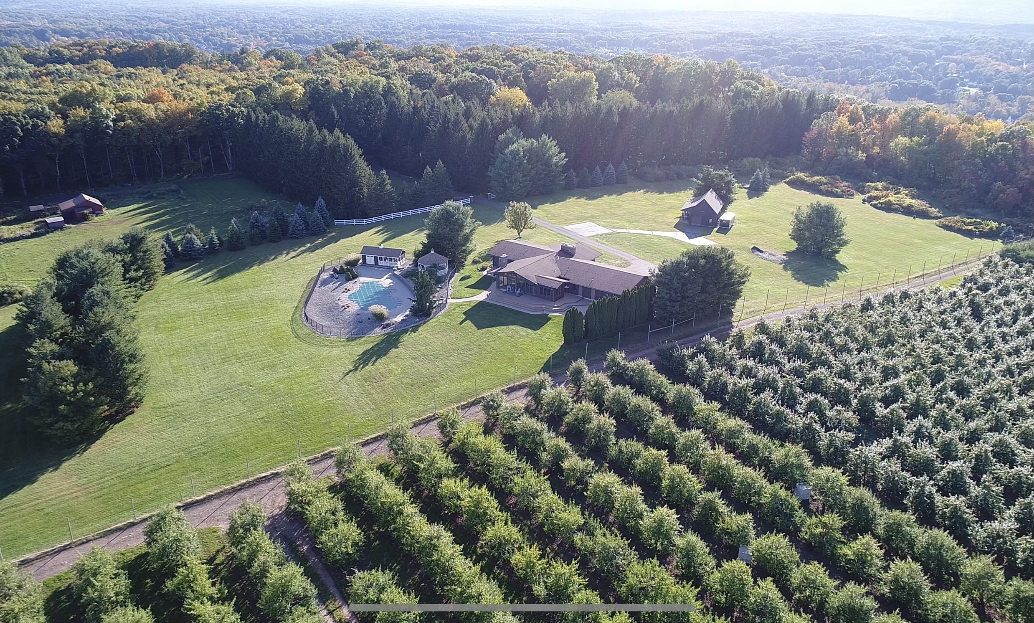

Here are some more aerials of the property. There are some obstacles. But not a ton.
I mow about that amount with a 60", 24hp, Toro ZMaster 2000. Lot more obstacles and ground can be fairly rough. The MyRide system makes mowing tolerable.
