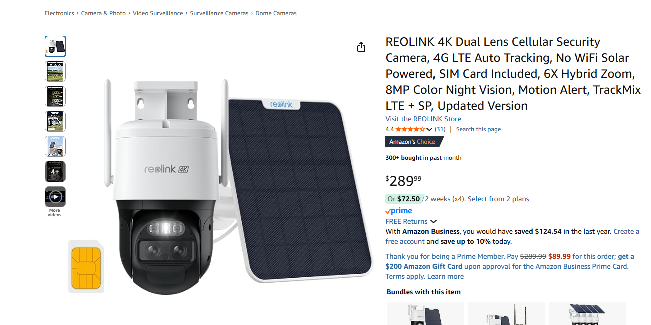

Anyone have something like this?
I have been leaving equipment parked in the middle of nowhere, where there isn’t even a house nearby for years and have had 2 pretty bad vandalism attacks.
One was slashed tires, the other was someone jumped on the tractor hood and destroyed it. Would really like to catch the punks, then a knock on their doors with video evidence.
Looking for a camera that could be mounted in or outside the cab and would swivel to the approaching motion and send to my phone or maybe it would have to be stored in the camera itself?
What would be perfect is something that uses the tractors battery power.
I’m a novice at this stuff, so looking for suggestions or help.

I wonder if you could lightly modify the mounting of something like this to fit the need? Cheaper than a slashed tractor tire if it doesn't work....

LittleBittyBigJohn, that negates a number of my points, good job.
Now all he needs is a way to power it, a way to protect it, and good cell service.
I don't happen to like Reolink due to their terms of service, but if they have this then others must, too.

I have this camera. The 'tracking' feature is not very good. It does work, but the object it's tracking must be fairly close. Like within about 30'. Otherwise, I really like it.
It is powered with a solar panel. It will last about 3 weeks on the battery without the solar panel.
It needs cellular service to communicate. I buy a sim card for about $100 and it will last me at least 6 months. And I use a lot of data. There are options you can choose for data. My sim card is through EIOT Club and it will link to whichever of the big 3 cell services is strongest at it's location. AT&T, Verizon or T-Mobile.
@Hay Dude you could mount one of these on a tree near your equipment and watch it anytime. It will alert you when it detects motion, within about 60-80'. And you can tell it to pan and/or tilt from your phone. It also records sound, and you can even talk through it to someone near the camera. You can also trigger an alarm on it. You can also record video or pictures and you can set it to take a time lapse video.

Could you use one of the ReoLink cameras mounted on a magnet? When you get out of the tractor, put it on top of the cab so that the solar panel gets sunlight.
But, that would make it vulnerable to a thief. And your cab roof would have to be metal.
Or, maybe there is a place to mount one inside the cab? And the solar panel is not attached to the camera, so you could mount the solar panel on a magnet and move it to where it will get sunlight. Or even put it outside the cab and just run the wire through a window.
