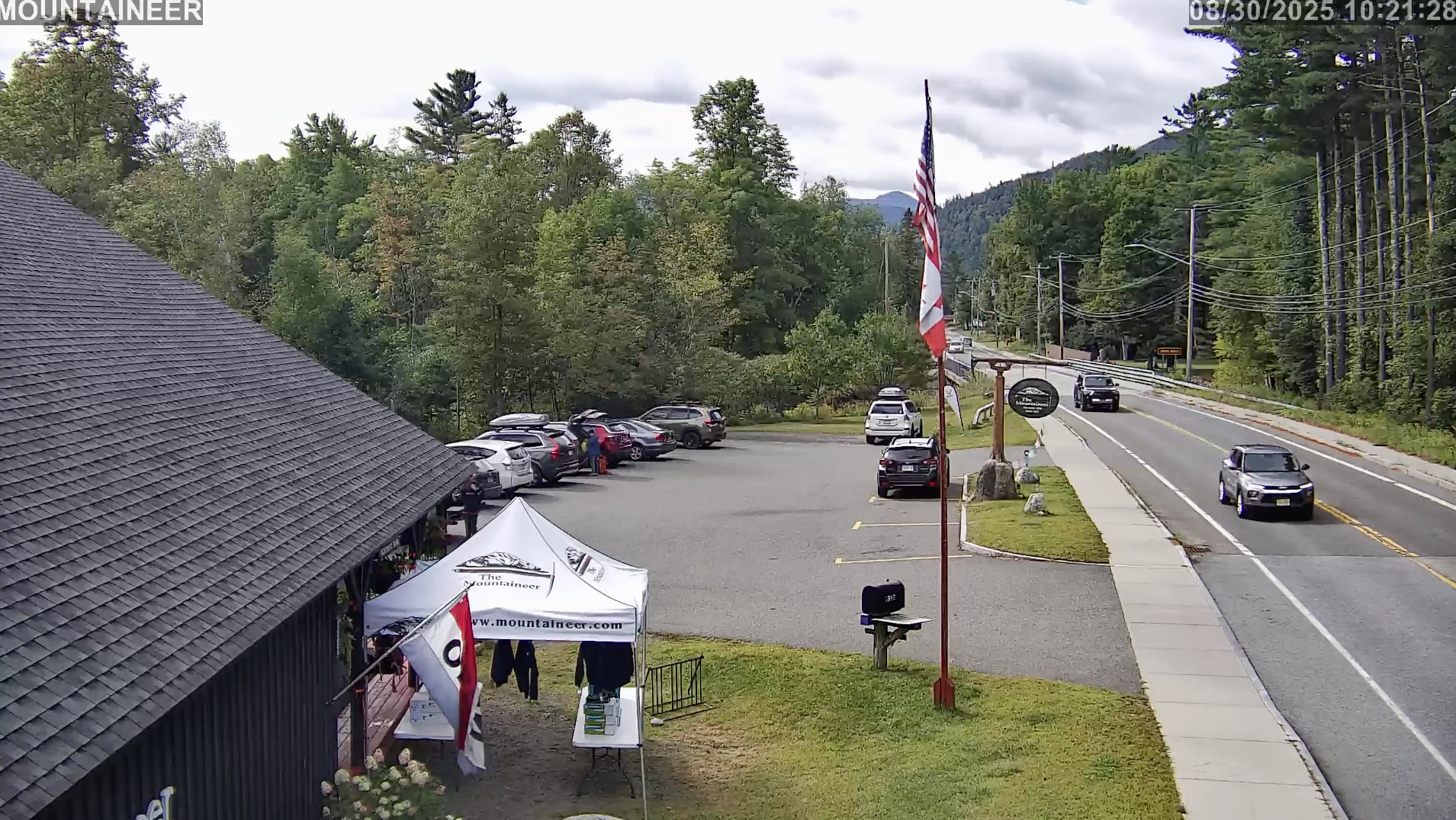

One of the long term very very reliable cameras I use in remote places is from MicroSeven. Here's a link to live video off one I operate and is accessible to anyone. It is also linked off the www.lhsc.net Snowmobile club website I operate.

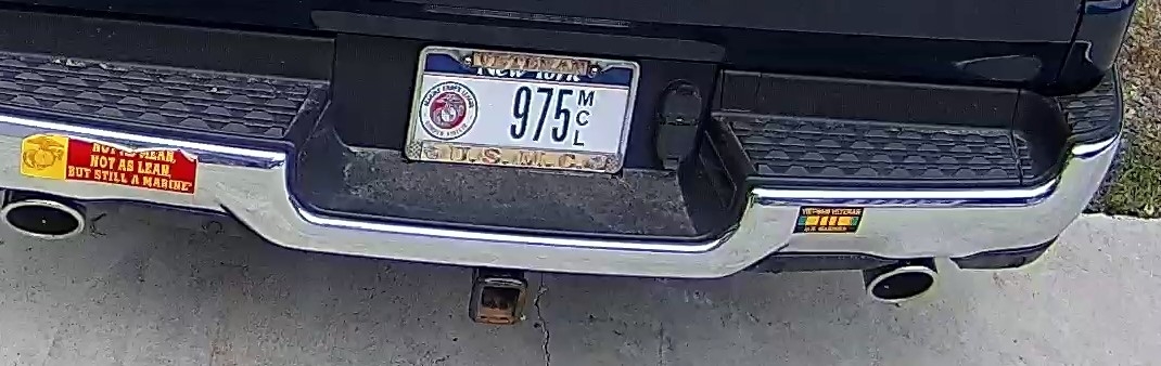

No camera is going to get a readable license plate from 100 feet unless it is zoomed in and only getting the plate. Close up many can get a good picture.
Edited;
a picture from one of my cameras,
and a zoom in of the same picture, Yes I am aware that my plates are quite visible, big deal, not concerned.

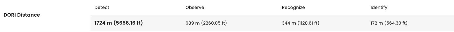

I beg to differ that you can't get a license plate read at 100'. Chasing Mega Pixels on cameras does not give you better resolution for LPR events. Some of the best LPR cameras available today are 2 MP with a larger CCD and a reduced frame rate (15 fps ) on the video feed. Also, your shutter speed needs to be above at least, 1/60s with decent IR illumination for night time. The higher the shutter speed, the better the capture. That is why you can't setup a camera with everything set to automatic. You have to manually tune each cameras settings to available light, shutter speed, and frame rate.
A DORI rating would tell you how good the camera optics and CCD are. If a camera seller does not advertise it's cameras DORI rating in it's technical specs, that is a key indicator that the camera is a cheap consumer grade camera and you should stay away from it, unless you are just after a pretty overall picture. That camera is just going to give you a pretty overall picture during the daytime, at best. Most consumers think a pretty overall still picture is all they need. That is, until an event happens and they need license plate numbers, facial recognition and a clear nightime capture in complete darkness to give to the cops. The internet is full of blurry, blobby pics with a caption: Do you recognize this person?
This is the DORI documentation on a decent quality 4MP 25X optical zoom PTZ camera with a 1/1.8" CMOS sensor. It has a 500' IR night time illumination range. Based off the DORI numbers, this camera is more than capable of capturing moving license plate numbers of distances of greater than 100'.
If a camera seller doesn't have DORI documentation, just look elsewhere. Is the DORI documentation exact? No, but by the manufacturer posting this data, at least it is going to be in the ballpark and you can get a feel of how good of quality the lenses and CCD is.
I agree, you can't make a bad, pixely picture better by running it through secret software that doesn't exist.

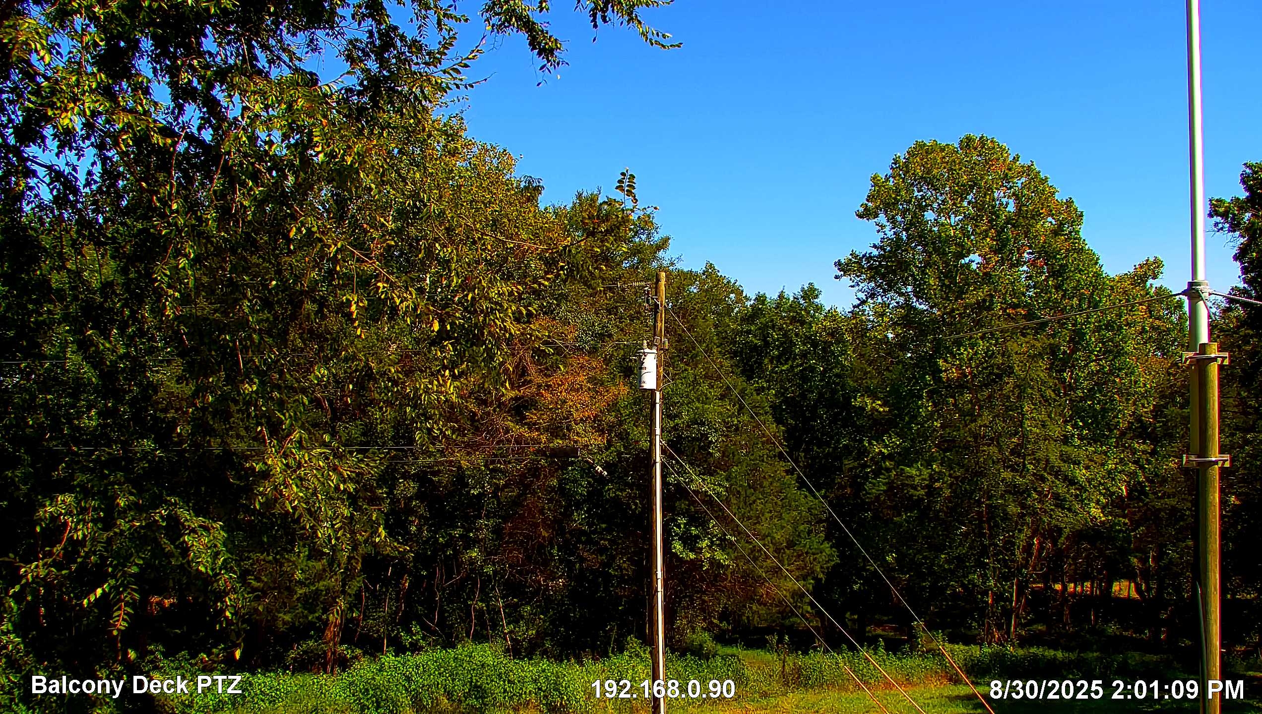

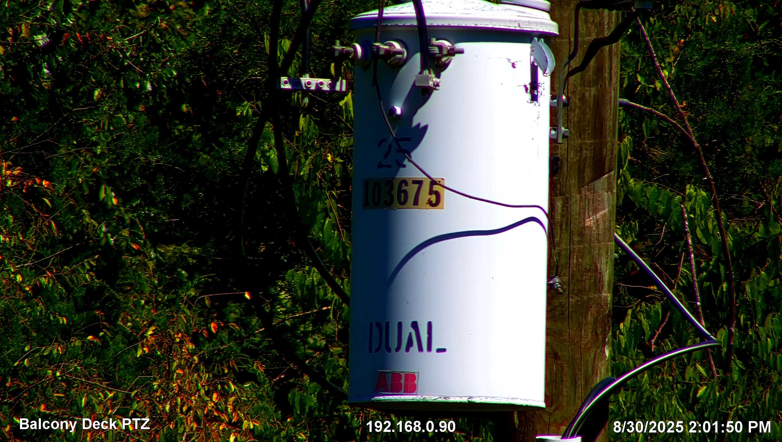

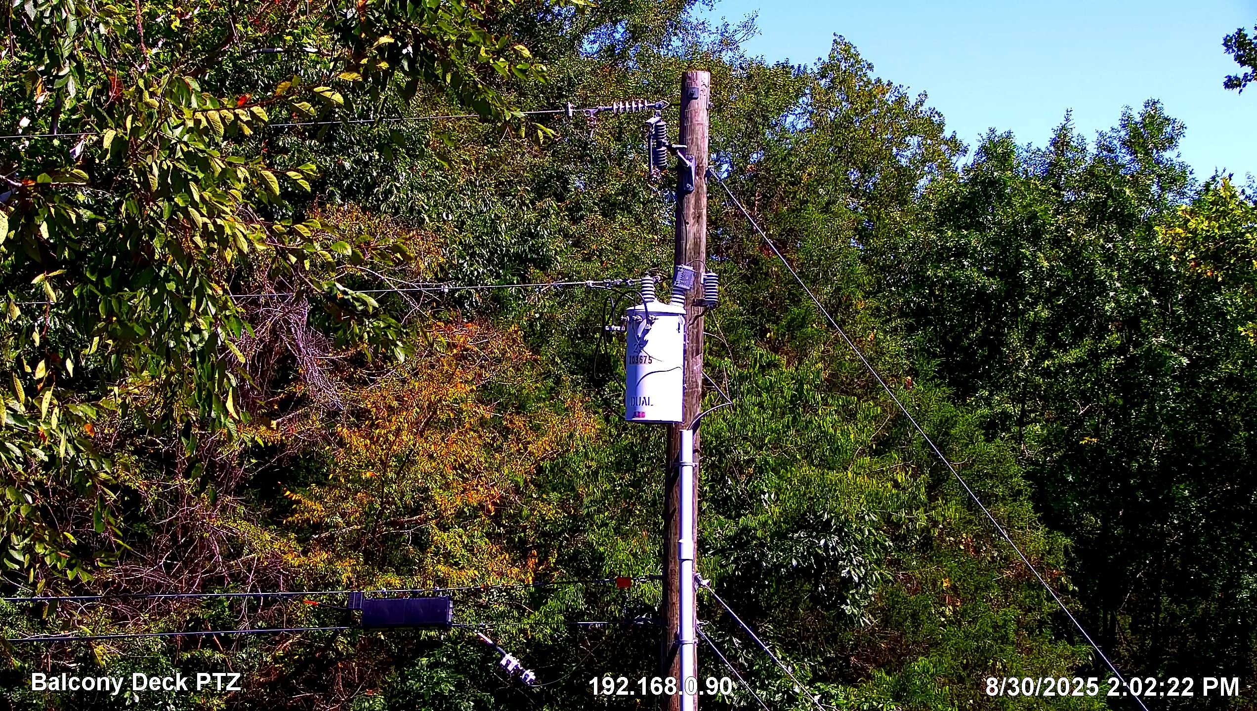

Sample pics of one of my 25X PTZ cams. It has a optically zoom ratio of 4.8-120mm. It is a 4MP camera. The first pic is optically zoomed all the way out @4.8mm or 1X. The pole with the transformer on it is 175' away from the camera.
The second picture is the camera optically zoomed in at 10X. The last picture is the camera zoomed all the way in @25X or 120mm.
This is the DORI rating of this cam.
PTZ cameras are not typically used as a LPR, due to the mechanical zooming in and focusing time lag. My PTZ's can capture license plates as far as 300' from my camera, all day and all night, provided it is not raining, snowing or foggy. Dedicated fixed bullet cams are normally used as LPR's, with a internal trip wire setup and a narrow field of view window to capture the plate in.
