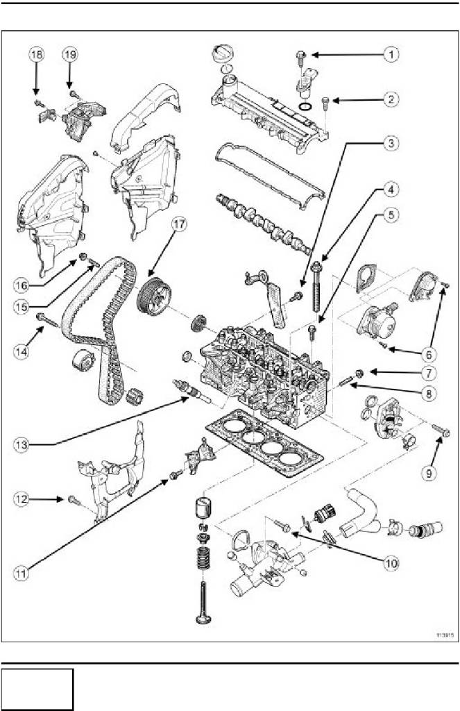

Different entirely. Heaters for intake air. They are not in the precombustion chamber. Glow plugs do not survive in a direct injection combustion chamber.
Quite wrong, most DI engines of modern design have glow plugs direct in to the cylinder. A picture of a k9k 1.5 dCI used by Nissan/Renault, same as have owned several of and this is a very typical small diesel engine for smaller cars, a 1.5l in a range of 70 to 110hp.

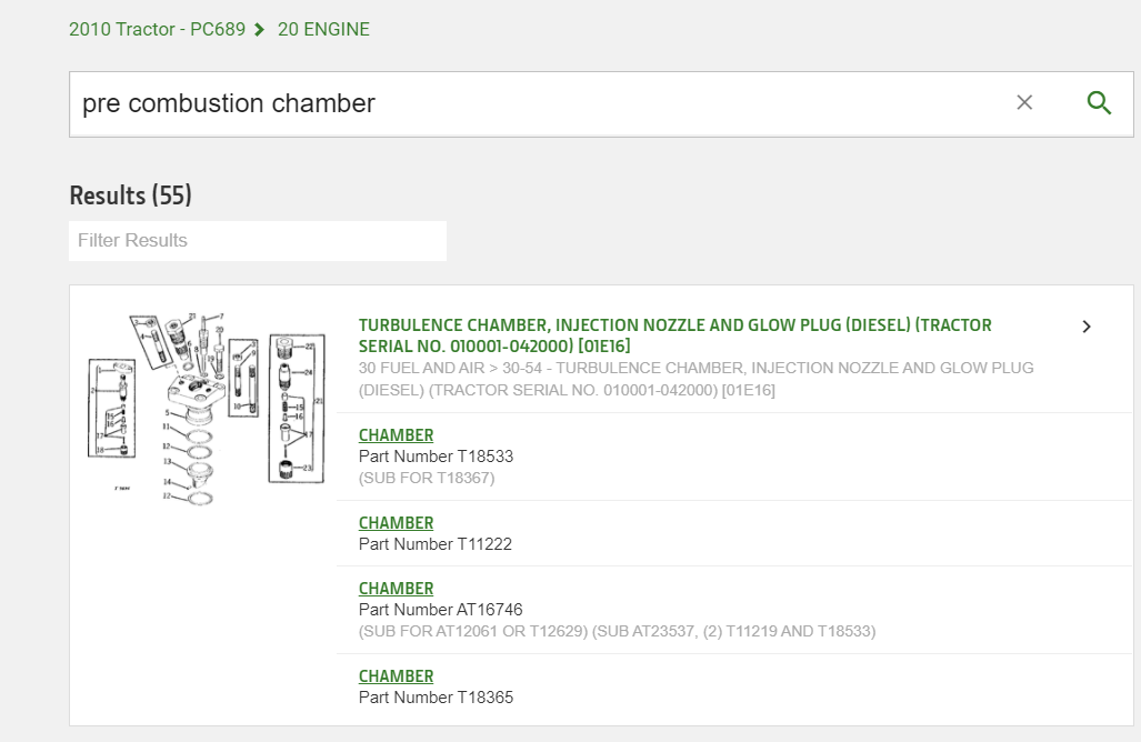

JD 1010/2010 diesels had pre-combustion chambers where glow plugs & injectors were installed back in 1960-1965
