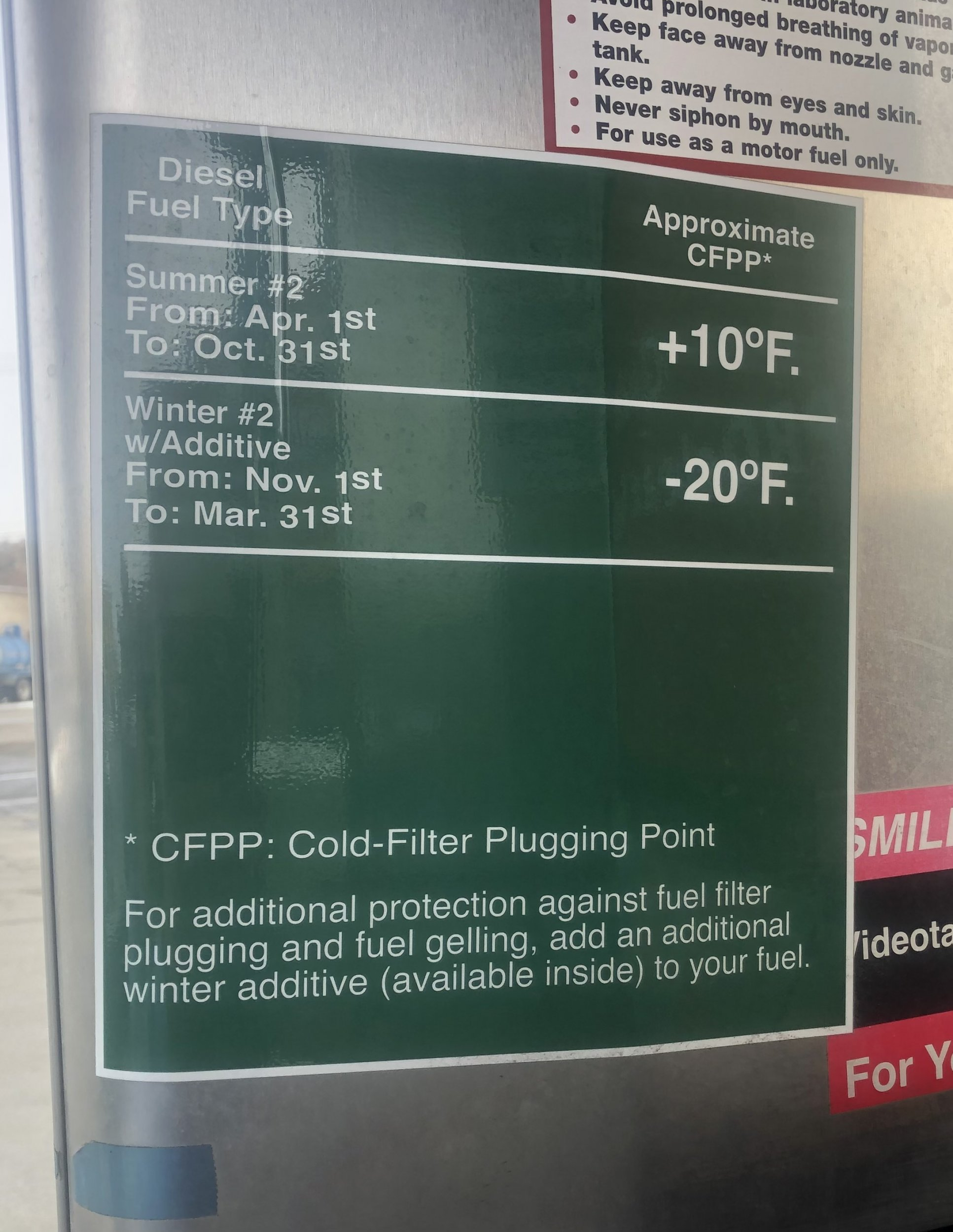

There is a seasonal label on the pumps I visit in Montana… I’ll paraphrase: “Fuel is guaranteed to -5 degrees“… something lIke that… the label usually shows up in October
You’re correct… it’s “treated” not “blended”… although blended is available at a different pump…

Can't you just pour some kerosene in it?? Along with some lubricating additives, of course. For the fuel pump.
   / CK2610 cold start… ALOT of smoke? #13
Yes, 50-50 should get you good till around -20F of course around here now kerosene is over $7 a gallon.
Lucas or Power Serve in the white bottle are actually more cost effective. Lucas calls for the single dose to be good to -10F and
a double dose isn't really specified but it refers to -40, I would kind of doubt that.
Power Serve single dose is supposed to be good to 0F, with the double dose for -0 but with no referenced low temp.
Personally I have been using the Power Serve in the white bottle at the double dose and when its calling for -10 or colder I start adding K1.
I am tempted to try the Lucas as it cost less for supposedly a bit better protection.
But I have had the misfortune to ungell a system in the -20's and it is not fun.

I snapped this pic from the station I routinely visit… I also use a double-dose of PS in my 33 gallon “fuel station” tank… I don’t have a cab on either of my tractors… when it gets to 20 below I watch the snow from in front of the fireplace…BTW… year before last we hit -33… fun stuff…
