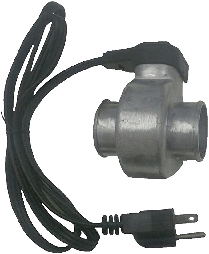

I put one of these in-line coolant heaters in with a timer on the extension cord. I only plug it in if I think I will use the tractor the next morning.
https://www.amazon.com/Kats-16800-L...=inline+coolant+heater&qid=1608384545&sr=8-11
/ LS MT125 Rough Cold Start - Glow Plug Issue?
#13
Great idea on the hose heater!
Amazon.com: Kat's (168) 2" Lower Radiator Heater Hose: Automotive
My dealer installed the Lower Radiator Hose Heater before he delivered my tractor. I plug the heater in for 1 hour before starting and you'd think it was 80 degrees outside. Oil pressure pops right up and there is no engine rattle. Heating any engine before starting helps increase its lifespan. Plugging in is recommended any time temps drop to 20F or colder.
