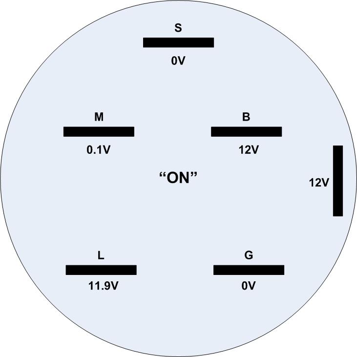

I don't know if there is supposed to be a voltage on the plug in wire at the back of the solenoid. I measured with a VM, the voltage at this wire, with the wire unplugged from the solenoid. With the key in the "on" position or "start" position the voltage was zero.
-Tim
/ Electrical Problem with 425
#38

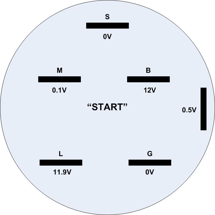

JJ,
Attached are voltages I measured at the keyswitch. The first is with the key in the "on" position. The second is with the key in the "start" position.
The click I hear when turning the key to the "on" position sound like it is the fuel switch.
-Tim

/ Electrical Problem with 425 #39
tlb said:
JJ, Dale,
I connected my jumper cables from the truck battery with truck running to the starter post closest to the starter. The starter engaged the flywheel.
JJ,
-Tim

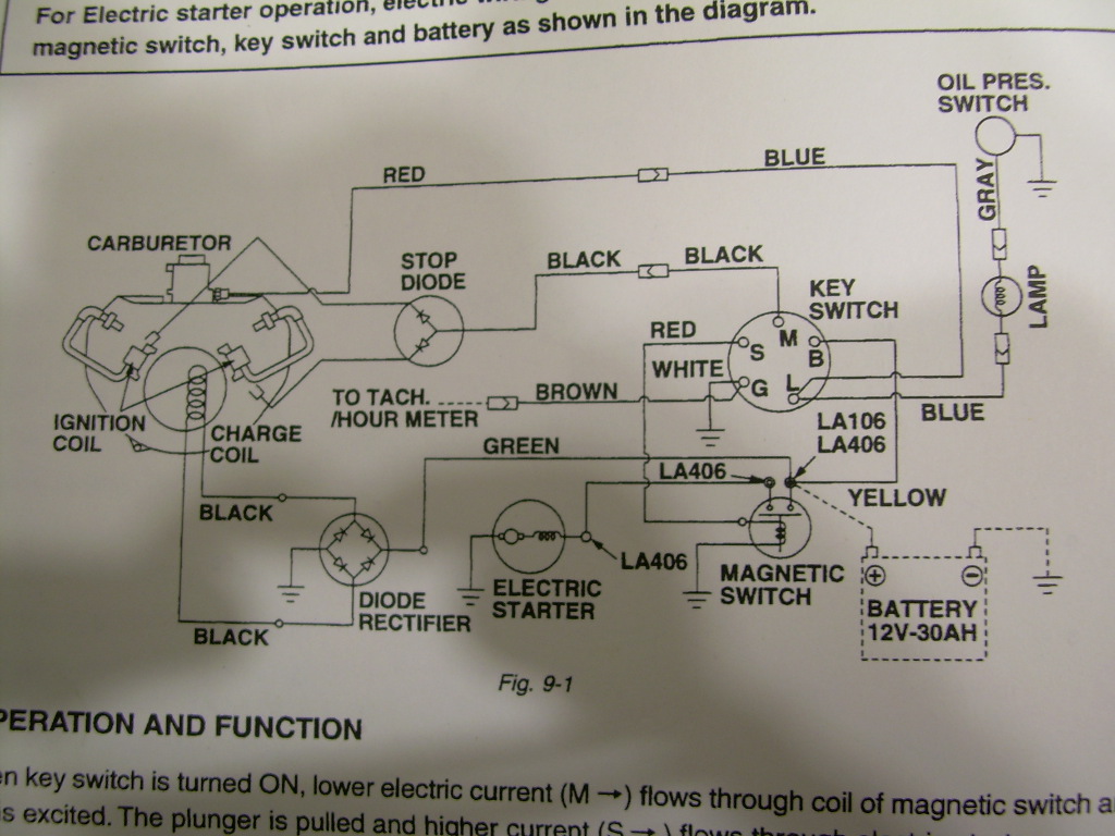

The starter is OK.
The plug wire on the back of the solenoid should have 12 volts when cranking. It supplies power to the solenoid coil.
I believe (but am not absolutely sure) that the key switch leads are as follows:
B - Battery - Should be 12 volts in the off position as well. Check this.
S - Goes to PTO swith and then starter. Check continuity to the plug wire on the back of the starter.
Terminal on the far right of the switch - Goes to the lights and hour meter.
If S truly goes through the PTO to the starter then jumper battery voltage to it. The starter should work. If this happens then your Key switch is bad.
Edit: I believe that the above is correct. I found the Robin diagram in their engine manual. I have attached a picture of it.

BobRip, JJ,

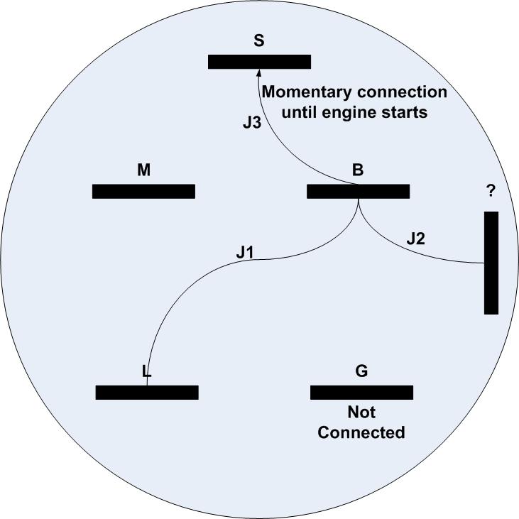

Find the problem..........bad keyswitch. After downloading the Kohler manual and studying it and BobRips electrical diagram, I made some more measurements. The keyswitch does not make contact in the "start" position.
I pulled off the switch and used some jumper wires to short the appropriate points together. See the attached diagram. Once I did this it started right up.
One thing I don't understand (I think the Kohler electrical diagram is not correct for PT425) is if jumper J2 is not connected then the starter & solenoid works but the engine will not start, like not fire to the plugs and the lights do not work. With jumper J2 connected the engine starts right up and the lights work. Once the engine is running I can disconnect J2 and the engine keeps running but the lights do not work. What is J2 doing?
My PTmanual says the keyswitch is a Robin E341x1. Where can I get one (besides PT)?
Thanks for all the inputs from everyone.
-Tim
