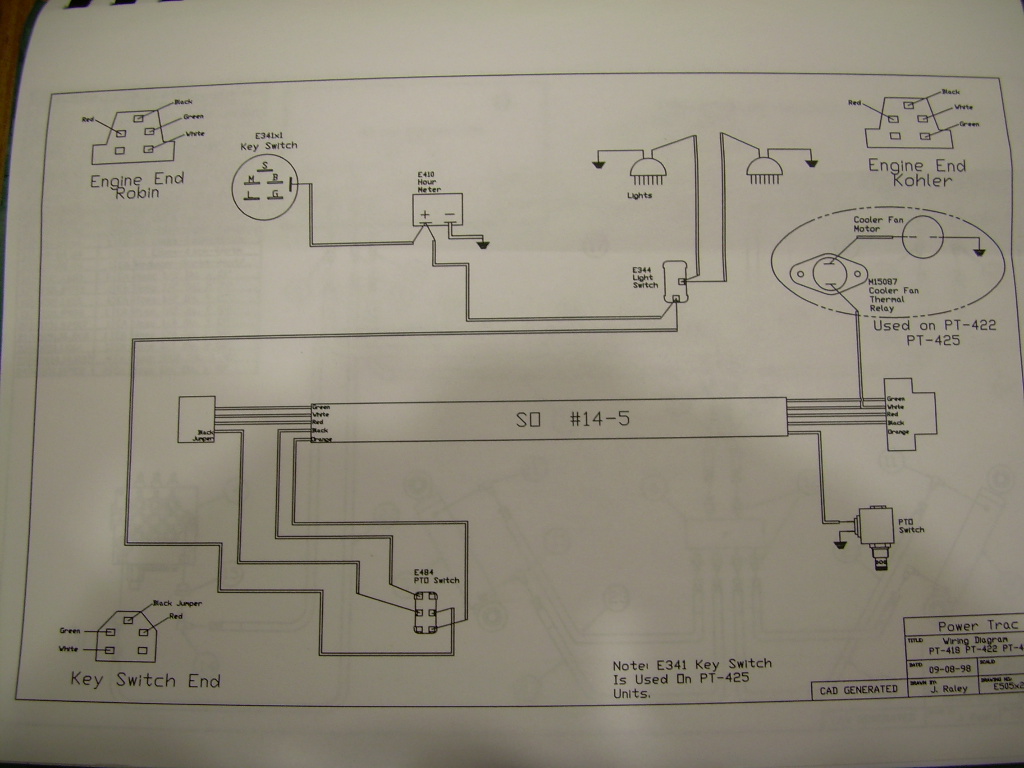

tlb said:
JJ, Tim,
Thanks for the feedback. I will try this later today after work.
JJ,
The picture you attached looks correct.
I am attaching pictures I took this morning. I checked the connections and they seemed tight but will remove them and re-attach. Is there any way to bypass the solenoid so I can at least start the engine?
Thanks,
-Tim
Tim, Just curious of you ever figured out your starting problem.
