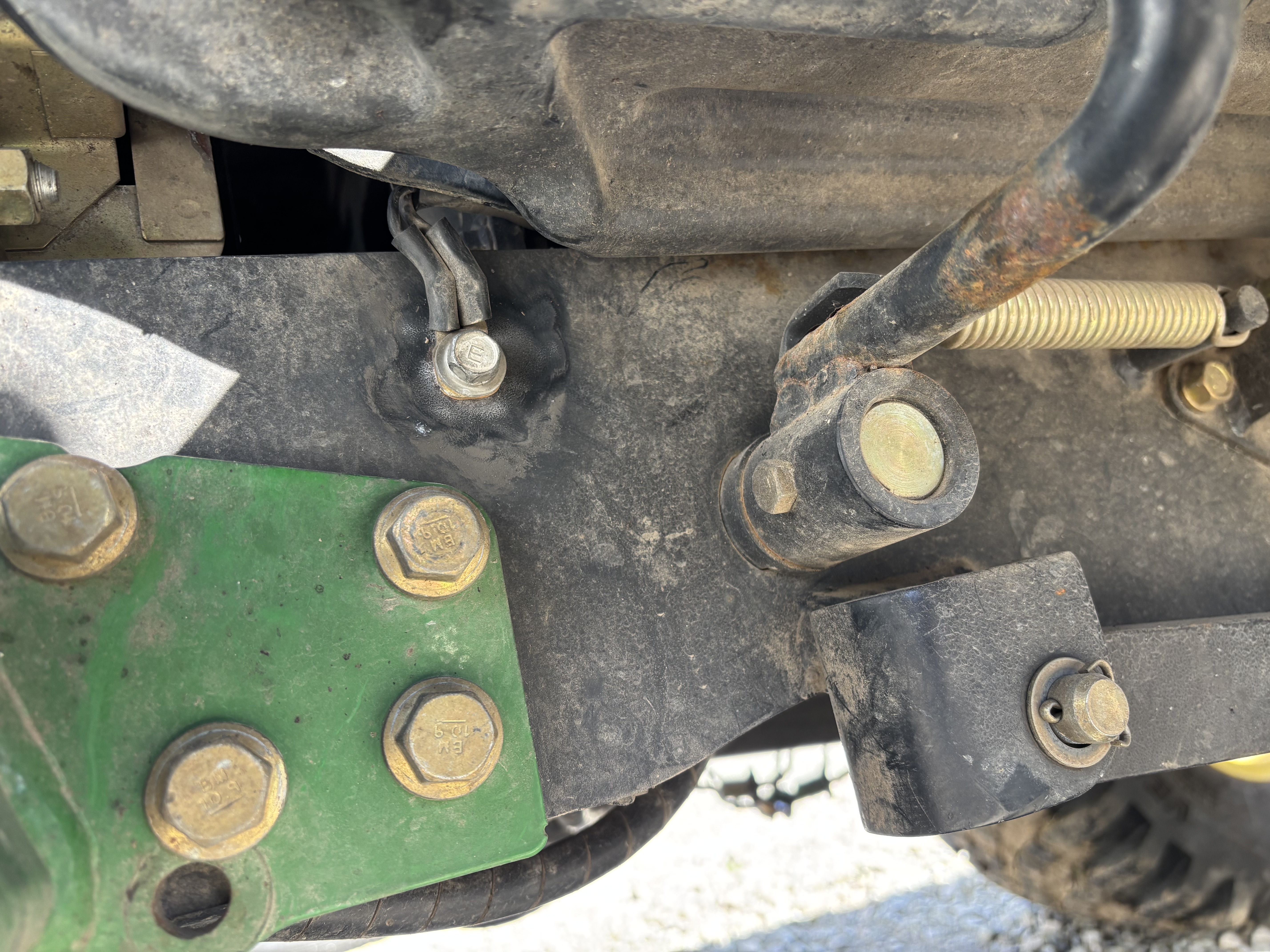

Hello all, Does anyone know where the ground points are for the dash/underdash wiring for a 2305? I had the tractor out, did some loader work, then used it to raise the front of my zturn so I could replace the blades and shut it off while I was doing the blade change/deck cleaning. I then went to start it and the oil light flickered a few times and the starter wouldn't engage. Subsequent times of turning the key to run and no lights at all. I tried the light/flasher switch and nothing there either. Troubleshooting steps so far are; Master fuse, good, 4 fuses on right side also good, battery 13 volts, starter 13 volts, main fuse good and 13 volts. Auxiliary panel in the cab, 13 volts and the aux lights, wiper and heater motor all work. Pulled the lower dash cowl off, checked the white/red wire going into the key switch, 13 volts. Checked the white/blk wire going the the dash light switch, 13 volts.
I have someone taking the battery in today for load testing and replacing the battery ground cable (precaution because we replaced the batt clamp several years ago)
I am really leaning to a ground issue, but am not sure where all the chassis grounds are located.

So I did 2 things and fixed the issue. 1. Replaced the ground cable that
Goes from the frame to the battery and the real culprit. The chassis ground under the foot board. When I removed the bolt, I saw frame paint under the terminal and corrosion on the bolt. I removed the paint under the terminal and cleaned the bolt. After that, everything worked. FYI, Deere has everything coming back to this ground point.

Good catch on finding the ground culprit. In future troubleshooting you can test the voltage between two supposedly grounded points, such as the neg post and the frame. Under load, any voltage at all, like even a quarter of a volt, showing up between two grounded points tells you there is a bad ground.

In the OP, I explained that no voltage was going to anything, so it did me no good to check voltage on the starter when someone turned the key. ( I tried) When I saw that I had voltage on the input wire of the light switch and key switch but no activity past that, I knew it was a ground issue. According to the 2305 wiring schematics, everything comes back to a common ground. Once I found that ground and removed the bolt, I knew I had found the issue and sure enough, removing the paint under the terminal, and cleaning the corrosion off the bolt restored the ground and i had everything working again.
