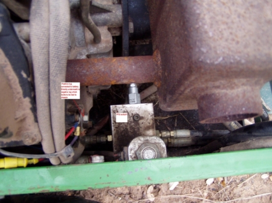

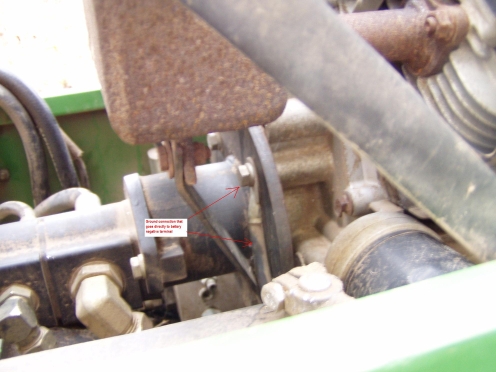

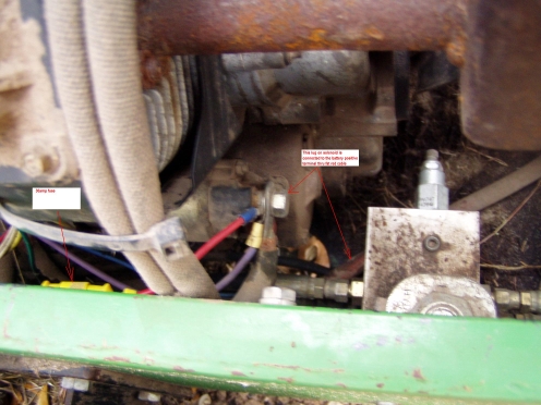

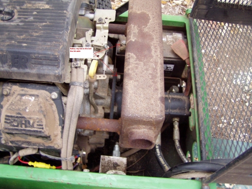

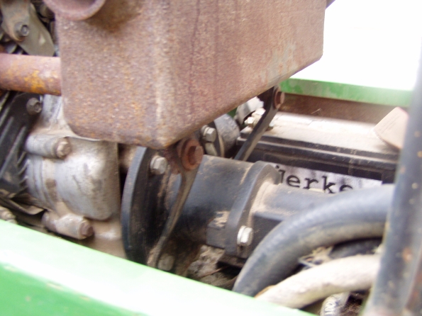

/ Electrical Problem with 425 #25
tlb said:
JJ, Tim,
Thanks for the feedback. I will try this later today after work.
JJ,
The picture you attached looks correct.
I am attaching pictures I took this morning. I checked the connections and they seemed tight but will remove them and re-attach. Is there any way to bypass the solenoid so I can at least start the engine?
Thanks,
-Tim
Tim, Just curious of you ever figured out your starting problem.

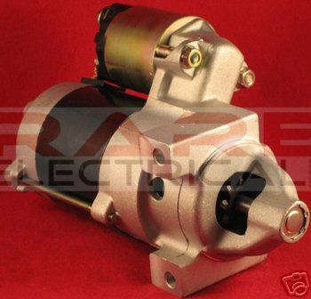

I tried to spin the starter as you suggested by connecting my truck battery to the 425 battery and shorting together the two lugs on the solenoid. I used a phillips head screwdriver and jammed it across the lugs.
After the inital sparking, I could hear what sounded like the starter spinning but it was not engaging the engine flywheel, just free-spinning. I tried it a 2nd and 3rd time with the same result. At this point the screwdriver started glowing red and welding itself to the lugs so I stopped.
Does this sound like a solenoid or starter problem?

Since the starter is spinning, but not engaging into the engine, it sounds like the solenoid is bad.

You did good, you proved that the starter is good. Your solenoid is bad, because it will not throw the pinion gear into the starter ring gear. Get a new solenoid. I went on Ebay and found lots of starters for the Kohler, at different prices. If you see one you like, ask the seller some questions. I am bidding on a new starter that has the solenoid that I need.
