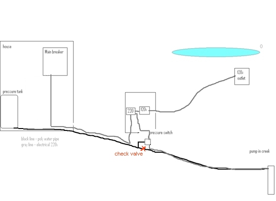

The pressure switch should stay as close to tank as possible, the switch if relocated to box would be subject to to much pressure fluctuation as when the pump was charging system and when it shuts off afterwards.
I can,t believe an electrician wired it this way after you explaining what you wanted to accomplish. As kayssupply stated, it's not code but wire ahead of switch to your desired location or figure out how many H2O outlets you need open to keep pump running.
Since you have not run any wire to your desired location, just means a bit of digging from uninterrupted power source.
I'm still not quite understanding what you mean.
/ electrical/ pressure switch question #22
Like the red line in drawing, my 2 cents says to keep pressure switch at current location and connect your 110v outlet to sub panel, if your not familar with electrical connections or have never done before, I would suggest you have one that does complete the connections.

It proably won't meet code, but I don't think any of this project will, how about wiring the leg you want hot ahead of the switch and switch the other side of the 220? That way your leg will stay hot but the pump won't come on until the switch makes at the house.
Wouldn't that make a constant 110v to the pump? And then make it 220v once the pressure switch calls closes? I don't think a constant 110v at the pump would be good..
I wonder if switching to a 110v pump would afford a few more wiring options?

I have terrible well water , full of iron. but, I also have a creek that originates on my property so, I put a 220v submersible pump into the creek, then all the required filters on it and now i have wonderful water.
I obviously ran 220v wire ( 8/2 I believe it was) 500ft to my creek for the pump. I also have a very nice large pond that we use for hanging out and swimming in the summer. I would like to have electric down by the pond. So, I put a breaker box in halfway down my field to split off the 220v for the pump. I had an electrician wire it up so now I have a 220v breaker and a 120v breaker in the breaker box. I have yet to run the 120v wire to the pond.
But then I realized that the only time I will get power to my 120v outlet by the pond will be when the pressure switch is closed and calliing for water to my house.
how can I solve this problem without running ery expensive wire 500ft again? Maybe put the pressure switch after the filed breaker box somehow????/

Have you verified with tester at above mentioned box that in fact current cycles with pump or is this an assumption, just trying to pinpoint.
It i pretty much a fact since the lead from the panel inside my house runs through my pressure switch and then down to the breaker box in the field.
/ electrical/ pressure switch question #32
It would appear then if you want a constant electrical supply at pond, the only way to accomplish without a home run from the panel is to relocate the pressure switch.

Like others have said run a new wire and the life you save might be your own,, Stop trying to make it work the facts are your "electrician ?" made a mistake. You can not do what you want with the wire that you have,, Not by changing to 120v pump and not by jumping this or moving that.. You say no codes there.. Well they are called "Life saftey codes" for a reason.. Do you have kids.. Then do it for them.. :D

I know I don't have power. I recently switched out the pressure switch and the way it is wired it is easy to see that it does not have power.
Nope , no control box, It is a two wire pump.
/ electrical/ pressure switch question #37
8 2 romex does not have a neutral. it will only have 2 hots and a ground wire
I doubt there's any such thing as 8/2 Romex. He probably has 8 gauge pump wire, which is 2 hots and a neutral, no ground. Running a ground hundreds of feet is not a good idea, since you can have a local potential on a remote ground. The junction box needs to establish a local ground. In the old NEC, the neutral and ground were bonded at the remote box. That changed and more ground wires were run to separate buildings, but for farm use a local ground is the only way to go.

The code requires a ground run between a main panel and a subpanel. if this is work done in the past 3 years then its not done right. If indeed it is romex run between the panel then the wire being used for a neutral is bare copper, and cannot be used as a neutral wire (which can and does conduct power.
/ electrical/ pressure switch question #40
Not sure how my electrician wired it really. i just drew the pic.
Moving the tank and/or anything that holds water above ground outside is not an option. it gets well below zero at my place. Looks like I am running more wire !
Moving the tank or anything from original would NOT be a good idea. If something happen, you will pull all your hair out. If it's working, leave it alone.
If you calculate your time, money and get the Electrician out again, you have better luck leaving everything alone and just get another wire and run it down there. Save time, money and effort.
