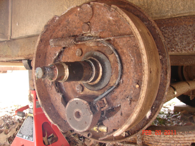

Reg, I know the drums are 10 ", plate is 4 bolt, haven 't measure spacing or hole diameter. Haven 't measure drum depth to match shoe width. I 'm planning on Dexter self adjusting 10" x 2 - 1/4" backerplates. By " measure within 1/8 in. ", do you mean drum depth should be 2 - 3/8 " ? Would a deeper drum matter ? Would like to use original drums not to be on the cheap, but to not spend money where it isn 't needed.
Thanks for the heads up on plate bolts. I got a lot of time ( retired ) and bought some soaker stuff today. I plan on breaking nuts before I jack trailer so I don 't have to spend too much danger time under while jacked .

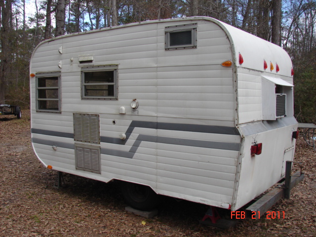

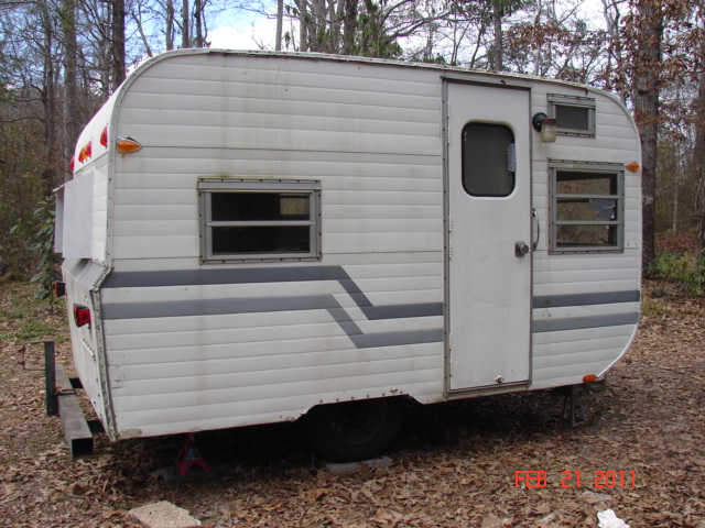

I know ya 'll like pix so here 's the camper in question in case it helps with the brake questions. Body measures 6' 8" wide, 11' long, 6 ' high. Add 3 ' for tongue. And as soon as I get passed the brake project I 'll start a new thread under project forum :thumbsup:

No, he wants you to measure the width of the shoes to the nearest eighth of an inch. The standard widths come in 1/8" and 1/4" increments, 1 7/8", 2", 2 1/4", 2 1/2" etc.
Thanks for the rely :).
yes I understand what you are saying, but it doesn 't matter to me if new brake system matches old if that 's what you 're getting at unless, of course, it does matter for reasons I don 't understand. I 'm just trying to figure out is if my old 10 " drums with whatever their depth is will work with a brand new backing plate with shoes that are 2 - 1/4 ' .
I know I 'm having trouble being clear due to my lack of area knowledge :confused2:, apologies.
   / Electric brake testing on old trailer #68
No need for ANY apologies, we're all here to help each other - you can pass along other knowledge, pay it forward or somesuch (-:
At least ONE reason that you probably want to stay with the original shoe width and drum depth;
Spindle length, i.e. the space you have available from the shoulder for the inner bearing to the threaded portion where the castle nut fits on.
I have a trailer with 3 3/8 wide shoes, but if I tried to put the corresponding drums from THAT trailer onto the one that has 2 inch wide shoes the outer bearings would be (about) another 1 3/8 out and the chances of getting a spindle nut on - and a cotter pin through the castle nut to hold it ??? ... slim to none (-:

Thanks Reg. Somewhere in my mind I was thinking in that direction about the spindle nut and length stuff. Just couldn 't put into words. That 's why I was concerned with drum depth. Seems clear now that even if I replace everything I better try to do a size match to the original to avoid problems with spindle nut and spindle length. With any luck at all, I may be sleepin' in the camper within say, oh, the next 12 hundreds years :laughing: But what else does a retired guy have to do ? I don 't like fishin' :D
The cross section pictures showing spindle, bearings and drum help.
Also the instructions about adjusting for just a TINY bit of slack, NO pre-load, just barely perceptible looseness - - DO be careful about that.
