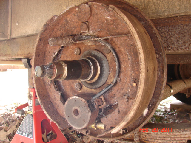

I inherited a small 1973 Tag-A-Long travel trailer. It appears as though it was rigged for electric brakes. There are two wires ( cut ) coming out of each of the well drums( total of 4 wires ). How might I test to see if the brakes still function before buying needed vehicle controller and wiring system ? Could I just use a 12 volt battery on the 2 wires ( + and - ) to see if brakes engage ? I havent 't yet pulled drums to see what braking system might be there. I 'll be towing with a ford ranger XLT pickup so I 'd like to restore brake function if possible. I 'm also gonna add a weight distribution sway control hitch system if that matters.
Yes, that works.
Anther thing is a battery charger - especially one with an ammeter.
Each brake coil should draw about 3 amps.
If you have to go in there and WORK on them DO get self adjusting backplates.
Rockland auto has the Dexter units for something like $5 or $6 more than the non self adjusting ones - WELL worth the money to save the aggravation of having to adjust them again and again.

Attempting to post brake picture after removing one drum today
