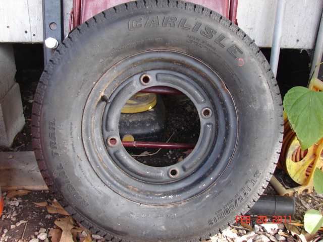

2) I already replaced old tires with new bought to match what previous owner had on it. Don 't know if he had correct load rating tires. New are C type rated at 1360 # so I guess 2 times that for 2720 #. Another oddity.

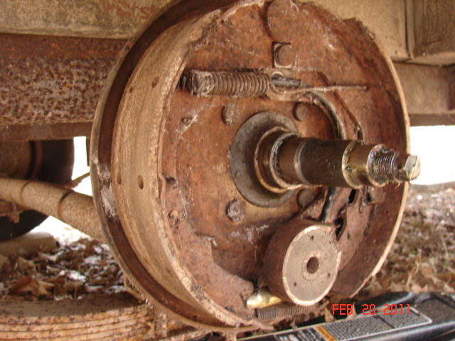

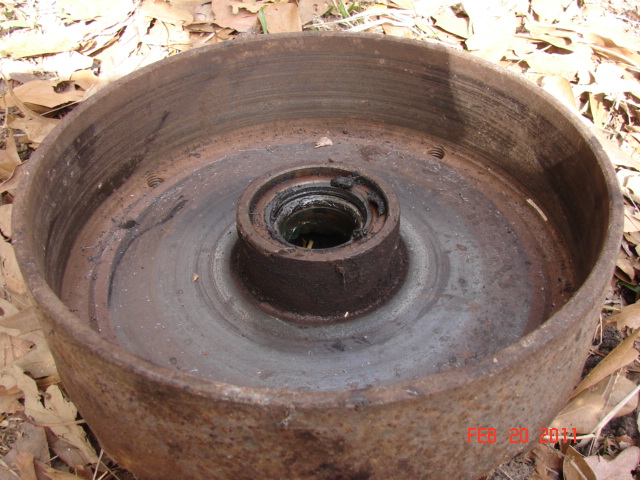

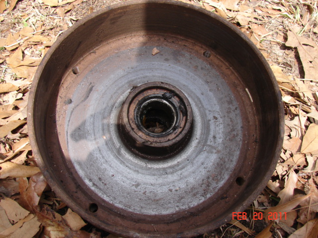

What do ya 'll think of this complete kit if I determine it will fit my axle ? I have a 2 14" dia. axle which I believe indicates a 3500# capacity.
Add Brakes to trailer Complete kit 3500 DEXTER 5x4.5 - eBay (item 270280159948 end time Mar-15-11 06:26:08 PDT)
I have used many of these kits from R and P. Good kit but I doubt you will find drums to fit them old wheels. My guess is you will end up buying new wheels also. Getting real expensive real quick.
Chris
Correct. I plan on getting new 5 bolt rims ( cheap enough ) for the tires to match the kit drums. I 'm not likin' 4 stinkin' little bolts anyway. I like the idea of kit with all I need including break away stuff. Expensive true, but I can 't afford new while payin' off my beautiful tractor :thumbsup:. I 'm also enjoyin' the leisure project requiring no dead line. Soon as I get interior more completed, I might do a little tractor/trailer campin' on my back property to shake ' er down.

If I remember right you had 13" wheels. Make sure modern wheels will fit the brake drums and also make sure you can get them in 5 lug. Most I see are 4 lug.
Chris

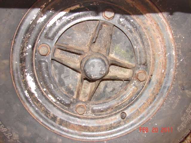

are you saying most 13" modern wheels a 4 lugs ? Shouldn 't I be able to get 13" modern wheels that fit the Dexter 5 bolt drums ?
   / Electric brake testing on old trailer #99
I am not sure. Most 13" wheels I see are 4 lug. Nothing wrong with that. I have only seen 13" wheels with disc brakes on boat trailers and with that I have only seen 2 boat trailers with 13" wheels and brakes period.
I know that 7" brakes are usually used on smaller trailers like pop up campers, ect. I have 14" wheels on one of my trailers and it has standard 3,500# Dexter Axles and 10" drum brakes and the wheel to brake drum clearance is very tight.
You need to do some more checking.
Chris

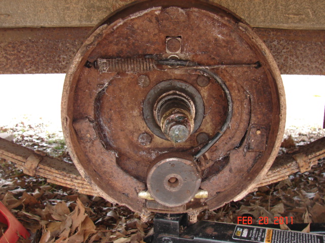

I 've found many places on net that sell 13" 5 lug rims. The original brakes ( Fayette Dayton ) have 10 " drums with 2 1/4 " width brake shoes. What am I missing about sizing them to a 10" 5 lug dexter brake drum ? Bolt pattern differences ?
I 'm also very concerned about spindle sizes and how that plays into it.
btw, today I pull back plate off one side to see if I had unfrozen the nuts. Worked liked a dream since I had soaked the with liquid wrench fro 2 weeks. Put hub, wheel, a tire back on. Got a number off of outside bearing to see if it matches the number given somewhere on the R & P carriage site. Didn 't want to remove inside seal and bearing at this point.
