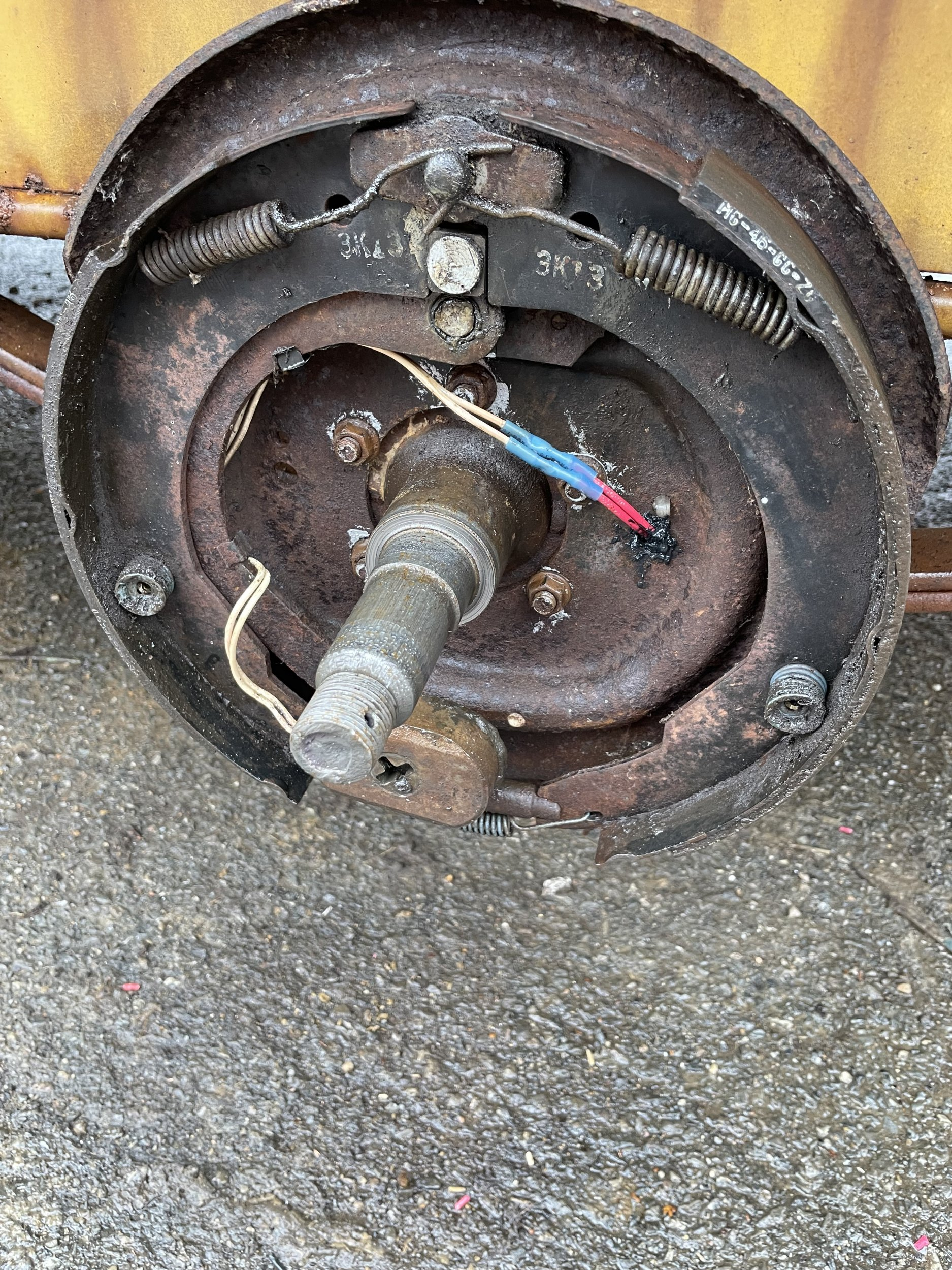

The brakes on the 10,000 lbs equipment trailer are not working. I do not use it often and the F350 dually has enough brake power when lightly loaded but would want to make it legal without a lot of expense. First problem was the connections on the wiring were twist on types or crimp types and no power to the brakes and some lights. Flipped the trailer over with the excavator and fixed all connections under the trailer with connectors with glue inside and when heated with the heatgun they seal pretty well. Now checking each wheel to see what I find. First one had broken wires inside the drum for the magnet. Spliced in some wires and tested the magnet. It works now so 3 more drums to go. IMG_0514.jpeg

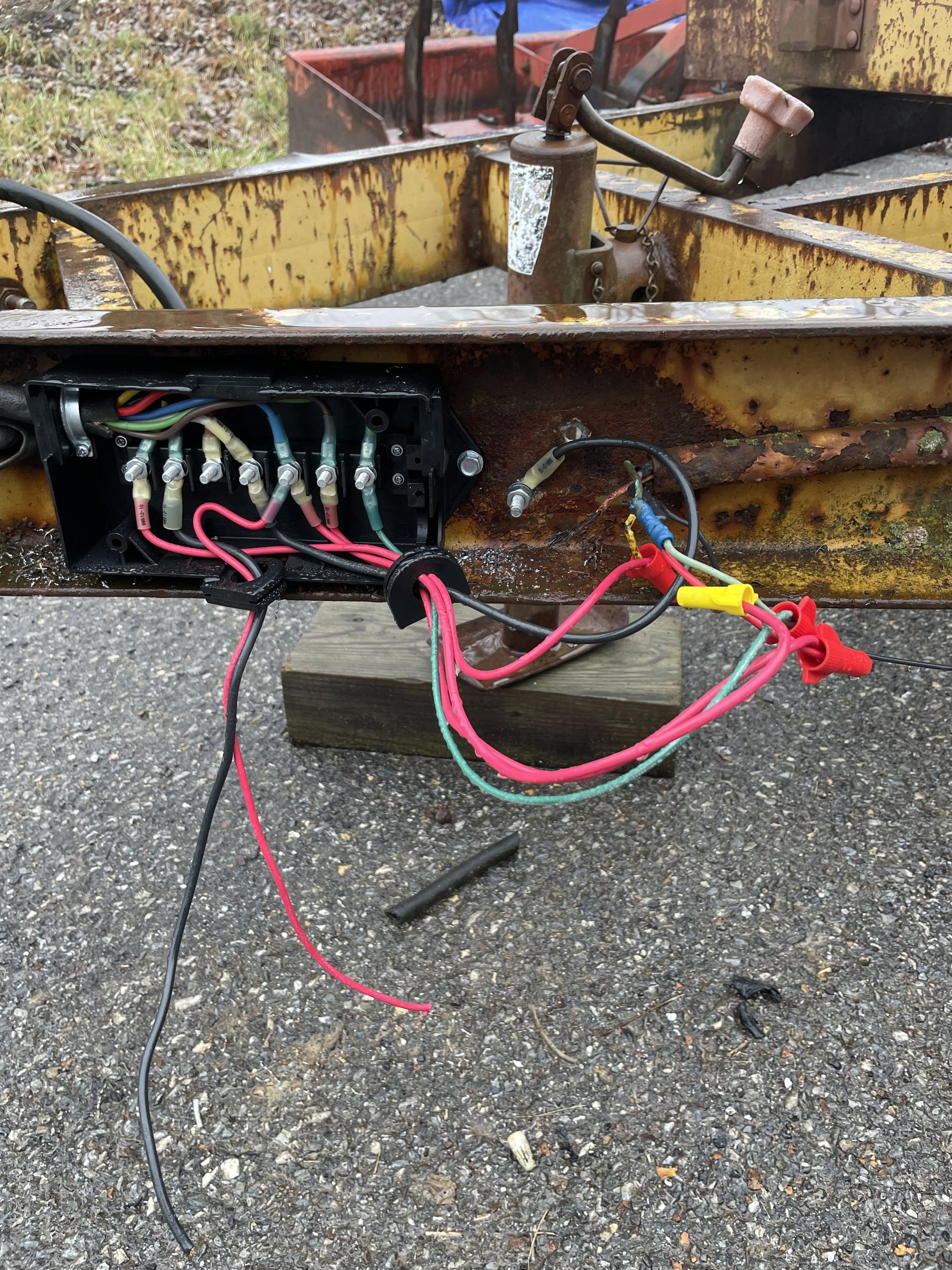

Also cleaning up the connections at the trailer hitch. Added a connector box and in the process of checking circuits

Looks like the wiring is in conduit. That is good. You are right, get rid of those twist on wire nuts. I always wanted to convert my brakes to electric-hydraulic disk. Until I found the parts were $2500.

Wiring is the most common issue with trailers and brakes/lights not working.
It's almost never the wire. It don't just fail unless it's pinched. Connections are key. And those heat-shrink butt connectors with sealer are great. You are on the right track
Wire in conduit may be good out of the rust belt. In the rust belt it's not good. The inside of the conduit will rust and chafe wires. I removed all the conduit on my car trailer and saw many chafed wires inside.
