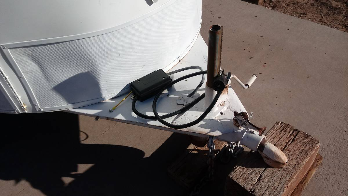

Does anyone here have any experience wiring older trailers to these newer trucks. The trailer has electric brakes. It has a round 7 point pin connector on the trailer and my truck has the spade type connector. I bought an adaptor but when I hook that up the brakes lock up when I try to move. I figured that out, it was the break away box and I went and got one of those and a new battery. Now the trailer will move but I have no lights at all on the trailer. All the wiring on the trailer and wrapped with a plastic binder and they painted over that, and I can't see what any of the colors are going to the front. It's gotta be something stewpid I just can't get my head wrapped around it.

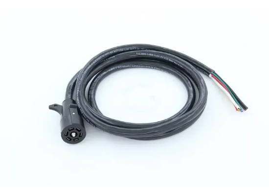

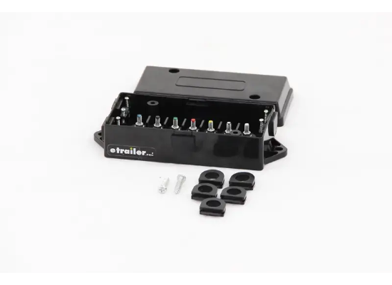

Get a 7 way molded plug cord and junction box and start from scratch.
https://www.etrailer.com/faq-wiring-7-way.aspx

View attachment 822462View attachment 822463
Thats the kit I used on my most recent trailer which was a total re-wire.
The wire color of the molded plug I got used RV-standard wire colors so my above reference is inaccurate if thats the route to go.
For for simplicity....I'd just get one of the two piece plastic replacement ends and wire on in place of the round-pin style on the trailer currently. That is assuming the rest of the wiring is okay on the trailer.

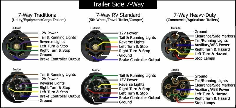

There's also a round metal "industrial" plug with different wiring.
/ equipment trailer wiring. #8
There are two different wiring standards for the 7 way flat connector and then more for the 7 pin round connector;
And we still haven't shown the various 7 pin round such as the Europeans.

Equipment standard vs RV standard are no different in plug or layout.
It is ONLY the wire color.
The truck is always gonna have the taillights at 11 o'clock and ground at 7 o'clock on the 7-way. (Most frequent ones I check)
But an equipment trailer is gonna use a brown wire for tail lights, and an RV is gonna use the green wire.
As for trucks.....I don't think they follow a standard and use their own wire colors that make no sense
