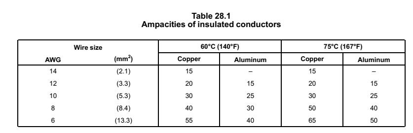

I have included a wire ampacity chart directly from UL 508A. Check the insulation and wire type on the jacket of your wire. Make sure you are using copper wire, not aluminum or copper clad aluminum. Find out the Full Load Amps of one of your brake actuators and multiply that number by the number of actuators you have. That will be your full load amps on your braking circuit. Check the insulation temp rating on your wire/cable. Most should be at least 75 Degrees C. The higher, the better. Using the chart supplied below, go into the 75 Degrees C column under Copper, and try to match your full load amp draw when all brake actuators are activated in the AWG column. I always choose my wire size by bumping the full load by 125%. That is the biggest wire size you will ever need. Anything larger is just a waste of money. Running the short distance of the trailer bed to the axles is not a long enough distance to get a voltage drop from wire resistance, provided you use the proper gauge wire for your load.
As other posters have said, make sure your brake actuator wiring circuit is wired parallel, not in series. Do ensure you have an excellent ground for every actuator, and an excellent ground for the ground pin on the seven pin plug, both on the trailer and the truck. Do not rely on the ball on the hitch to make the ground connection from your trailer to your truck. That may sound funny, but I have seen many trailer electrical issues through the years where people were relying knowingly, or unknowingly, on the hitch ball connection for the ground circuit and then couldn't figure out why nothing work properly 100% of the time.
