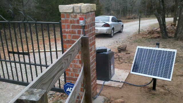

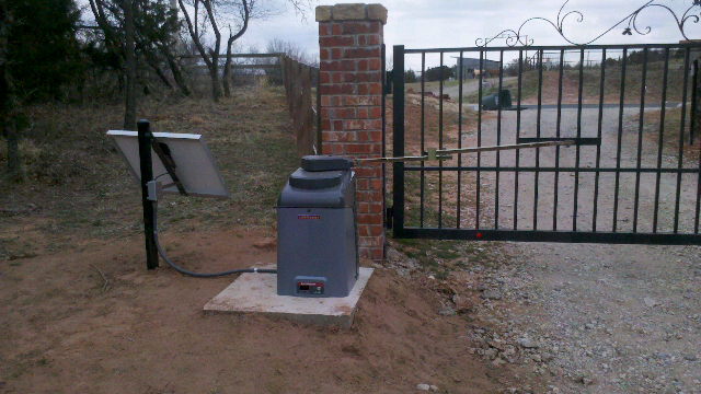

We put in an Elite opener by Liftmaster with a solar setup. Keypad on the outside & inside. We have trees surrounding our driveway and had to run the wire to the solar panel about 50' away after we found the initial setup didnt get enough light to fully charge. This one has 2 batteries and the scissor arm action. The code for the local city requires 15' and a Knox lock for emergency personnel. Here's a few pics of the initial setup.
