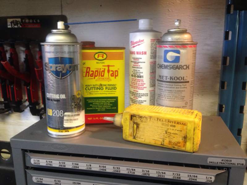

I use these:
The Chemsearch Met-Kool is my favorite.
Terry

/ Drill Bits - Need some help and advice #83
I have never been a fan of WD40 at least in mild steel. Last night drilling into 3/16in plate with 5/8in twist bit again reminded me that it doesn't do good for me. Need to get more cutting oil.
/ Drill Bits - Need some help and advice #84
For any thing over 1/2 inch, I usually drill a pilot hole first. I usually just try to match the pilot bit with the width of where the drill flutes come together on the bigger bit. I dont get carried away with trying to match exactly, if it looks close, it probably will work just fine. I dont like drilling out bigger holes using several bits to enlarge the hole a little bit at a time as it seems to always ruin the next larger size bit by leaving a grove or chip in the cutting face. I bought a set of consolidated toledo (sp) drill bits a few years back. I have probably drilled a couple of hundred 1/2in holes with the same drill bit and havent had to sharpen it yet.

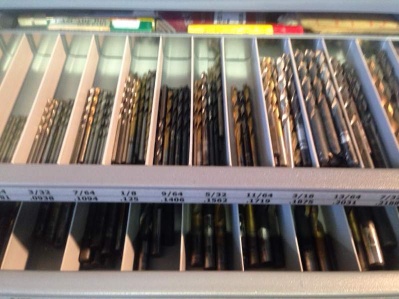

/ Drill Bits - Need some help and advice #91
Nice set. Mine is just about that full.
I would like to get the letter and number dispensers too, but hard to justify as I only use a hand full of those. Most commonly #3, #7, F, and O.
Most of my stock has came from the various places I have worked over the last 10 years. Factories don't believe in resharpening or even reusing bits under 1/2". So even if a bit was used 1 time to drill for 10 seconds in aluminum, it seems taboo to put it back instead of toss it out. Makes for a nice home collection over the years.
/ Drill Bits - Need some help and advice #92
Much better. It is not that I have so many drill bits, it is that I need to spend less time looking for the one I want. Still have metric, number and letter size but those are easier to keep track of.
/ Drill Bits - Need some help and advice #93
Nice to be organized. :)
Terry
/ Drill Bits - Need some help and advice #95
Show off! Nicely done though.
