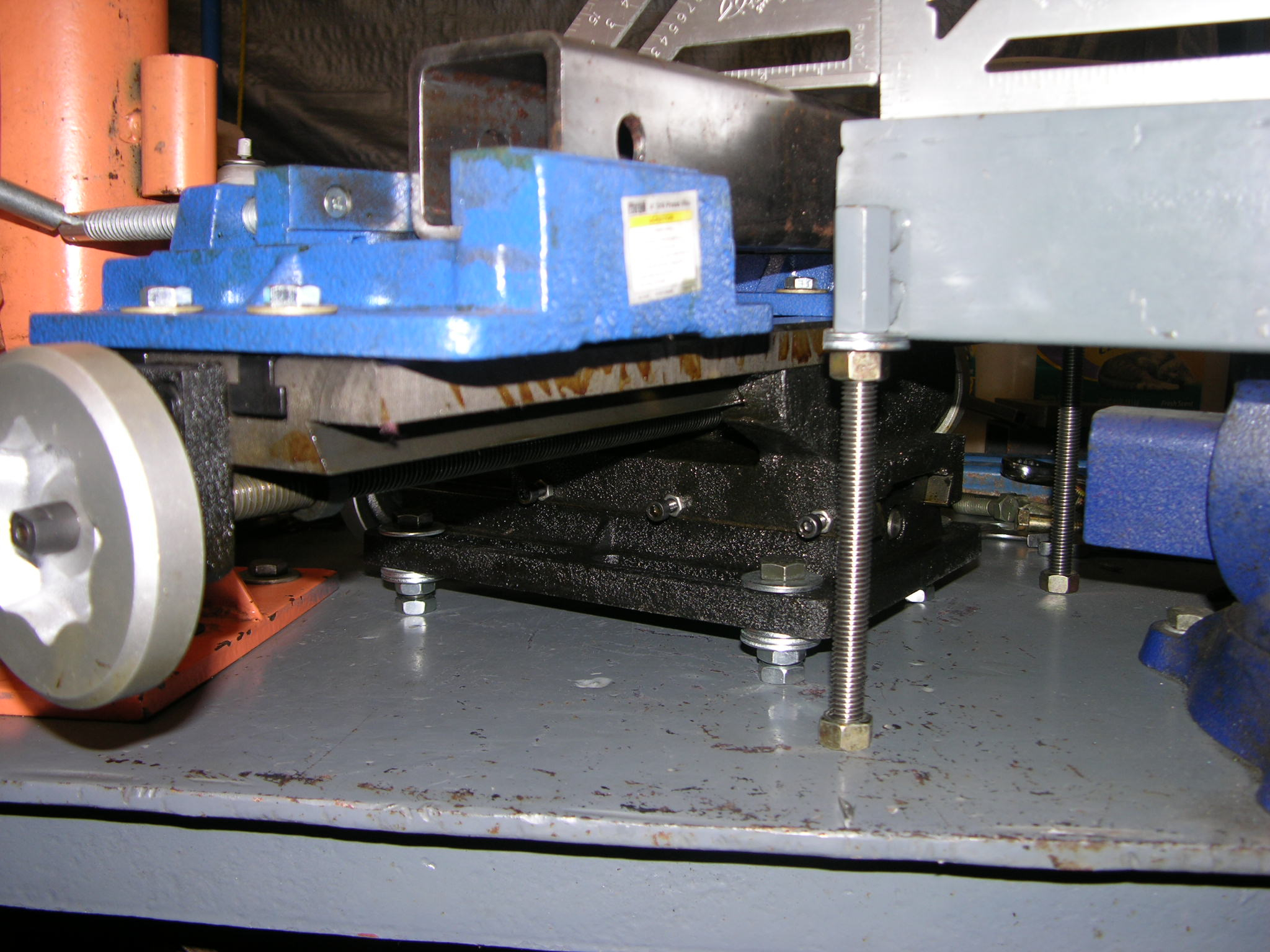

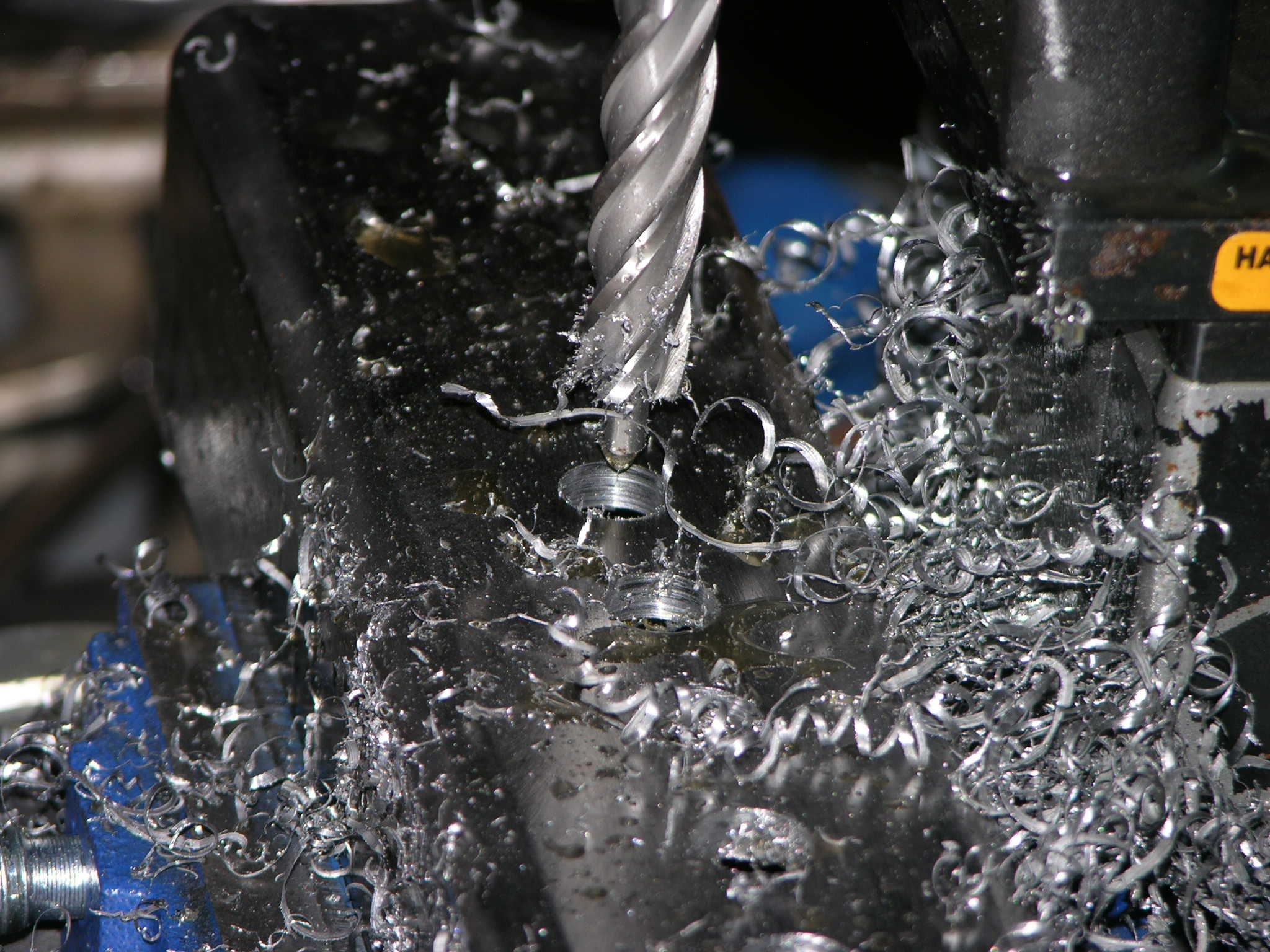

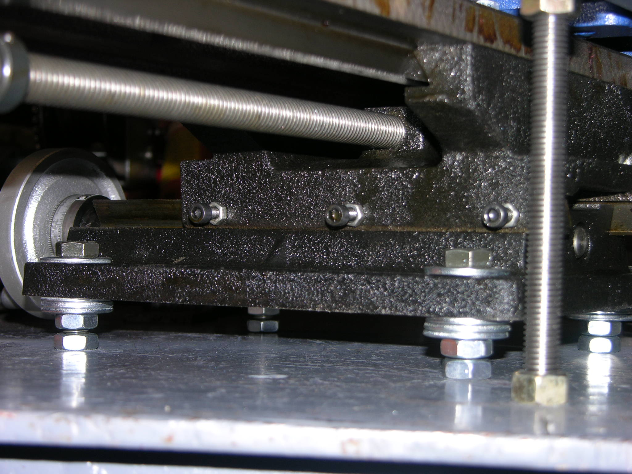

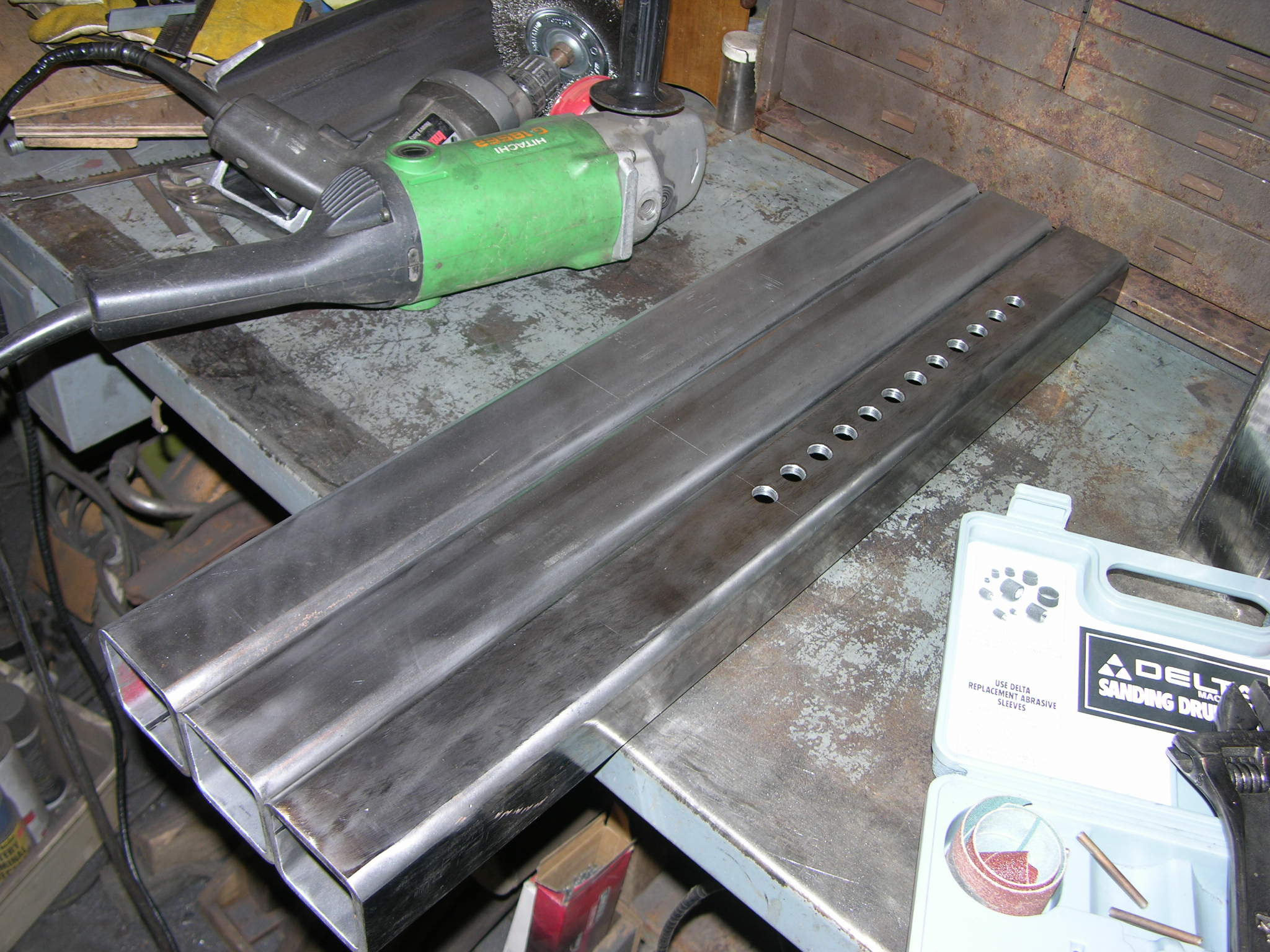

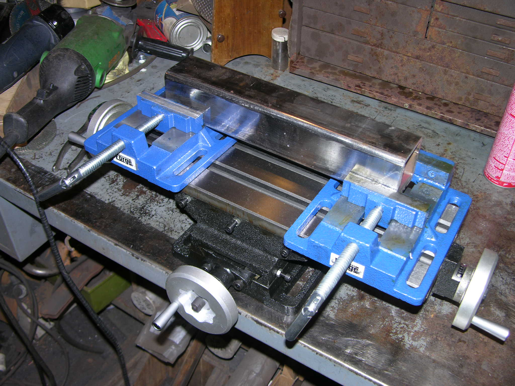

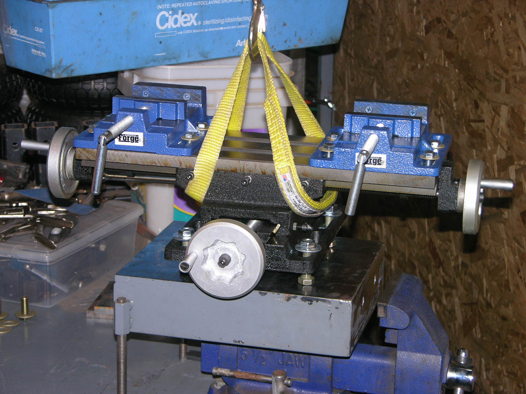

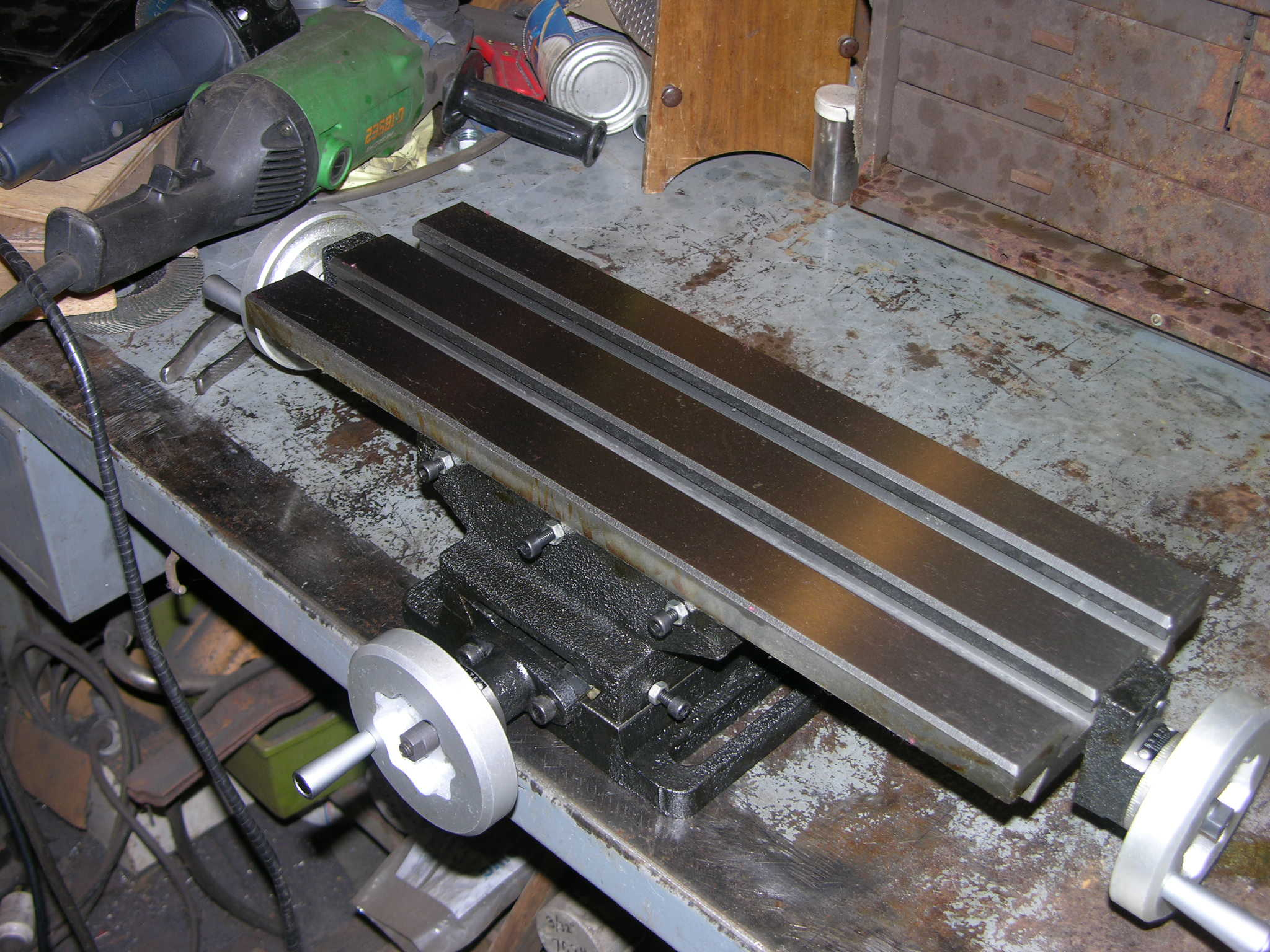

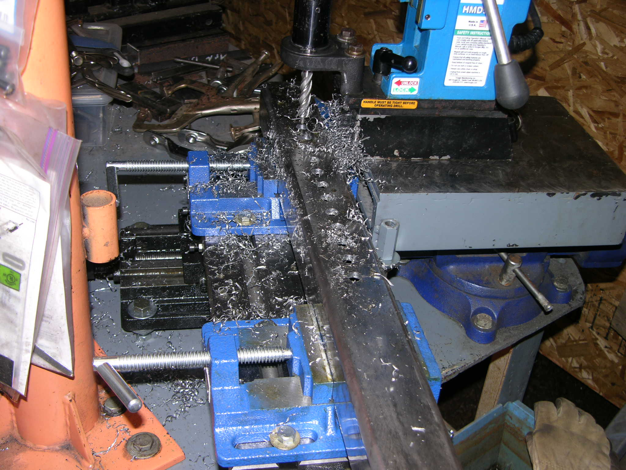

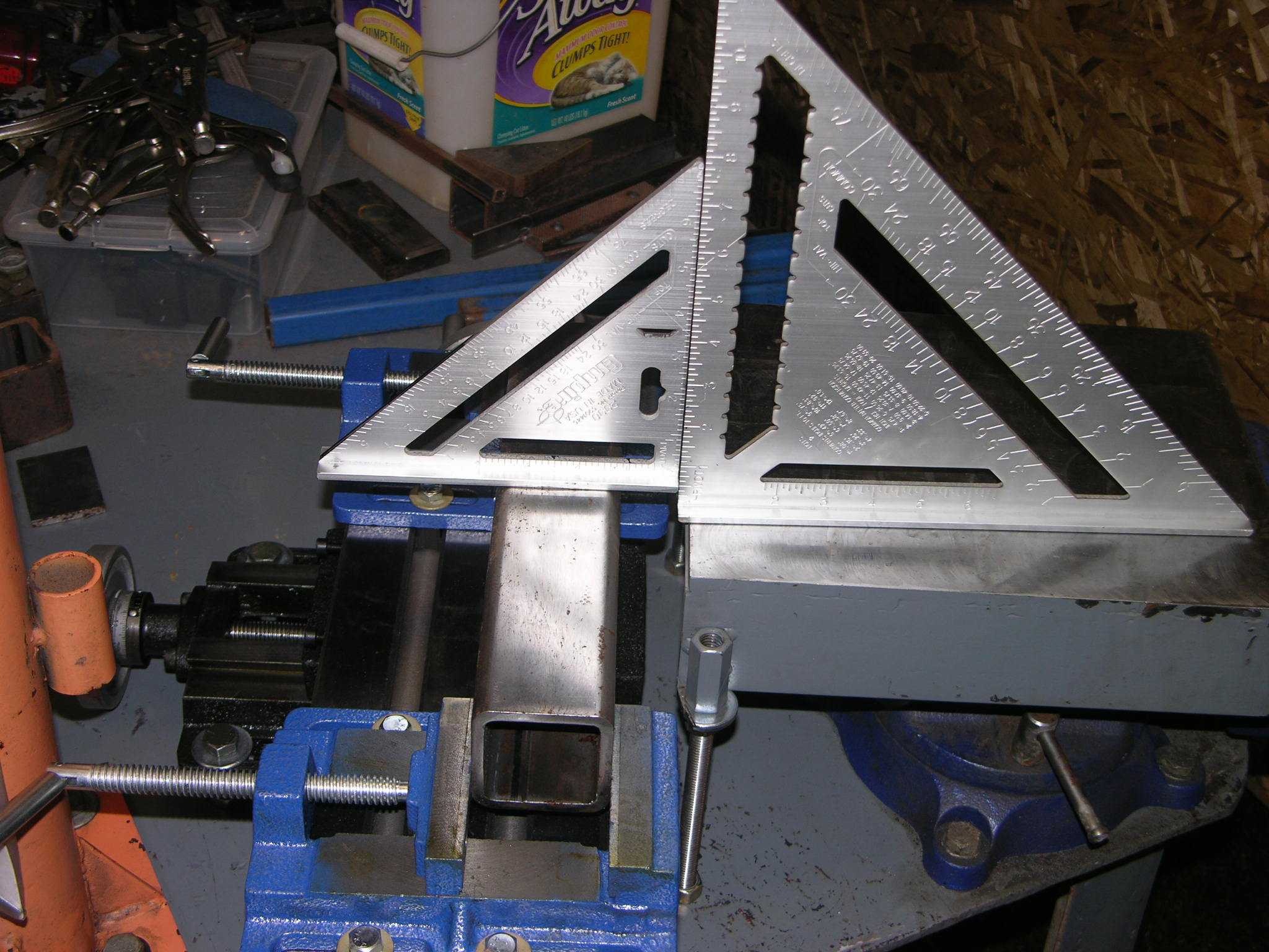

I have this one
Grizzly.com xy table - mine
But I bought mine about 20 years ago; at that time, IIRC it was made in Taiwan. Current ones are Chinese (and about $90 more expensive).
I thought it was too big for my DP, so it sat in its box under a bench for about 12 years, then finally found a home in my "MDVT" project, along with 3 different vises and a "mini" jib crane - "MDVT" stands for "Mag Drill Vise Table" - original, huh?
Been awhile since I used the MDVT, but the table's lead screws are ALSO either 8 or 10 TPI, forget which - still very useful for "semi-precision" hole placement - a few pics... Steve

/ Drill Press Cross-Feed Table #37
