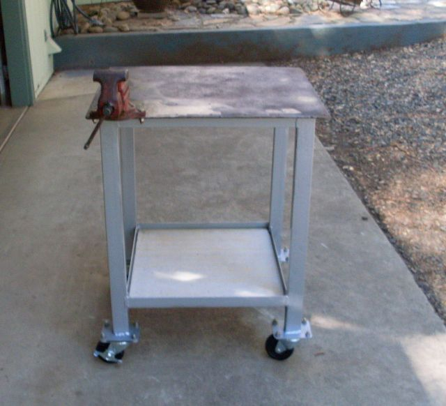

Well after several false starts and road blocks I have a welding table...
A while back I acquired a piece of 1/4 inch plate that measures 26X28 inches....A while after I got a set of casters from local tractor supply... Some time has gone by...
A few days ago I went to local metal supplier and was going to price out some 1-1/2 X 1-1/2 inch tube and to my surprise $159 for a 20ft. length and I need 30ft. .... Dream of finishing table sort of went "poof"...
Came home and rooted around in scrap pile and came up with 4 sets of angle iron bed rail two sets at 1-1/2 X 2 inch and two sets of 1-1/2 X 1-1/2 inch (knew I grabbed them out of neighbors "free" offering for some unknow reason at the time), Well the 1-1/2 X 2 inch ended up being cut and welded together to create a tube for legs and other lengths of bed rail uses to form frame to hold it all together....
Lot of hours of measuring and cutting and welding I have a sort of table.... Top has been drilled with 1/8 inch pilot holes on a 4x4 inch grid to be late drilled to 3/8 inch for setting up fixtures, jigs and what knots... Vice was something found shoved back deep in some dark shelf..
Bottom tray is a section of 1/4 cement board left over from some home repairs ... Table is not complete as it needs a bar to hang clamps from and a few odds & ends.... But it very workable as it is... Probably will add a few tweaks at later date....
Yes its sort of a light weight as tables go but its for small home shop, so its adequate for my needs...

Skip the holes. tack your pilots back shut.

You will use it for a lot of stuff, spill anything, dirt, its all thru the holes and to tell the truth all that stuff looks better than it works, really, makes for nice pictures but I like commom clamps, like being able to wipe it up.

That's about the size of the first one I built but yours looks much nicer. And you even painted it, WOW.

I hate rust....But not to point a item has to be hospital sterile... All the salvaged materials were of different colors....

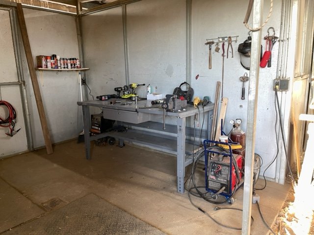

Like most you all I used saw horses, inverted trash cans, or the floor to weld on for years. I too finally got a table and more importantly a station for welding projects. This 12x12 area was a horse wash rack in the barn. Now I just need to put up some shelves, lights and wall hooks to bring it together. Found this all metal packing table on CL. Added a drawer and an old Craftsman vise.
