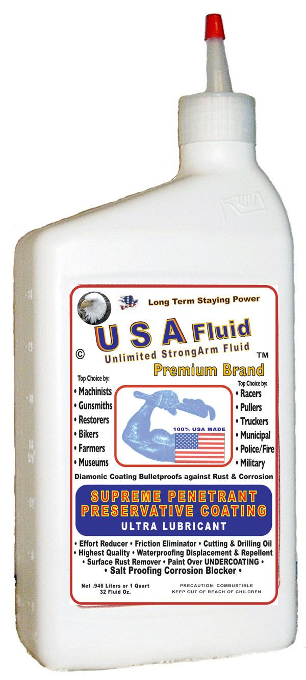

Ok, heres what I went with, I found that I had a quart of this on the shelf. I would use it on my farm implements and they still look kinda new, so I figure why not on the table.
This stuff really works, I go over my 10' bush hog every 3 months with it and it keeps it from rusting and brings out the color real nice.
Their website is a kinda old school, but that's OK, most of here are old anyway!
