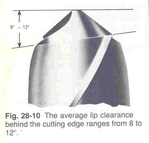

One other thing. Standard drill points are 118 degrees nothing else. If it 135 degrees or something else it's not standard. Later.
True. Drills specifically made for stainless steel f ex have 135 degrees. Dormer A108 is one.
