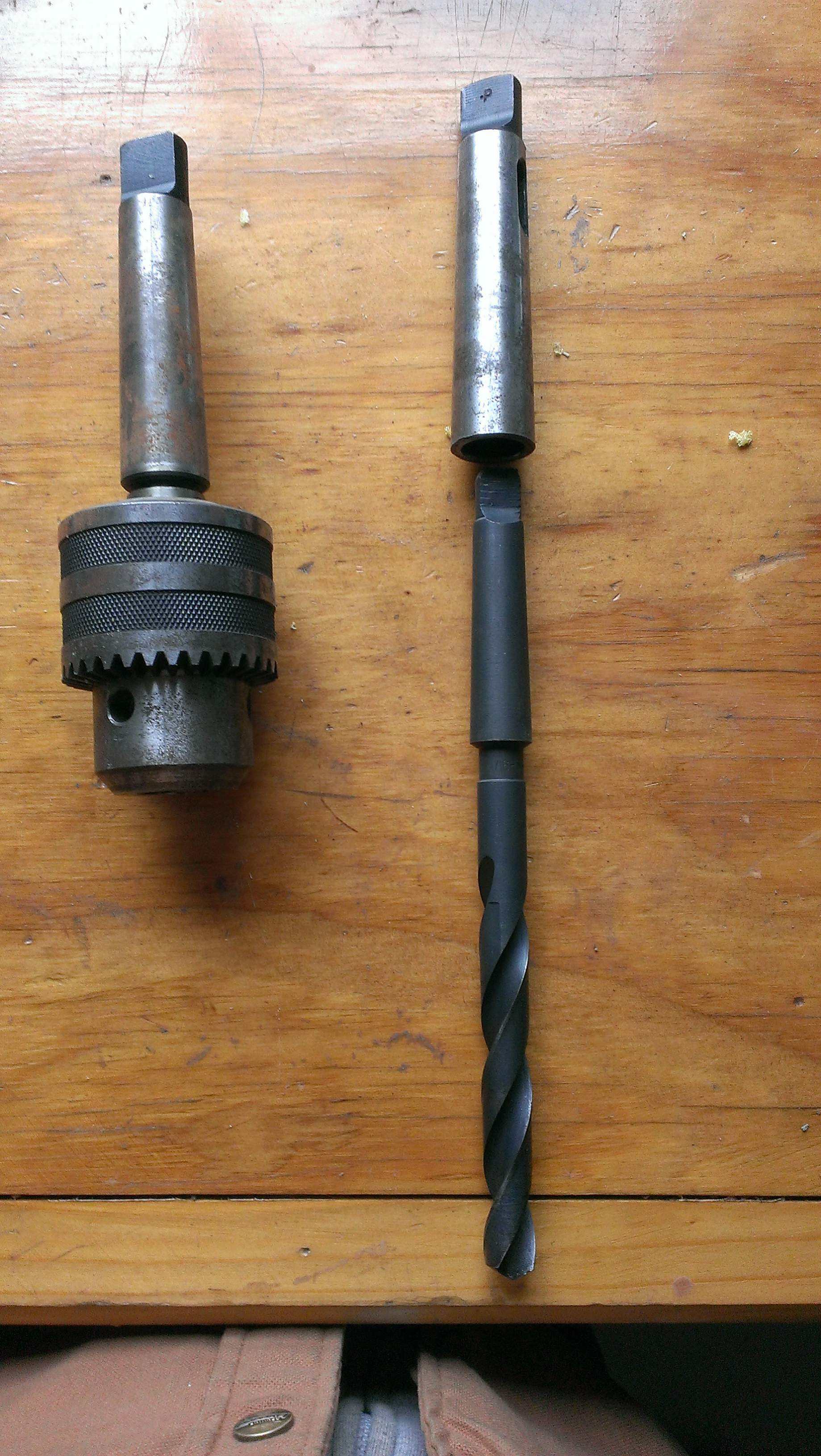

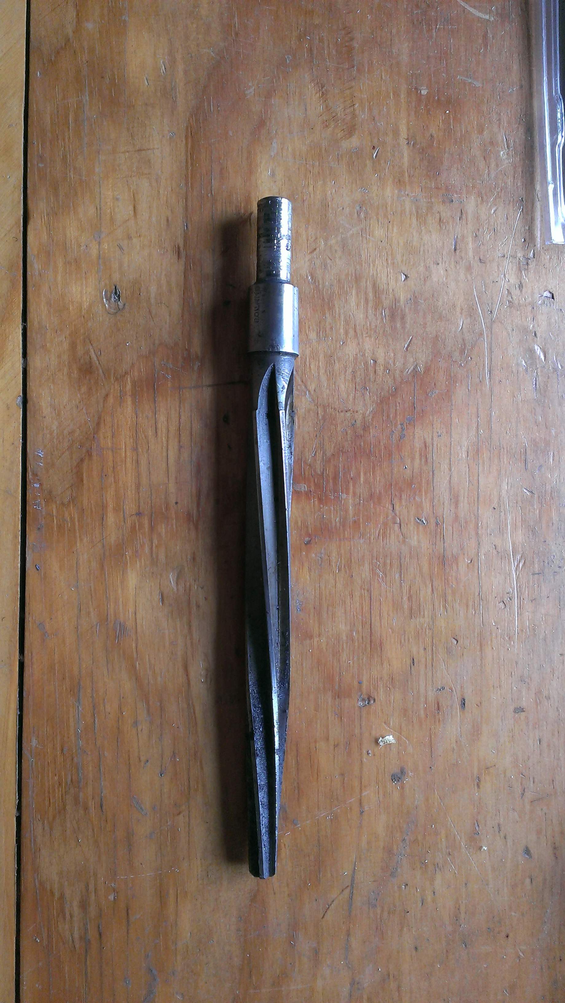

Here is what I am talking about on the reamer.
Technically it is a bridge reamer, I start out with 3/8 hole and run it through to the 5/8. Works slick for drilling frame rails!
https://www.mscdirect.com/product/d...adTerm=0236040&typahddsp=02360402&hdrsrh=true here is the link it started out with MT2 tapper straight shank, they want to much. Then I remove the drill chuck from the drill press, and adapt to the MT3 tapper. bit the bullet go from 1/2 to 1" by 16ths.
