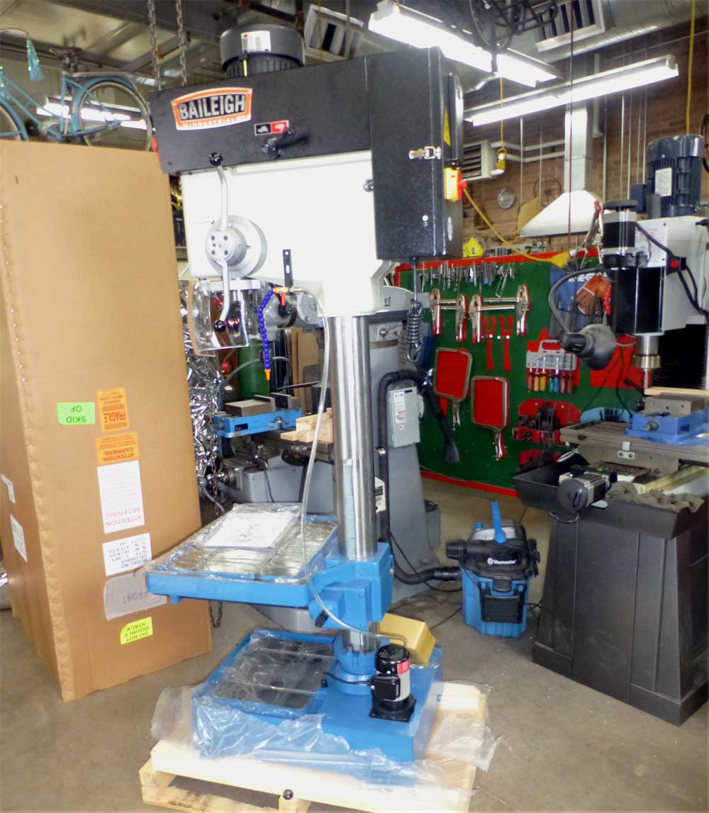

I bought a smaller version of the Baleigh. It is gear driven with at least 4 speeds. It fits all the things you are looking for. I think I paid $1200 for it when I bought it. New. Sometimes I wish I would have gone with the infinte variable speed and an oiler but it does everything I need and more. I really like it. My buddy had one of the big milling machine vices he was replacing that I picked up for $50.
