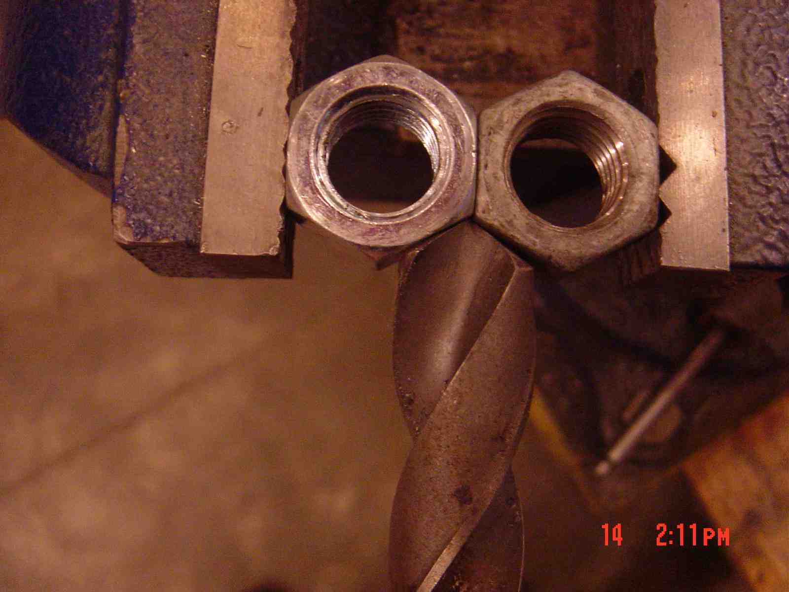

Here is a cheap and easy way to check the proper angle of a drill bit. Most of us here have two of these. :D
Ha ha... Pretty close with that shop tool... only 2 degrees off. :D Can't say I have ever measured anything with my nuts though.
Yeah nobody will know the units but you can usually count with them. For example the number of degrees off. Or you could count the number of people who know the angle is wrong.
Typically I measure the degrees by the size of the nuts.
