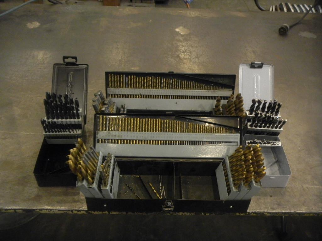

Maybe not the advice you are looking for, but I buy Harbor Freight bits and just keep sharpening them with my Drill Doctor. They cut well with adequate lubrication and can be resharpened almost infinitely. When I get up to 5/8" or larger, I forget about drill bits and go with bi-metal hole saws.

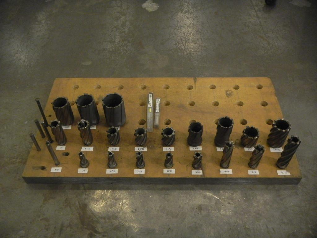

I do the same thing as KennyG, except I sharpen by hand. Also when drilling larger holes that are not going to be tapped, I use rota broaches.

Carl, if you were going to do a LOT of tapped holes Evolution has annular cutters in tap sizes down to 1/2" - I bought one for 3/4"-10, not 'cause I'm gonna tap that size but because it's a perfect size for receiver hitch pins, just a bit of slop - 21/32".

While annular cutters are great for bigger holes, they are very temperamental about side loading and very few drill presses for under $1000 are rigid enough NOT to break them. At prices from about $25 each up to several hundred$, they hold up a BUNCH longer when used with either a mag drill or a milling machine. Because they don't drill out all the metal but just a "fat hole saw" donut, they are several times as fast as large drill bits.
There are separate speed charts just for annular cutters. The biggest mistake made with these is NOT pushing them - you want a bit of color on the chips or you're not pushing hard enough. Too light a touch and you'll work harden the material and take the temper out of the cutter. $$$
