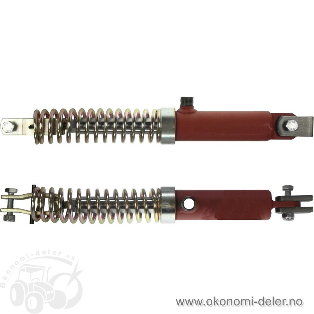

/ DIY logging winch build #192
This type from a hydraulic trailer brake sould work on a winch, its quite small

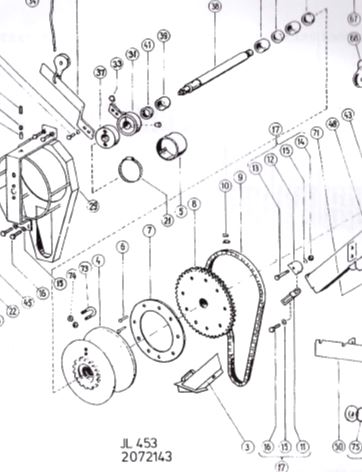

I was cleaning out my files this AM and came across the manual for the Farmi winch I owned briefly. I don't know if the enclosed parts diagram is any use to you.
The problem with pneumatics is that you'd need an air supply and you'd also have icing issues with the time of year we're usually cutting/logging.
Hydraulics have more control (no sponginess in engagement), and are more maintenance free on small sealed systems.
/ DIY logging winch build #197
Yes, and those cylinders are very suitable for this task.
Truck air systems are under 175psi, while the Wallenstein hydraulic remote system uses 800psi on a 2" cylinder (to retract the rod to engage, so the weak side - but still).
/ DIY logging winch build #200
Truck air systems 120psi ,safety on the air tank blows off at 150psi
